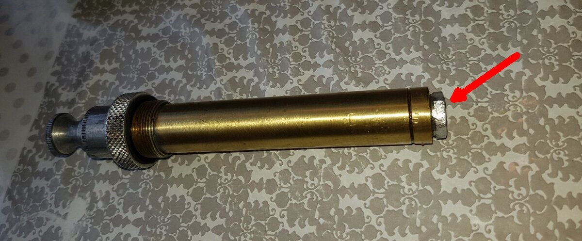

    The pump nut on my Tilley x264b seems to be unbelievably stuck.
    It's this nut, the one from the valve:
    I've tried holding the pump with water pump pliers (pipe wrench?), I had it in a vice with nylon vice jaw liners, adding extra rubber liner for grip, even had a pneumatic impact gun on it...
    But the pump body keeps slipping. And of course you can't really crank down on the pumpbody as it will damage/deform then. There are already some marks on it, but it's still very round on the inside.
    Obviously this is way past handtight...
    Is there a trick to it? In the past I've refurbished the pump from a x264a, but that nut just screwed off by hand (but that's a slightly different design).
    The rubber pad inside is still functional and slightly rubbery, althoug it's harder than a fresh one..
    If I heat it up or solder a bracket onto the pump for better grip in the vice, I'll destroy the rubber that's inside now for sure, and then the nut has to come off.
    I wonder how it got so stuck. U don't see any signs of that someone might have put epoxy or something on the threads. Also the lamp was pretty much unfettled with when I bought it.
    The only think I can think of is that somehow maybe galvanic corrosion has set in. But the lamp itself (and inside of the tank etc) is in really good nick, not much corrosion anywhere. And a surrounding covered in petroleum is not a typical surrounding for galvanic corrosion of course.
    Has anyone dealt with this before and found a way to solve this?

    What if you wrap the end of the pump tube in wet kitchen roll
    The warm the bottom nut with blowlamp see if the heat loosens it a bit.
    Hold the pump tube in some sort of sandpaper to get more grip
    Few ideas to try
    Cheers pete

    I already had it in boiling water, but that made no difference.
    Normally if you want to overcome the bond of epoxy, loctite, or worse, galvanic corrosion, it has to be heated up much higher (like 200C and beyond), and that'll destroy the rubber seal inside. Similar to using stuff like acetone.
    But maybe I'll make a custom vise liner from a block of wood, drilling a hole in it same diameter as the pump tube and split that in half to clamp in the vise. That way there is much less chance of deforming the pump tube.
    I might line that round hole with some very fine emery cloth (360grid or so) glued into place for extra grip :thumbup:

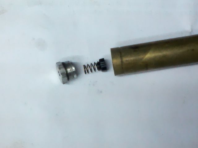

    This is what it is supposed to look like when removed:-
    Picture 'stolen' from Jeremy's post.
    If you decide to unscrew it later, remember not to use any lye(sodium hydroxide). It'll eat up the aluminium.

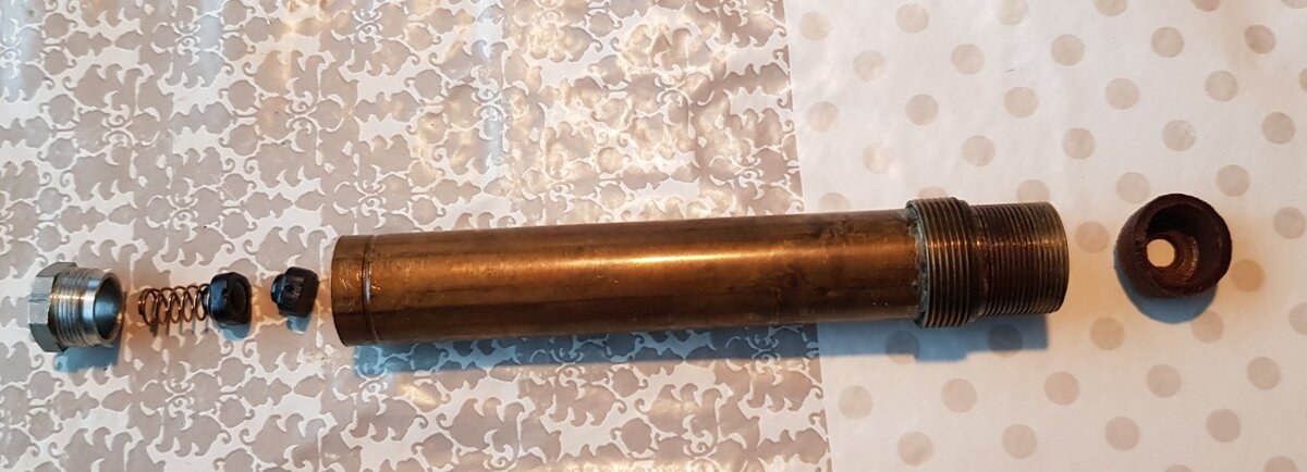

    Update:
    Look what @Ron M gave to me :mrgreen::thumbup:
    A fresh pumptube with a nut that came loose! (and fresh seal/leather)
    He also had a few with stuck nuts, so these nuts getting stuck seems to be a somewhat structural issue. I think if you have such a pump it's wise to loosen and tighten (not too tight) the nut annually or so, checking on moisure or corrosion.
