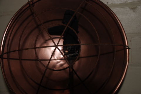

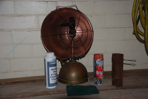

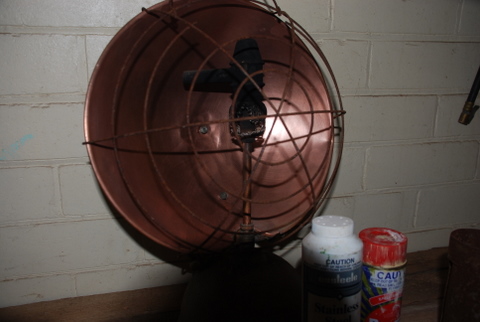

  8. Woolbay
    Jan 18, 2011
    32
    Some photos
    The photos don't not really show it ... but
    I've cleaned the bowl with Copper/Stainless cleaner which is what I use to clean my copper based saucepans in the kitchen. It did a stirling job, a few minutes rubbing with a paste made from the powder using a nulon scouring pad and it became very clean. A quick polish with the brasso and it looked like a beautiful golden globe.
    Now to get a new mantle, de-rust the guard and draught protector, fix a leak in the font and then swap out the vapouriser and it should work
    Paul
