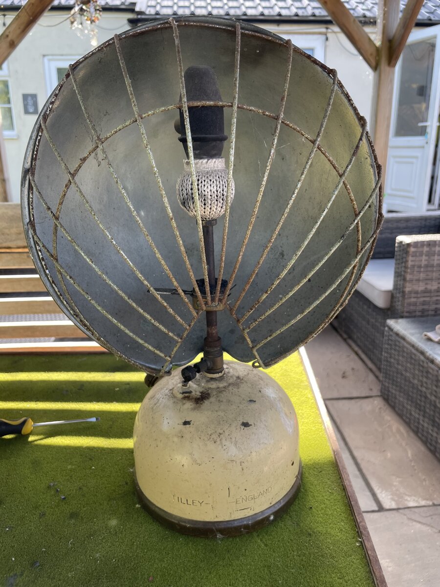

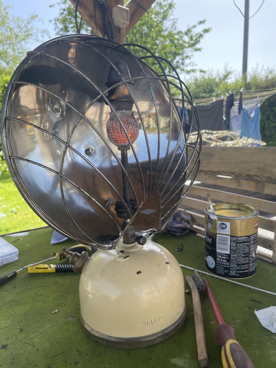

    Picked this up today ,my first heater.
    It belonged to the late father of an old neighbour of ours who used to work with my wife’s Father
    We moved 10yrs ago , it was a chance FB market place listing
    I thought it was an R1 , but I’m told by those that know it’s a rarer RH57
    So far it’s had clean up , a light recommissioning, builds pressure but burns yellow on ignition , so it’s going to get a full strip down to see if I can get it serviceable

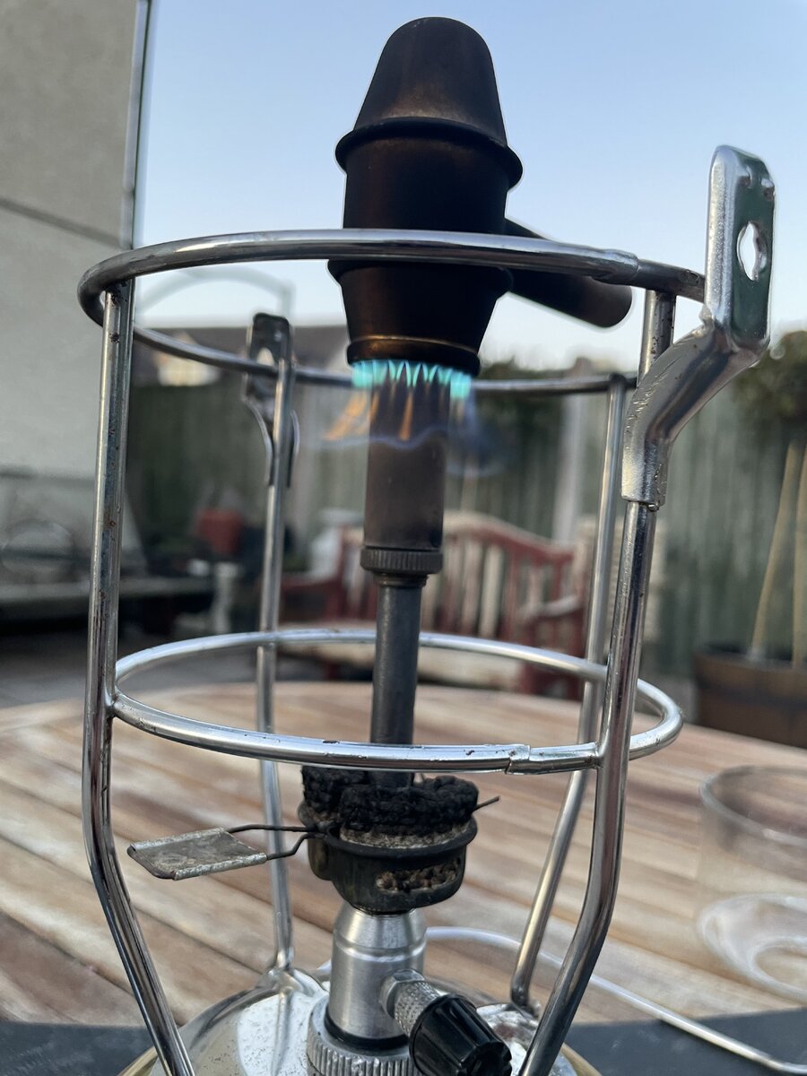

    Thanks Robbo , I’m having issues
    The vaporiser seems to be scrap , the tube rotates on the spigot
    So I put the burner on a 246B, got good Bunsen flames
    However when I add the mantle , it’s fireball
    Probably a good idea to get a modern wire mantle too

    Can you silver solder the original vapouriser ?
    I doubt very much that adding the mantle caused the fireball !
    My personal experience with modern repro wire mantles available in the U.K. is they're crap ! I've had two, the first one didn't even last one winter, pathetic! The second one did but it didn't last two winters, very disappointing. I did manage to get one from Tailand or South Korea, I can't remember which and I can't remember the seller either but the mantle's still going strong after six or so years. So, if you can't get a genuine N.O.S. Tilley 1126 and can't find a foreign one, stick with the asbestos mantle. You'll not be disappointed.

    Silver solder is an option , hopefully get time tomorrow Henry , but I need a couple of 169’s anyway , so on the scout for them for a PL53 and a spare
    Great info on the mantle
    Maybe I’m not getting the preheater heat into the burner with the mantle in place ?

    A bit of a mystery with the flare-up, the clean flames on your test burn without a mantle are a classic example of what one is looking for. I wonder; was there any wind when you tried it with the mantle on? It really doesn't take much more than a breath to send the heat from the meths torch away from the top of the vapouriser and burner.
    Tilley made a draught shield to contain the heat when pre-heating their radiators in less than ideal circumstances, if you don't have one, use the search function to find examples of home-made ones.

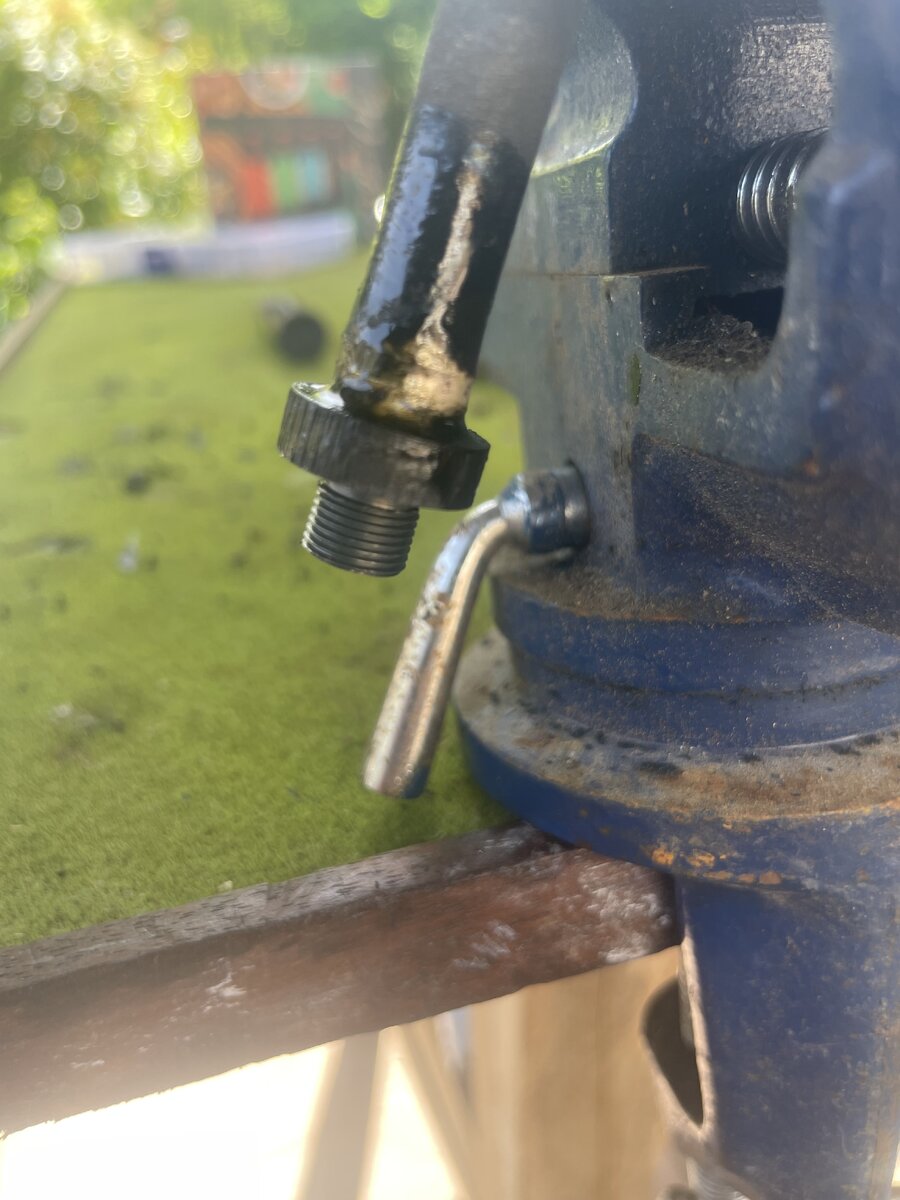

    @Henry Plews
    Silver solder , I thought I’d fix the one for my knuckle burner whilst I was at it

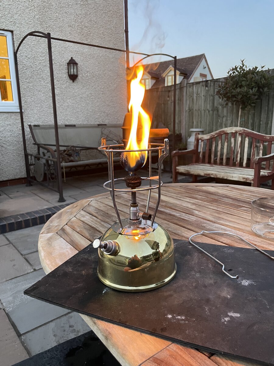

    We have lift off
    Now to let it cool and add the reflector

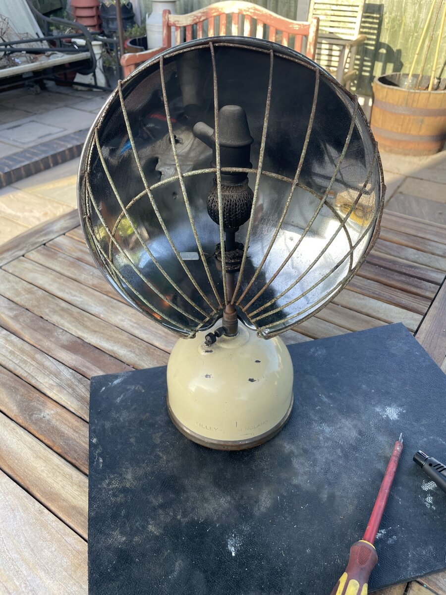

    All back up together

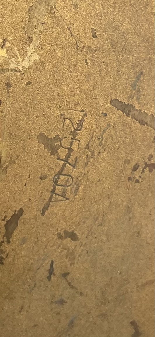

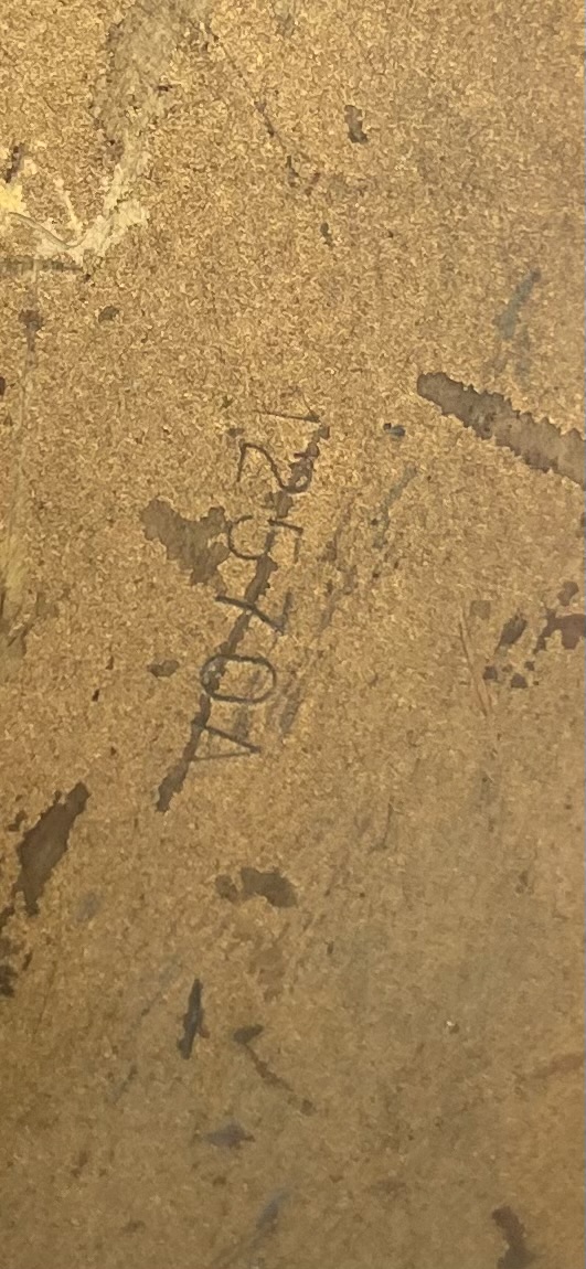

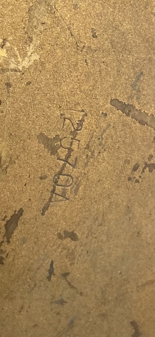

    Date stamp is 12570A so a December 1957 example
  12. hamid1
    Sep 29, 2023
    11
    Buckinghamshire, England
    Great work - you got it going pretty quickly and even managed to salvage the broken vapouriser.
    Did the flare-up occur simply because the burner wasn't pre-heated enough? I've found the radiators are tricky to light, especially outdoors. My method is to light the attached wick first, let it burn down then use a torch from a Tilley lamp to continue heating the burner. After about 4-5 minutes it should be hot enough to ignite without a flare-up.

    Yes I think it’s the preheat and being an asbestos wick not a wire one , I think it’s worse
    2 pre heaters or a blast with a blow lamp , both have worked for a clean ignition
