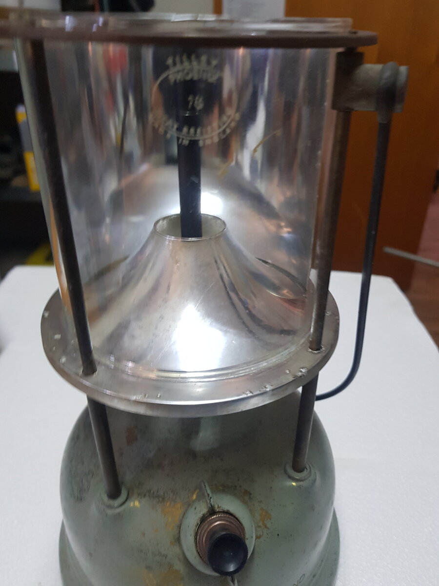

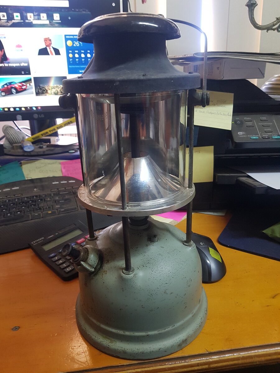

    Duck egg colour, has reflector on the globe

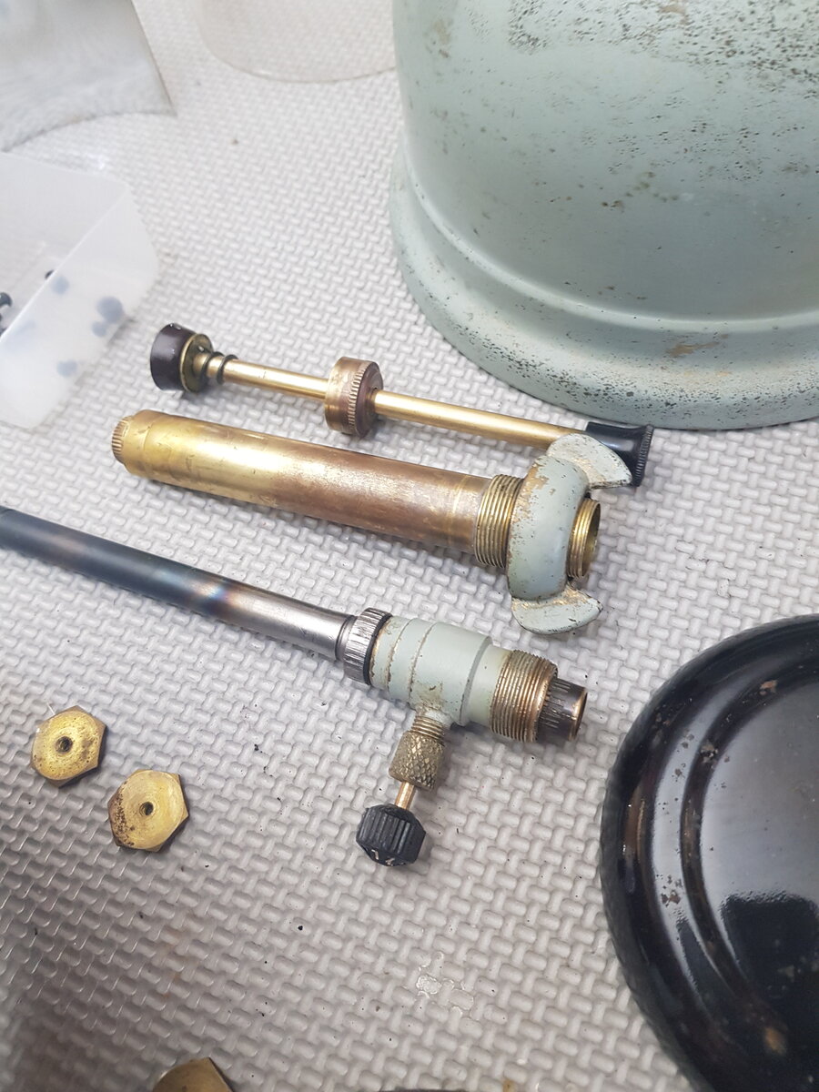

    This is my Rijkswaterstaat Tilley.

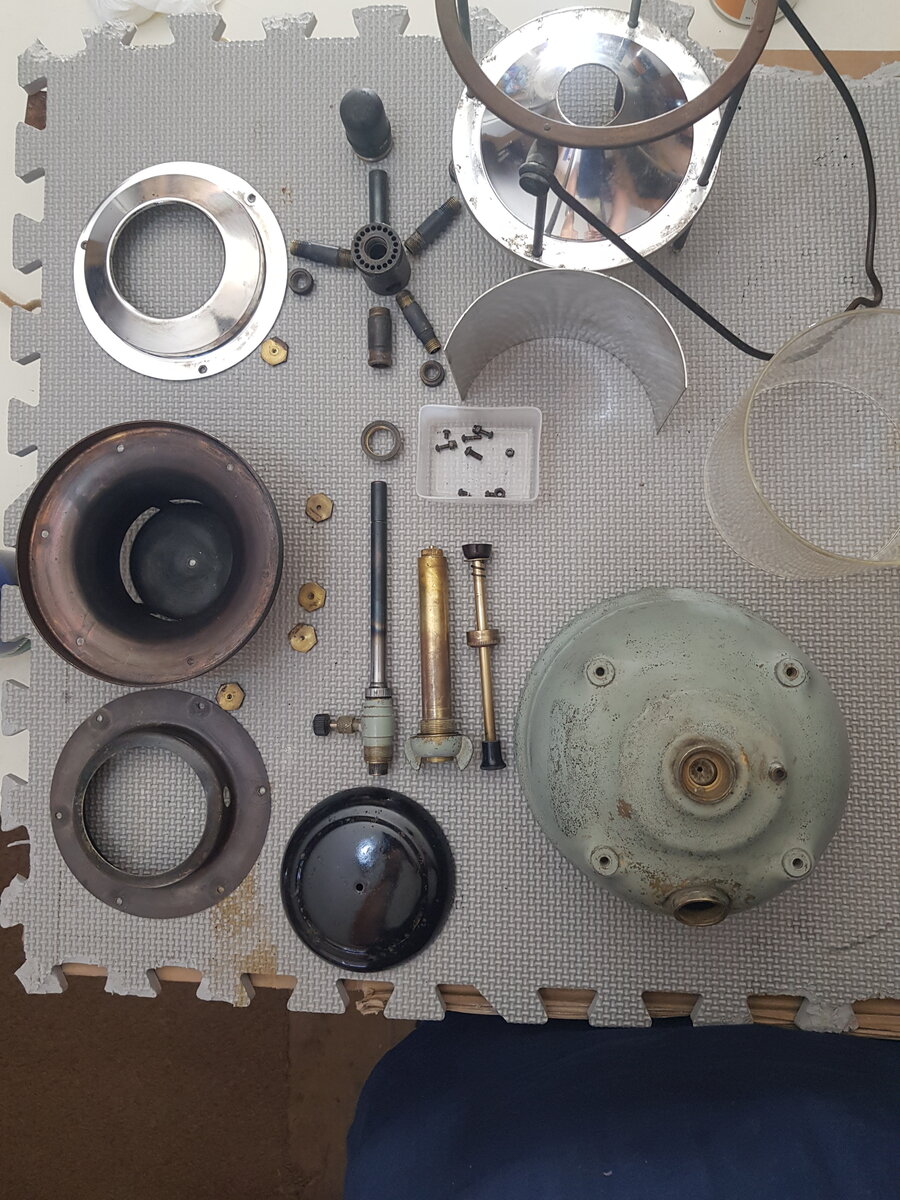

    As original as i could, gave it a warm soapy bath to get the grime etc off, have not polished anything, the reflector coating is delicate as is the duck egg paint job.
    It is similar to the x246, font only the frame support legs screw into the font like the early pork pie, the air intake is improved on than the original SDR. It was an easy fettle, as all it needed was a new 606 vaporisor and new seals all around, pump cup.

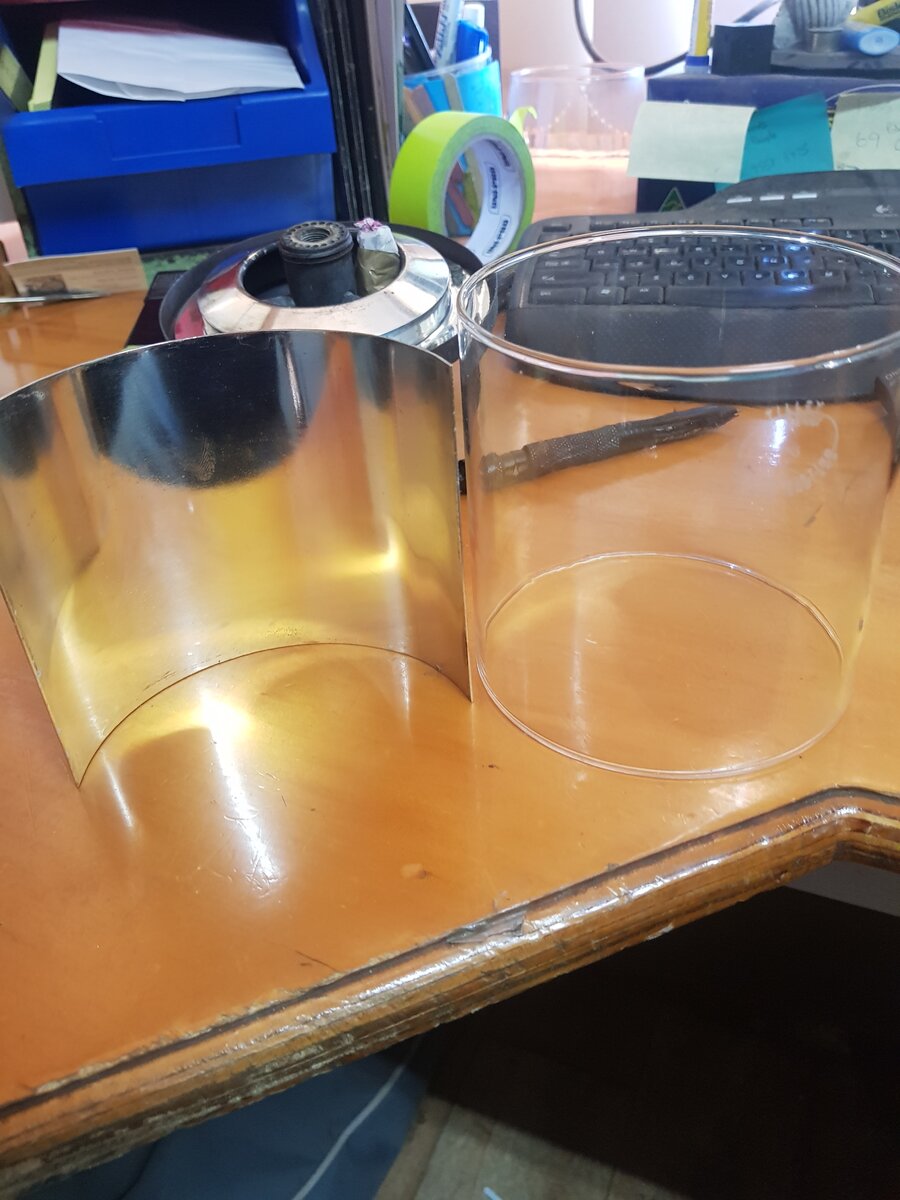

    It has a reflector that is the same arc as the globe and is about 1/3 of the circumfrence. It is removable.

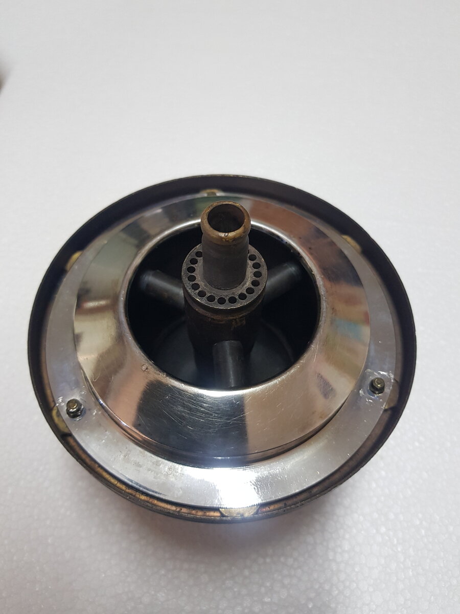

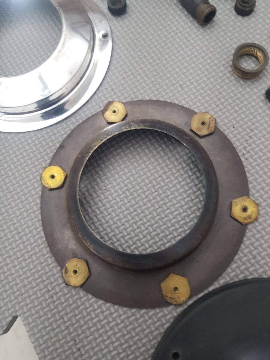

    The air intake is more improved as from what i had read about the SDR was lacking and fellas had improved the air intake by putting in spacer washes. The Rijkswaterstaat has purpose made spacers , a hex shape around 12mm by 1.5mm thick that fitted snug inside the burner lid.
    I broke it all down cleaned it and layed it all out to show. 20210121_083655.jpg

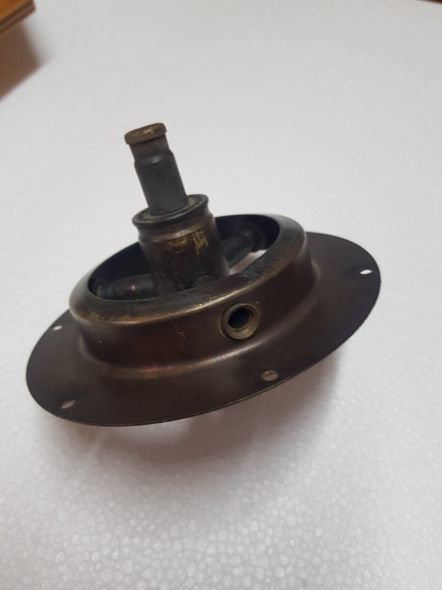

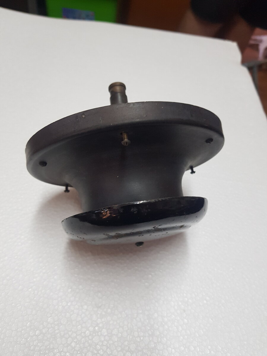

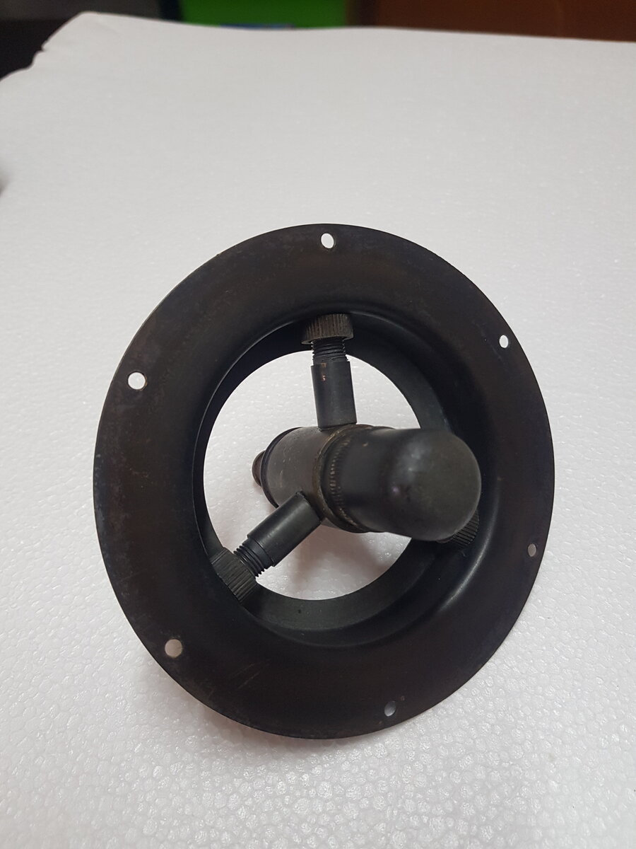

    The burner head assembly.
    Showing the small screws that held the hood to the burner with 3 of the spacers

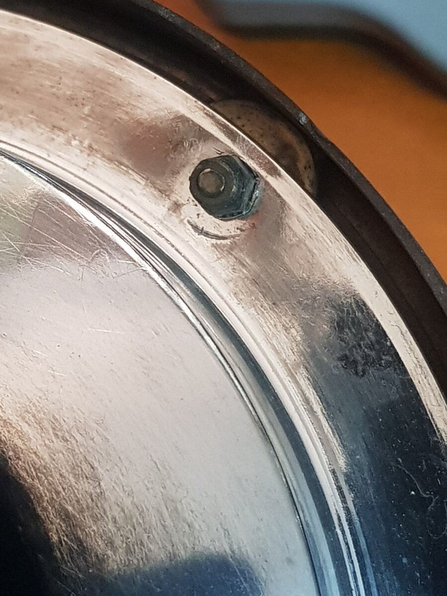

    The reflector is held on screw throgh the lid, burner, spacer then reflectot, 3 places

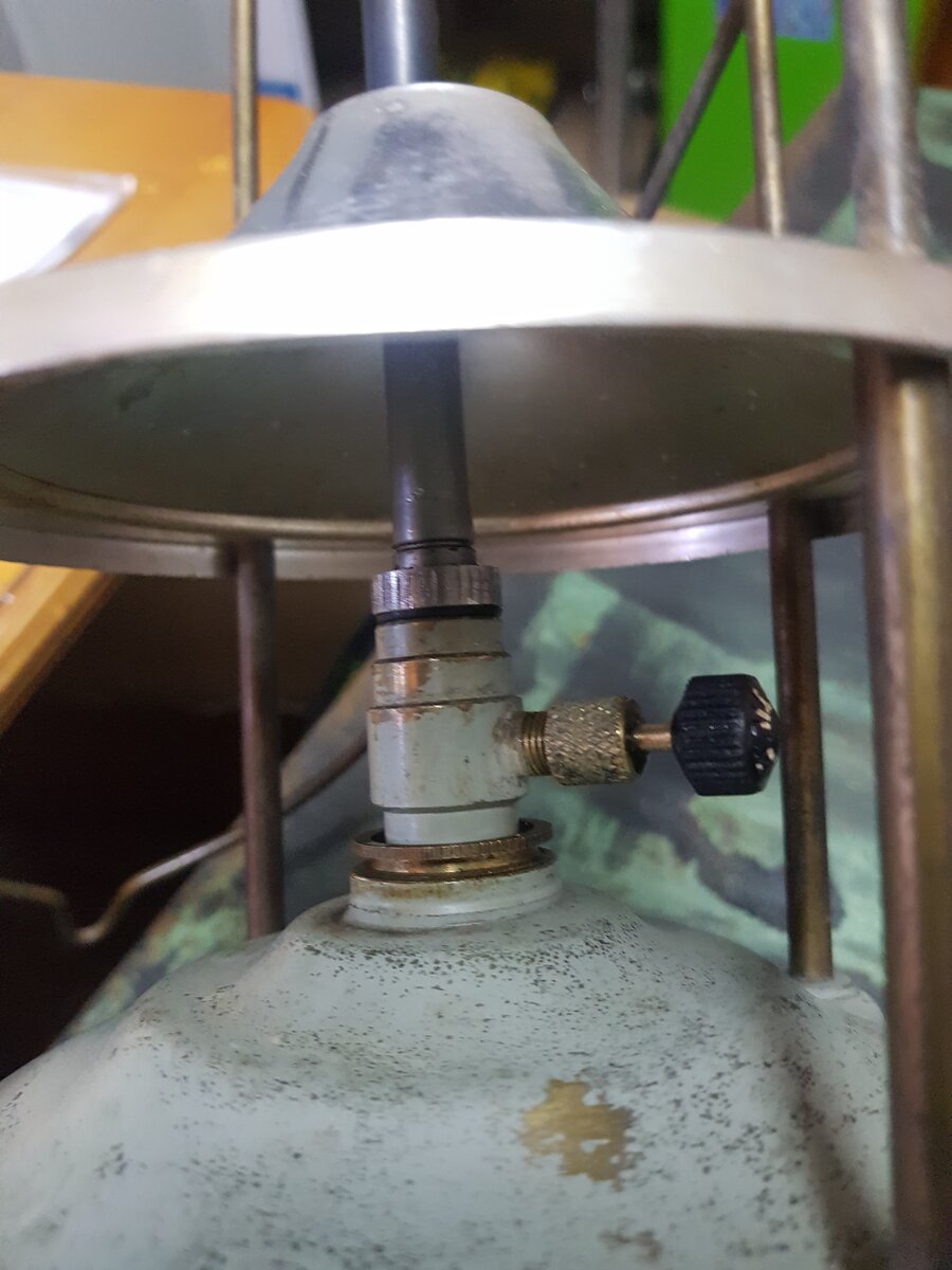

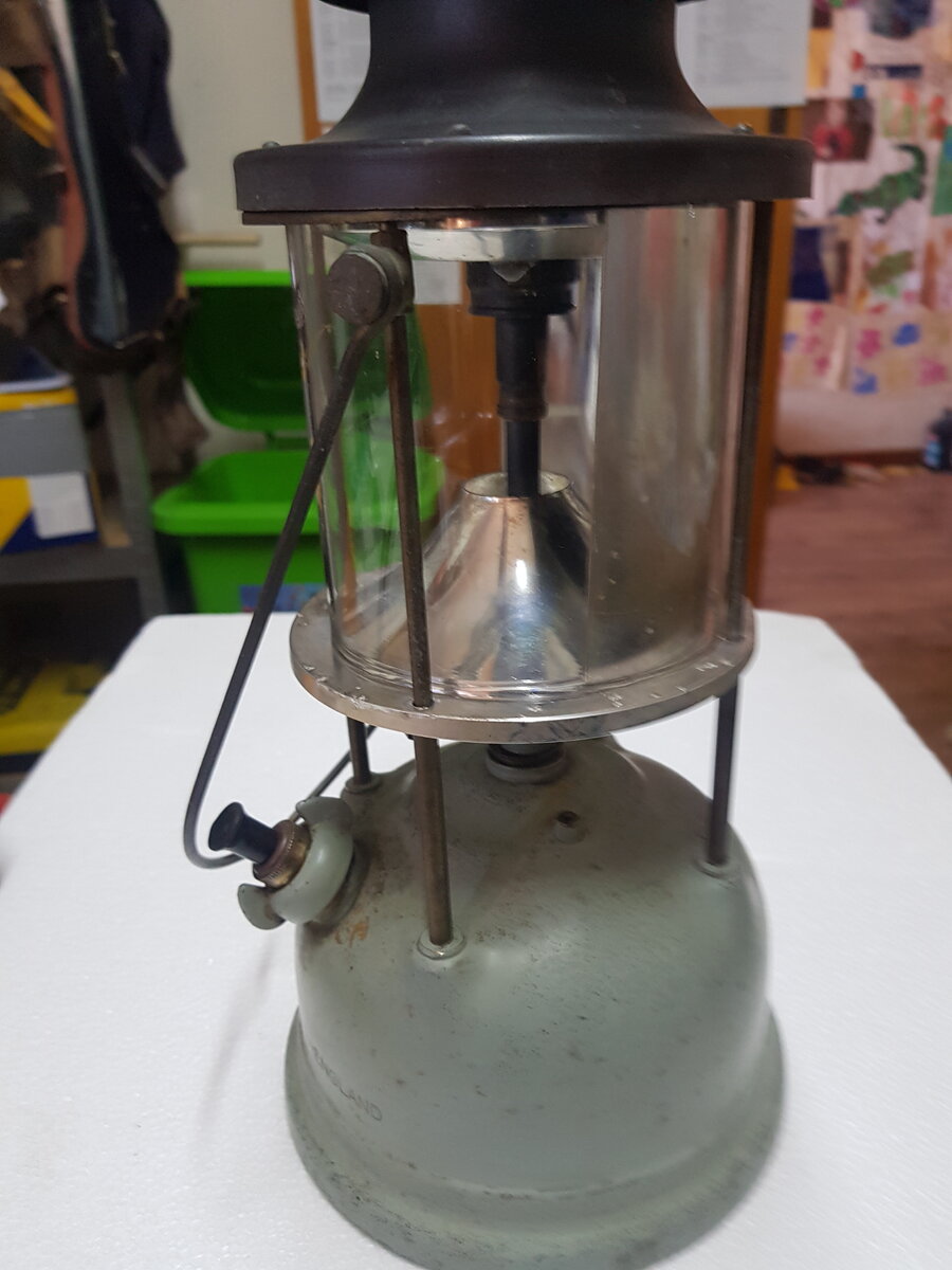

    The frame screwed to the font easily, the cock valve also paited duck egg.
    The globe with the reflector

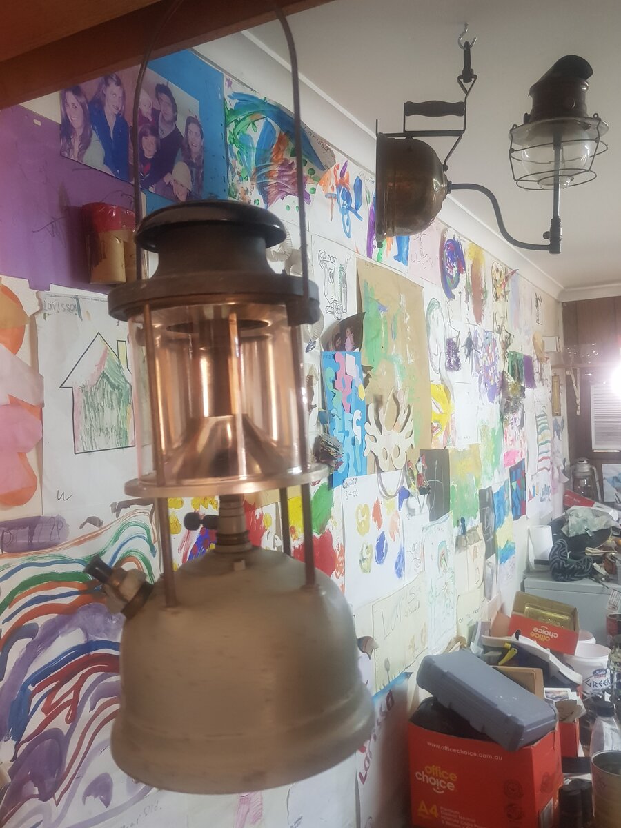

    The re assembled lantern

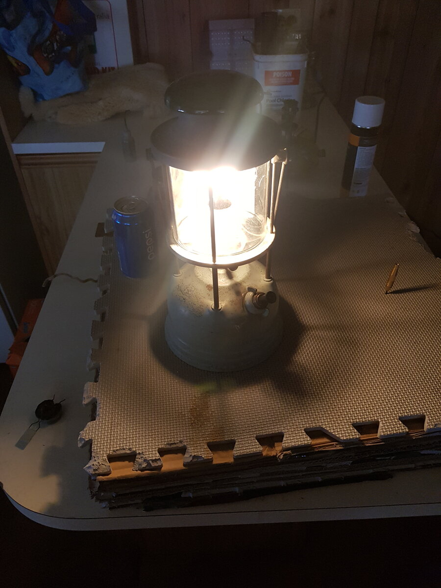

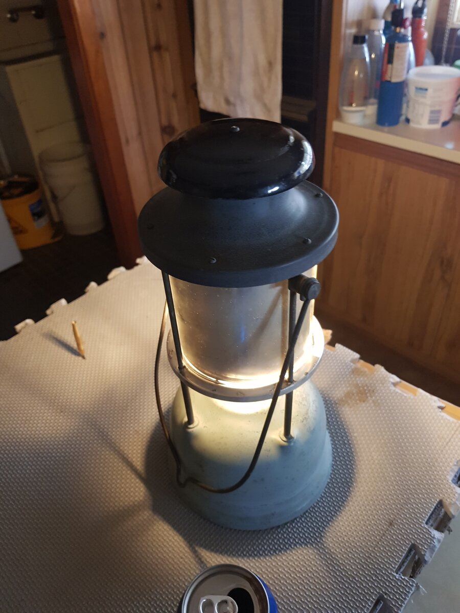

    And now the money shot.
    It fired up easily
    View from behind the reflector.
    Very cool very pleased.
    I hope you all enjoy such unique lantern as much as i do.
    PS. I know nothing about its history.
    Its the first time its been alight in donkeys years.

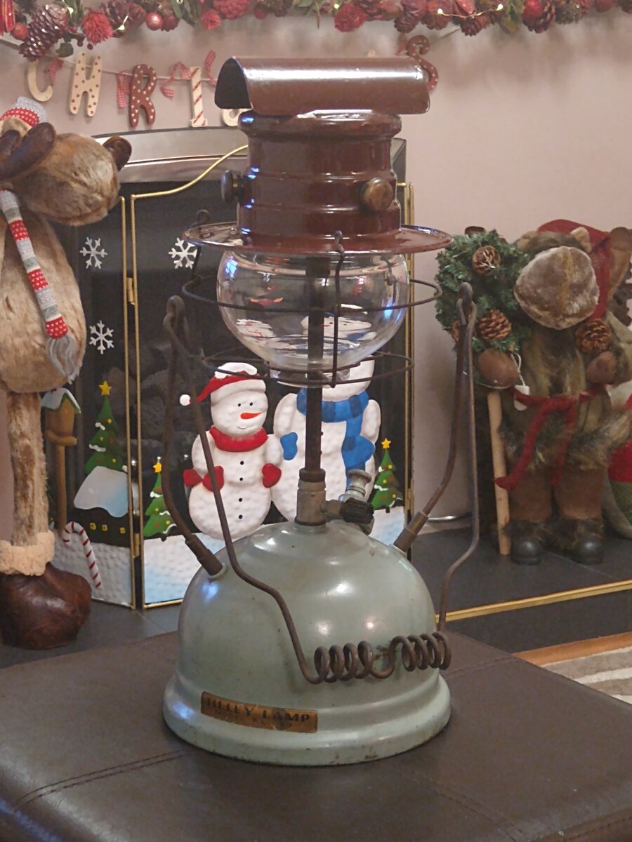

    The shade of Blue on tank I think could be be of Air force origin.
  21. paparazi
    Oct 23, 2016
    434
    Nottingham UK
    The same colour me thinks..I've not seen it on anything else?
