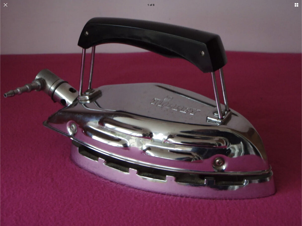

  9. Sedgman
    403
    Wimmera, Victoria
    Is the attached really a Tilley Model R450?
    I am familiar with the 250 models and the DN6 but unsure of this or whether it is the one you are looking for @Anthony

  11. Sedgman
    403
    Wimmera, Victoria
    Yep, that's for sure. But not from eBay. I have just come in after trying to fix a spigot on a burner and measuring some Tilley parts and spotted Matty's post. So I thought I will google search and was really surprised and thought maybe that's the one you are looking for, though it's not steam. So not from eBay just the google search of images.
    It looks Tilley to me.
    Regards

  14. Mackburner
    6,364
    Matt has copied the article to me now and it's definite enough but the numbers don't work and I don't believe it.
    The DN250 runs 4 hours on a 1/3 pint of kero and weighs 5lb 4oz filled.
    This steam iron article states 4 hours on a pint of kero and weight 5lbs filled with kero and water. That is a bigger burner than the Tilley stove which runs 4 hours on a pint and a half. Add to that a water tank and you would have to have a pair of tanks about twice the size of the one in DN250 which totals near 4 times the liquid capacity and weight of the DN250 tank plus a heavier burner and two vapourisers to run a burner and a steam generator/boiler. All that in a unit 4oz lighter than a fully loaded DN250?
    The image of "Tilley R450" does have the style of a Tilley but I would suspect that came from the Union Metal Works in Hong Kong. Tilley R models are radiators so it isn't a Tilley model number. The pump isn't a Tilley and Unimet did copy some Tilley product often fitted with Red plastic control wheels. That's a guess mind but I don't see that as a Tilley.
    ::Neil::
