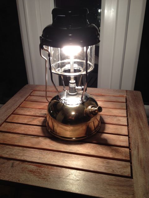

    Hi all,
    This is my first post, so I would like to start by saying what an informative and useful site I have found this to be. Although new to the site, I am not new to Tilley lamps and my collection has gradually increased over the years, and I now have four running examples.
    My latest project is to refurbish an X246B for a friend, it was in a bit of a state, but after polishing, flushing and changing all the washers for new Viton type, it looked pretty good. I cleaned the burner and fettled it with Tilley SP2 and SP3 and treated it to a NOS 606 vapouriser. It ran ok, but not as bright as my X246A, so after a bit of substitution, I found that the aluminium pump was not very efficient, so I changed it for a spare guardsman brass one.
    I usually start my lamps with 15 pumps and then 85 pumps when lit and it burned perfectly with an old stock mantle, almost too bright to look at and I was pretty pleased with it.

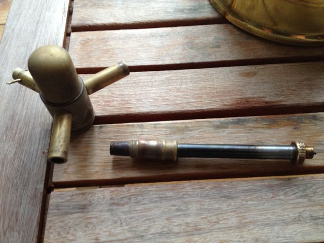

    However, after a couple of hours use, I turned it off and discovered that the vapouriser had started to bulge around the first ring. I cleaned it up and lit it again (big mistake) and after another hour or so of patchy performance, I found that it would not turn off without releasing the pressure. The vapouriser had ballooned inside the burner mantle tube, to such an extent that it stretched the brass mantle tube and was well and truly stuck (see pictures below). Also, the burner tubes had come loose in the burner, suggesting to me that it may have overheated.

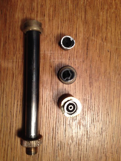

    I have read about pregnant vapourisers on this site, so I cut this one up to see what happened. As you can see the top part has stretched away from the inner cone holder and the void is packed with solid carbon. This has happened after maybe 3hrs use and failed within two hours of the final trial. I only use good quality BS C1 standard paraffin, that has been fine in all my other lamps, so do not think it is a fuel problem.

    Welcome to the forum. This is what the Germans call a pregnant vaporizer.
    Happened a lot on the mainland and in fact it is mentioned in the Tilley book.
    As I remembered well it has to do with high carbon fuel.
    9,632
    Interesting... I've only had that happen with a brass vaporiser.
    That looks like an older Tilley vaporiser (not the new ones). Does the bottom unscrew or is it crimped?
    You should dissect the tube and see how much carbon is in there...

    Wimm - thanks, I can see I'm not alone with this, maybe it was a defective vap that just sat on a shelf for decades until I fired it up.
    Tony - It was an old one, which looked unused and all I did was clean off some light surface rust. The rest of the tube below the first ring is clear and not distorted, other than some light carbon deposits, it looks ok.
    Mike - I use the prepack 4l fuel, marked BS2869 C1 and EEC 294-799-5, so it meets BS and EU standards. I understood that C2 is the heavy grade for heating boilers, interesting that it works in your lamps. Do others use C1 or C2?
    Macburner - agree the burners get hot, but not like this one. If you look at the picture of the mantle tube, the brass has not only stretched, but has been annealed to a copper colour so it must have got very hot indeed.
    Gneiss - note what you say, and I'm sure if I'd left it much longer the tube would have completely closed off.
    I wonder if paraffin vapour has got trapped in between the stretched outer tube and the cone holder and actually burnt inside the vapouriser, expanding it more and more, overheating the mantle tube and crushing the inner cone tube.
    This all happened very quickly, so the lesson is if the top of the vap looks stretched or distorted, throw it away quick.

    Thanks for the advice, I did clean the feed tube with a bit of copper wire when I flushed the tank, but checked it again and it is clean. I have fitted another NOS vapouriser and changed the barrel of the burner for a spare and fired it up.
    It lit first time and seems to run fine with a Basecamp pro mantle, (which I find are much better than the latest Tilley NRA types that are decidedly dim in comparison) The new vapouriser is showing no signs of distress after after two burns of about 2hrs each so I will see how it goes.
    I think you are right about fuel flow, and I guess that these vaps rely on the fuel flowing through them quickly and vaporising before it can get too hot. Once it get trapped in the tube I think the high temperature at the top just burns it to carbon inside the tube, causing the failure. Interesting links you include to the other posts on this subject shows that several people have experienced these failures.
    Many thanks to all, and here is the final effect
    Graham
