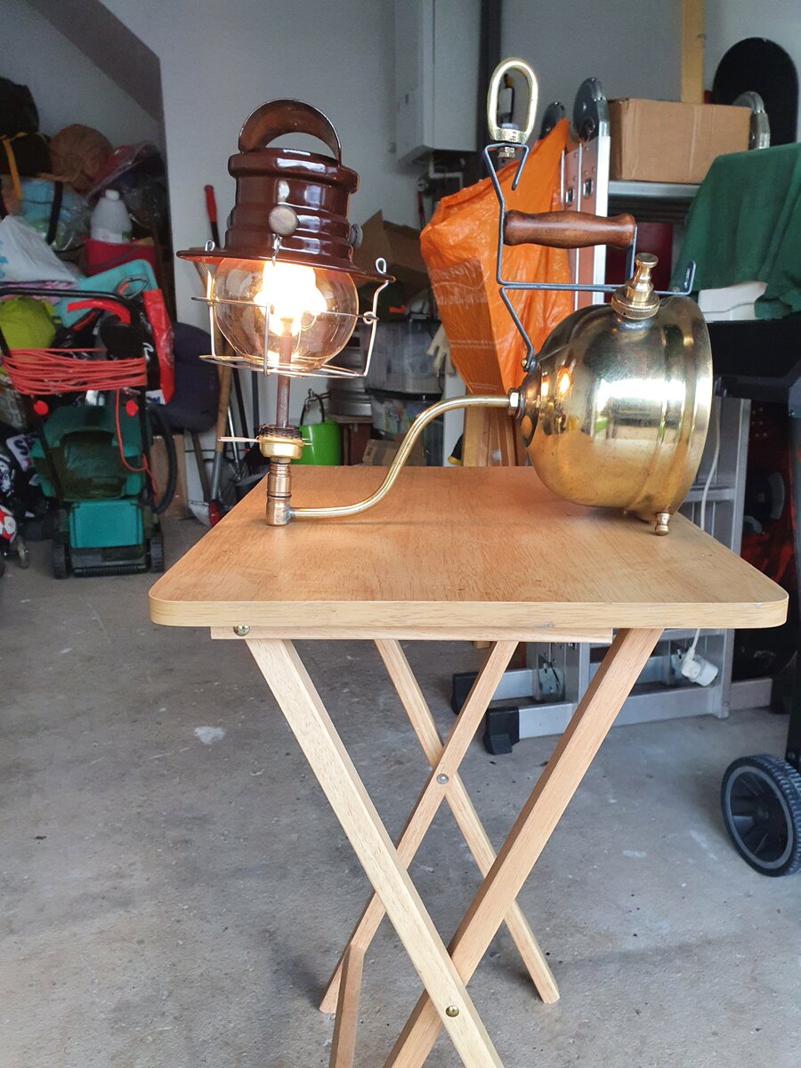

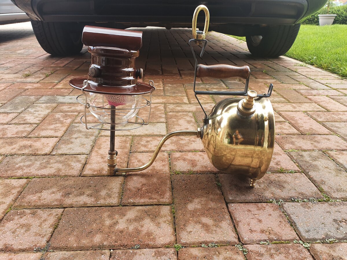

1. Grigorios Makrakis United Kingdom
    Sep 14, 2020
    5
    Ayr
    Is anyone could recognise this Tilley Lamp? I have it heritage from my father and I recently restored it. I found some info saying is a British army hospital lamp but nothing solid.

    Welcome to CPL! :)
    You have a lovely Tilley lamp with great history!:thumbup:
    p.s. look in the gallery under SL61

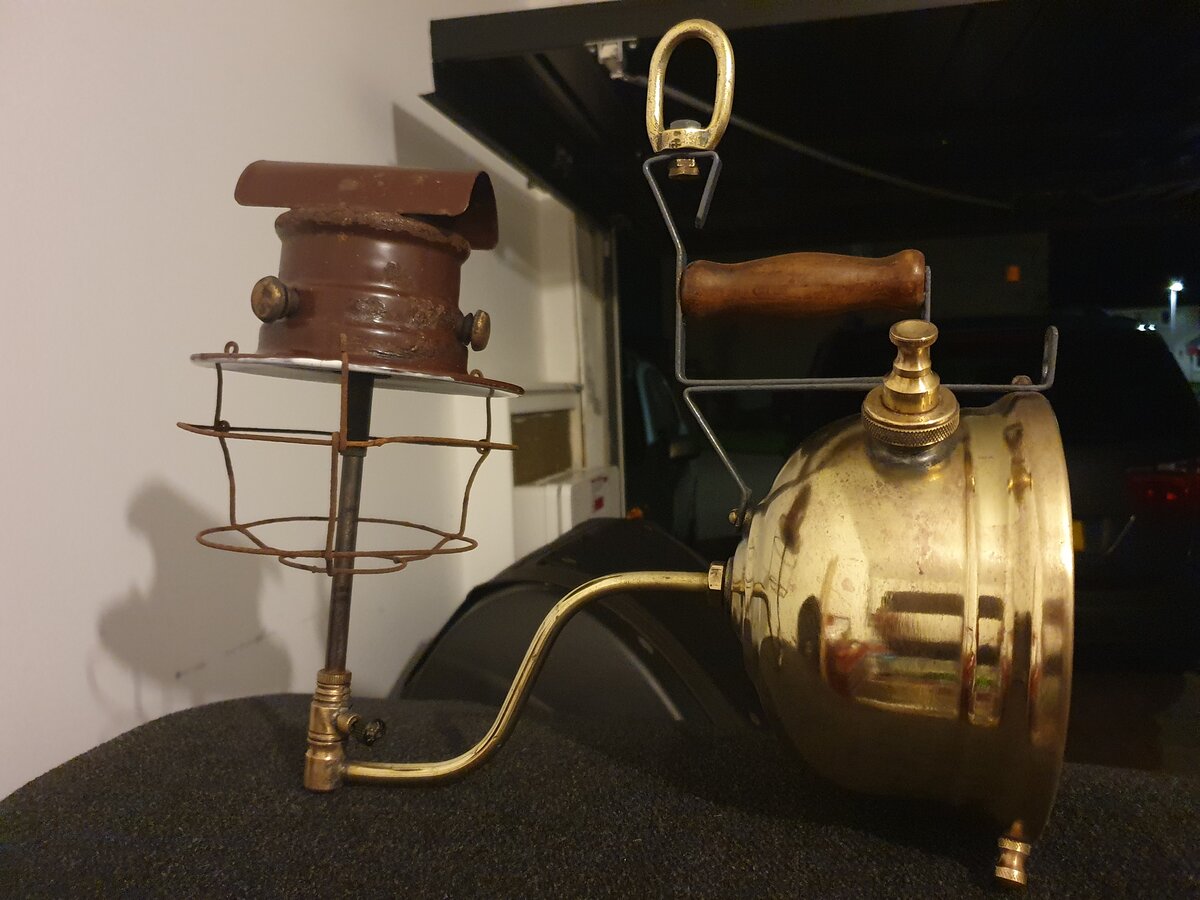

  11. Grigorios Makrakis United Kingdom
    Sep 14, 2020
    5
    Ayr
    @Anthony, unfortunately I don't have any previously pictures. The hood, glass and cage purchased new. The burner and knobs are the factory ones, same as the rest of the lamp.
    My dad had it the last 50 years and only used it few times, I was sceptical as I didn't know how many parts you can find online and really pleased with the result.
    Actually I did found a picture with old hood and cage, but already polished, see below

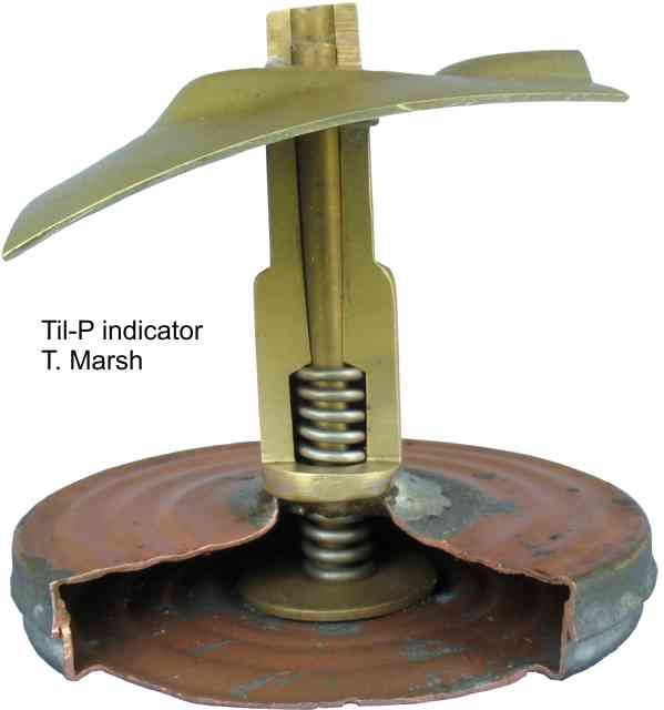

  14. Mackburner
    6,271
    This image of a cut away indicator by Terry Marsh will help to understand how it works and where any joint failure or cracks may cause a leak. ::Neil::

    @JEFF JOHNSON and ,@Mackburner
    Thanks a lot for the assistance to both, it is very clear how it works now, mine was seized but with some reinforcement and some wd40 came back to life. I will monitor it for pressure leak, so far looks good.
