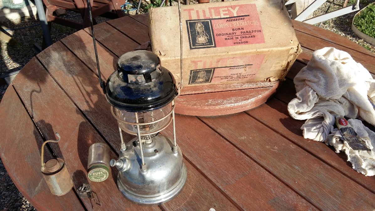

    Now that I know what I'm looking at a little I worked out pretty quickly that it needed a new leather pump bucket and it had at least two leaking seals. I bought a seal kit and while I had planned on not touching this until I had the Austramax up and running I couldn't help myself. Very pleased to see one of these pressure lanterns up and running in real life and they really are a lovely sight to see.
    I have concluded the tilleys are probably a little easier to service than the austramaxes. But also this time around I'm focusing on function first, and really have not touched the cosmetics.
    Unpacked after purchase and I'm surprised someone has kept the box all these years!!

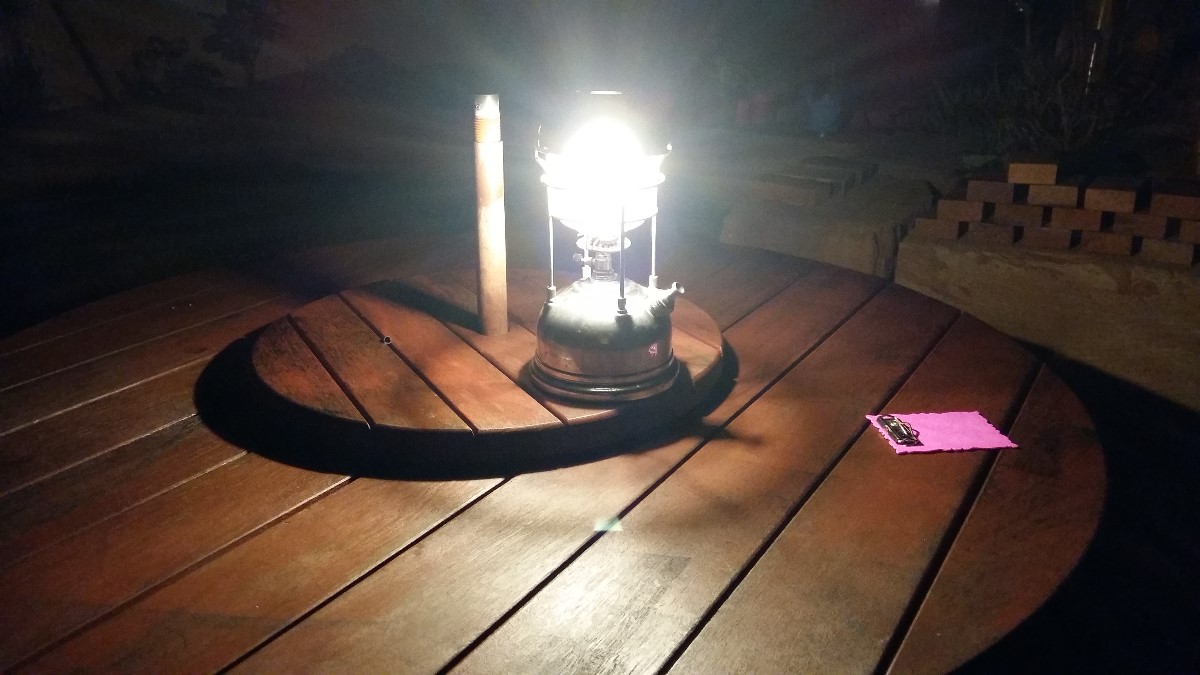

    And after a new seal kit put through, tank flush, clean of all internals, sandpaper on the heavily sooted pricker rod, a new mantle, and I used yellow gas tape twisted into string for the gland seal which the previous owner had repaired previously using kitchen silk string which was not holding air at time of purchase. This is definitely going into the back of the 4wd for our Christmas camping trip:

    Very nice purchase, looks in good condition for age, may well have a date stamp on the base.

    The lamping bug bites deeply and you were lucky to find a boxed example and your Tilley is working well!:thumbup::clap::D/:D/:clap::thumbup:
  4. David Shouksmith
    5,751
    Great Lumley - cultural capital of N.E. England
    There should have been two gland seals in the service kit. You can also use an 'O' ring...

    Hi @David Shouksmith , for some reason the seal kit I got did not have the two seals, but it did have what looks like some leather string which I'm guessing they have included for the gland packing.
