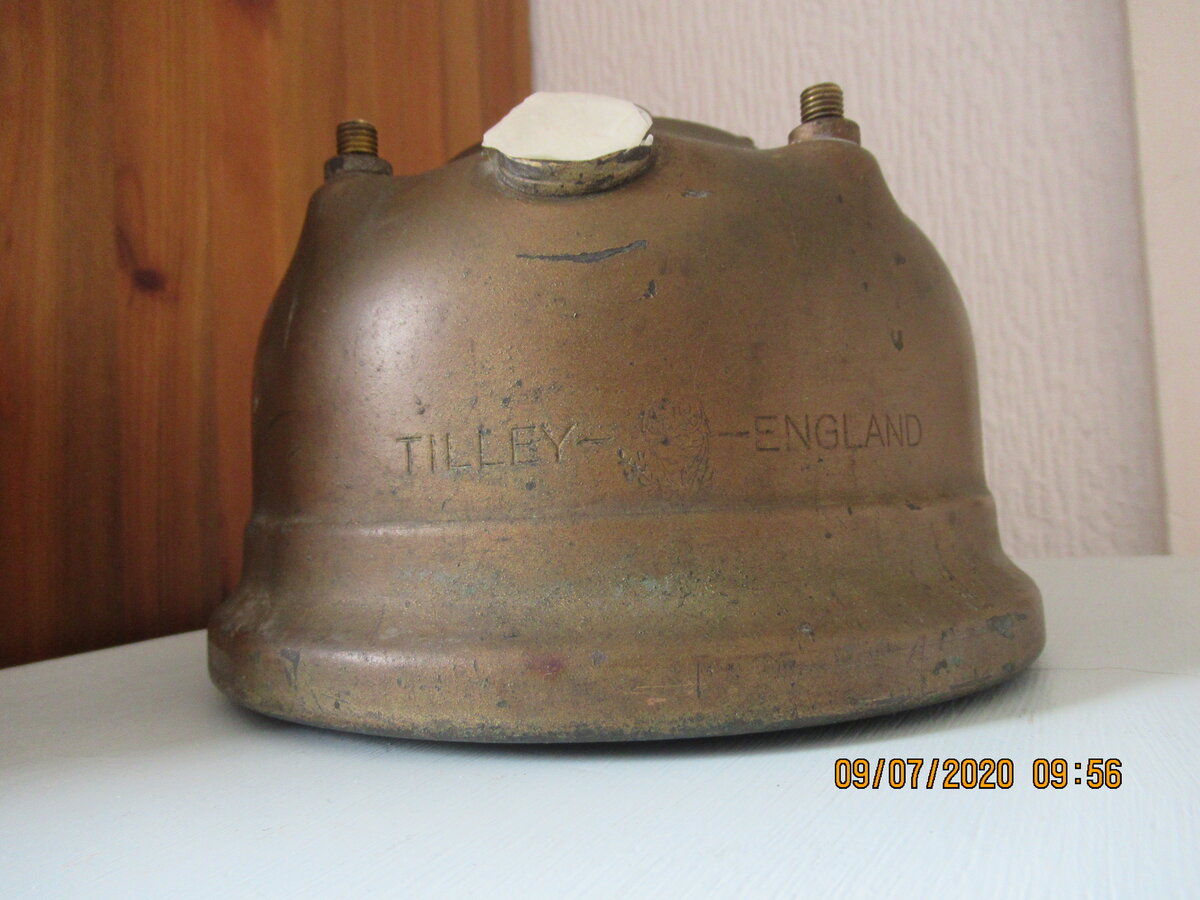

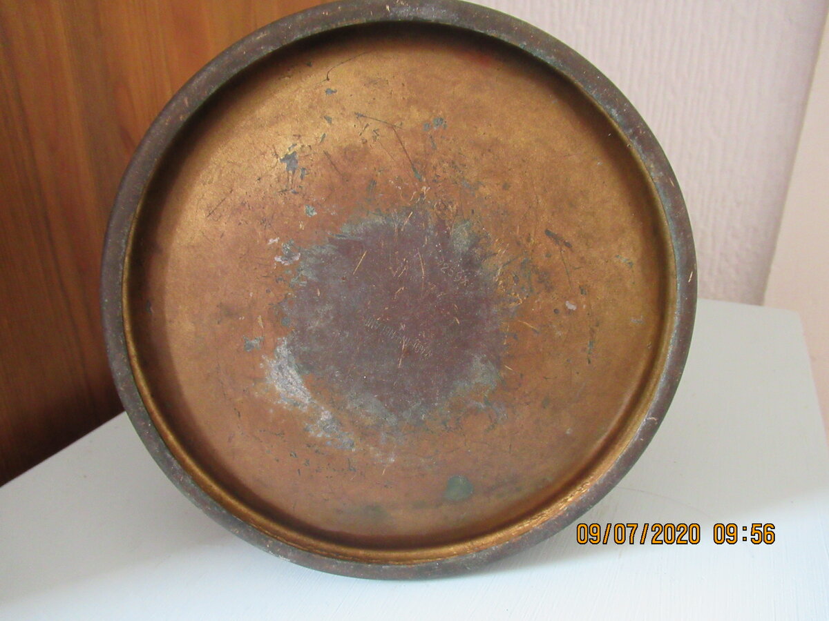

    My new project to restore a x246. just realised it has a wobble, the base has blown out a little, no leaks, looks like it has been like that for a while as the paint iis all gone on the bulge.
    Is there a way off 'pushing it back' without causing a bigger problem?
    6,201
    Throw it away... If the base (on that variation of the X246) is blown, you have the potential for catastrophic failure of the internal seam in the tank.
    Keep the bottom plate for a reflector, and take the rest of the tank to the metal merchant.

    I agree the fount is not usable for a lantern any more but don't send it to the metalo.
    With a bit of triming it may a suitable windsheid for a small stove. I have one the same though the later model.
    It will definately not go for scrap. Devising a plan now.
    Geoff
  4. podbros
    1,069
    Wirral
    Hi @John Sayer
    You can still use them at lower pressures but there is always the 'uncertainty' factor that plays on my mind..What if?
    I don't know the general condition of the rest of the Guardsman so it's down to you whether you want to restore and put it on a shelf or to use for spares?
    The date stamp looks something like 2 59 ? But you could always get an earlier tank/fount as they were made better with an extra 'crimp' or swage line, there are always some on ebay or perhaps there is someone on here that has a spare?
    Lots of options!:)

    I'm sure you will correct me if I am wrong but if I used it and it was lit and the tank fractured would I not just have a sudden loss of pressure and lamp goes out and I would just have paraffin leaking out. The tank looks solid.

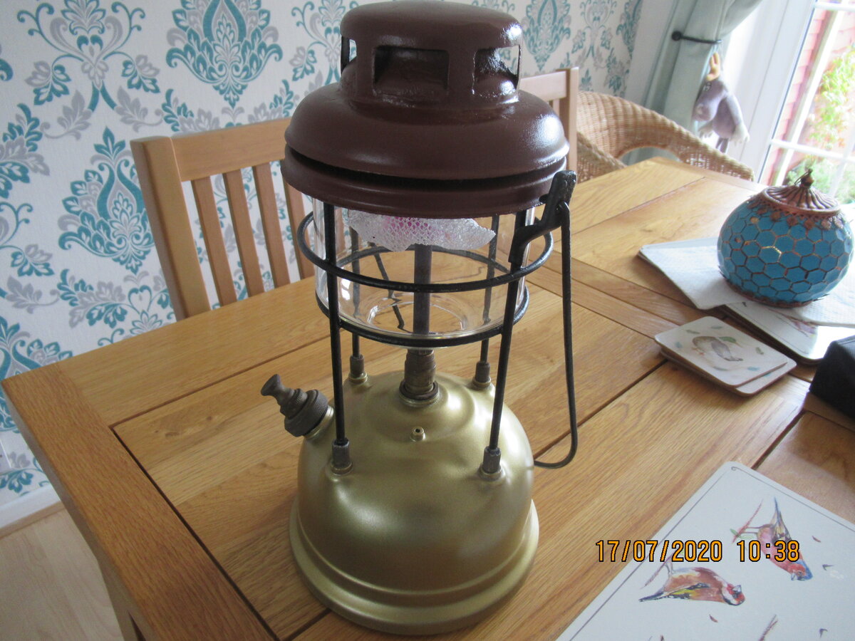

    Having taken on board whats been said about blown tanks and read previous post's i certainly wont be using it as it is. I mentioned my predicament to the lady of the house and she said "oh, I want one without any paraffin in as a ornament/decorative piece " Problem solved. I was intending to just to clean it up, have it working and leaving it with petina but now it will get a full make over.

    I'd stick 50 or 60 PSI in the fount and let it sit for a couple of weeks. If you find in a couple of weeks the fount has held pressure, I personally, wouldn't be bothered at all using the lamp with 15 PSI in it.

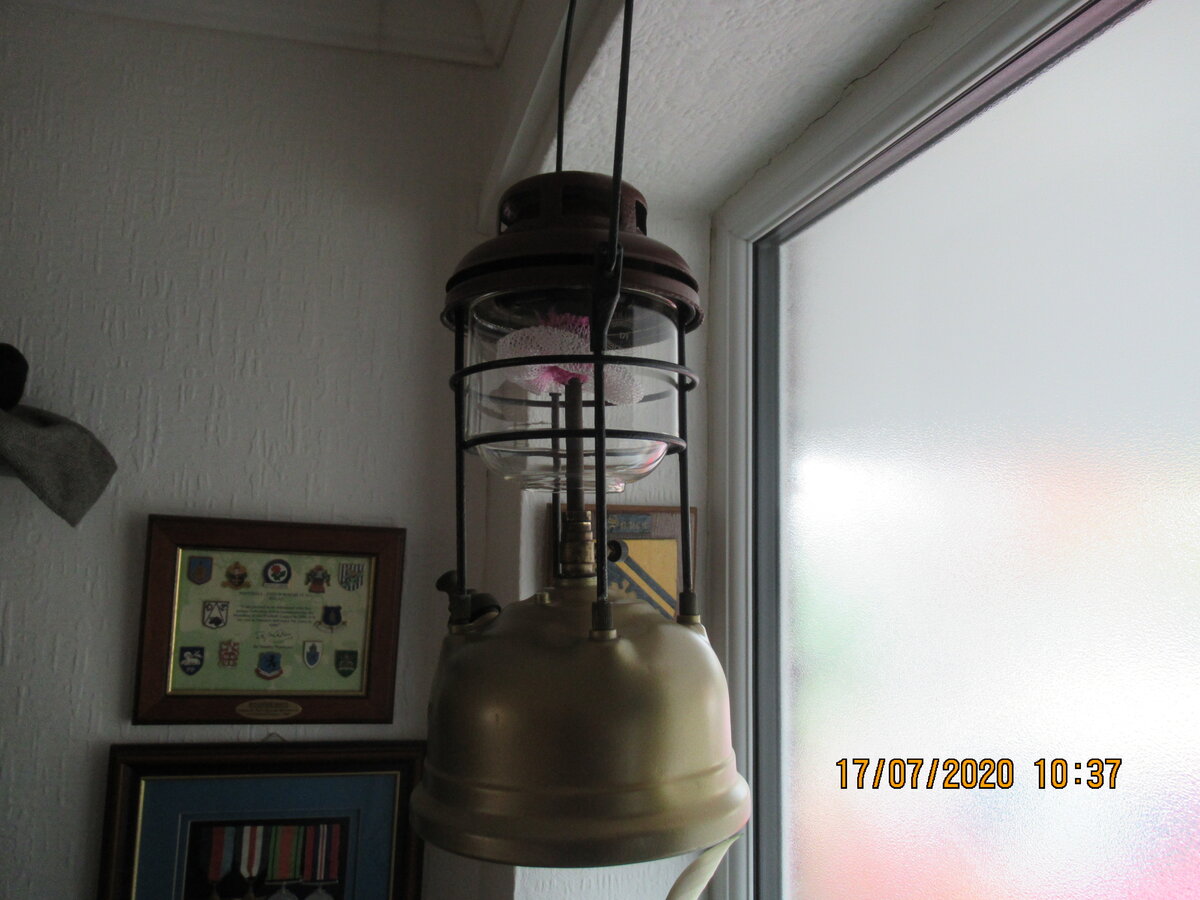

    I have not gone as far as turning it electric but I have gone against my principals as an ex vintage motorcycle owner I always rode my bikes to a show, never won anything, the winners always came on a trailer or van probably with no internals but looked good. I insisted that what i restore worked but this lamp is now for show only. I got a can of tan coloured paint mixed as a match for the hood, sprayed the cage black and got an off the shelf tin of gold for the tank. The lamp is now retired like myself, at least its not scrapped it has found a nice place to hang out.
