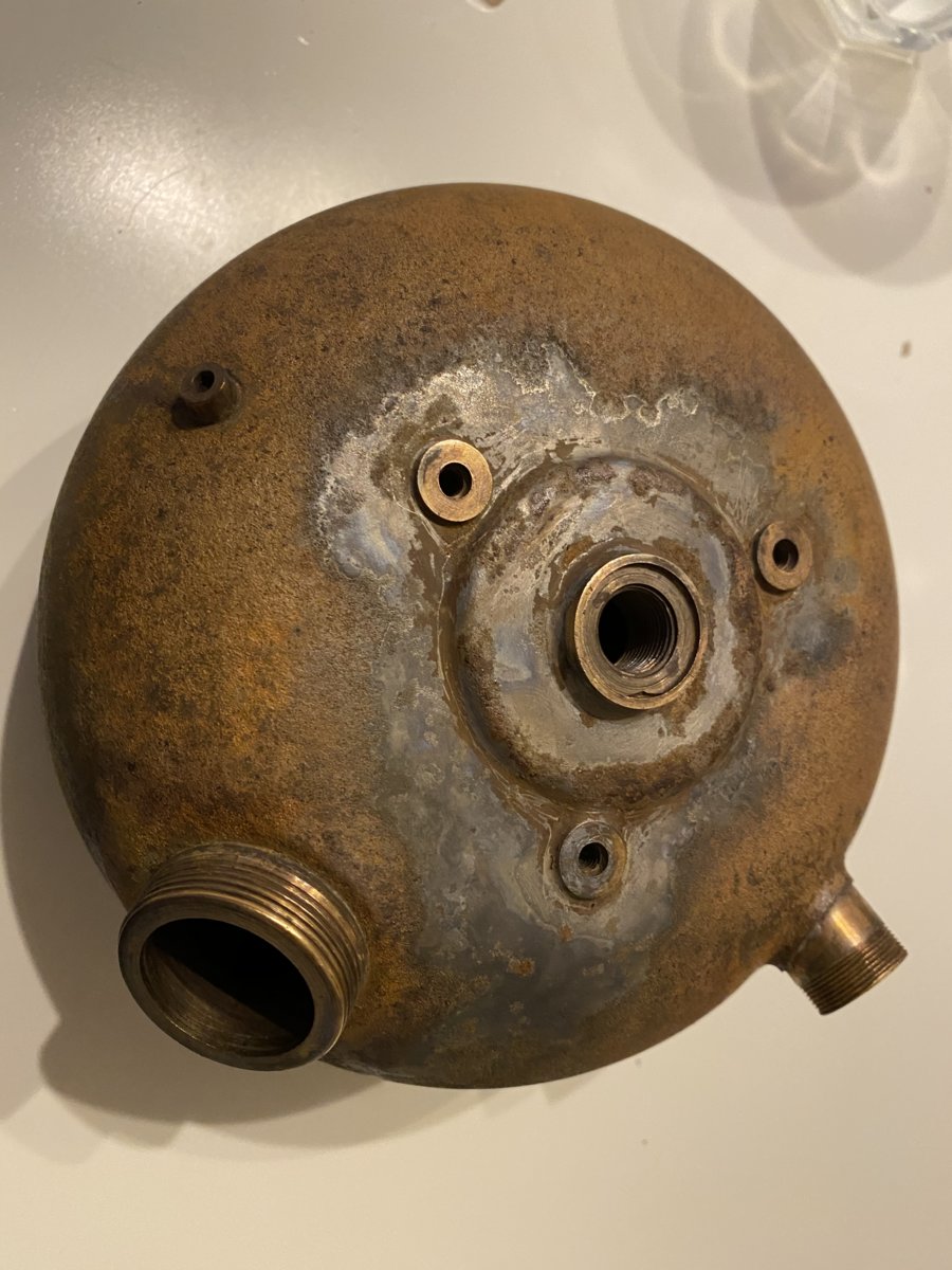

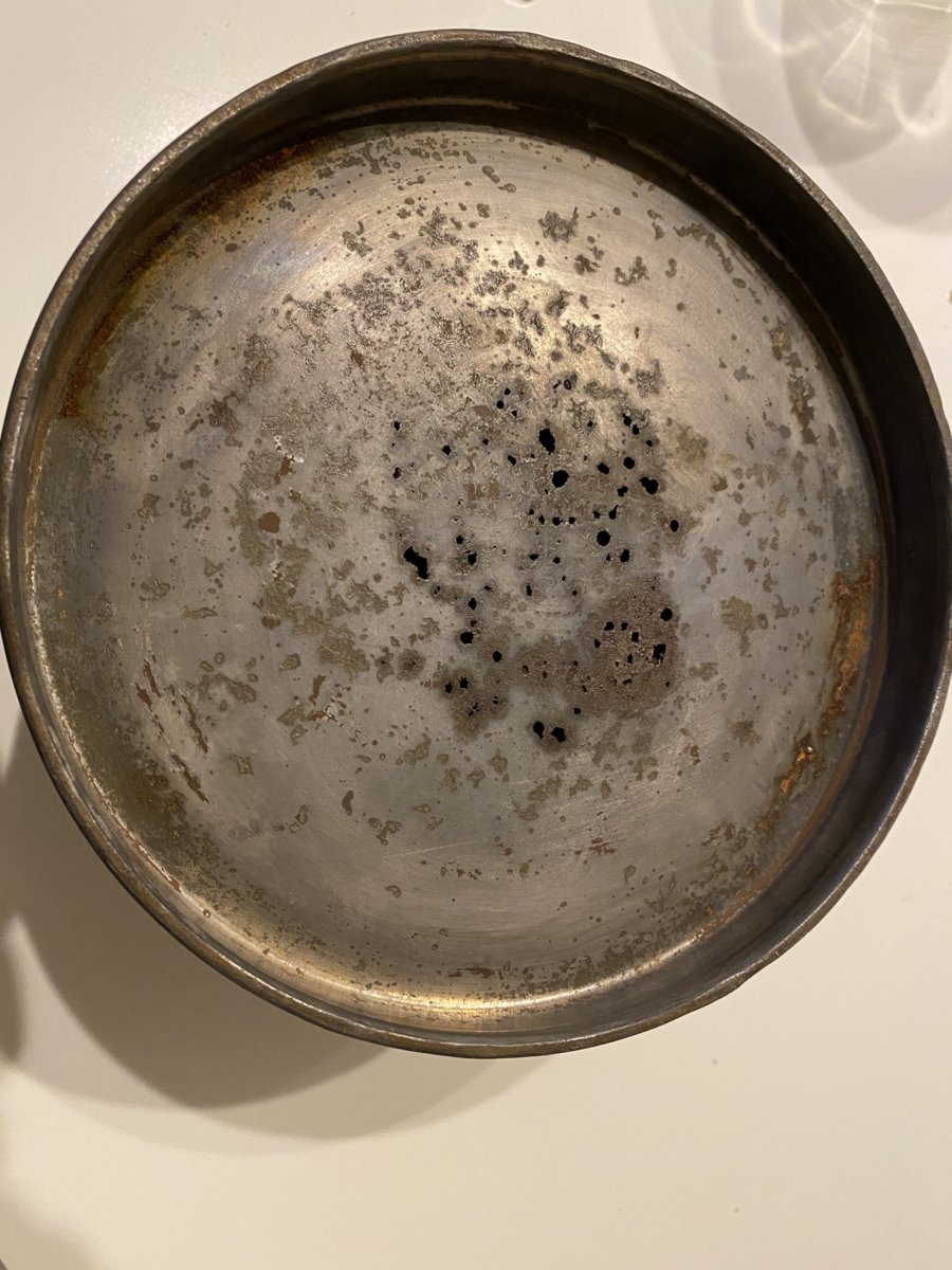

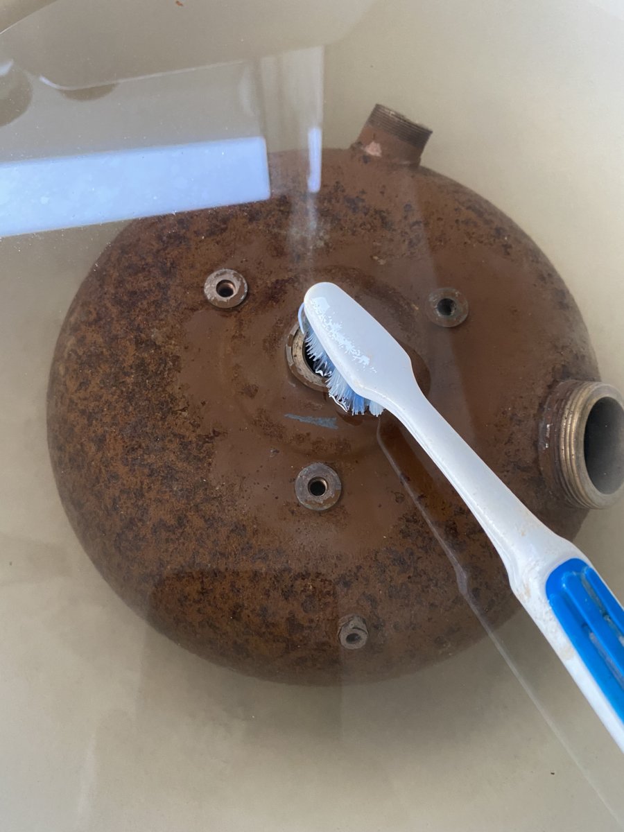

    So as it says in the heading, I’m in the process of a restoration of a Vapalux 300 with steel fount and after a few days of soaking in white vinegar the fount has cleaned up pretty well. The major problem is that the bottom is pretty compromised with a fair few holes.
    Are these founts easy to solder a plate to, or is it just not worth the hassle.
    Thanks Jon

    Few things are completely irreparable, but you have to consider the time, energy and expense of the task and weigh those against the probable chances of success. I wouldn't bother repairing it as I wouldn't trust the base.
    If you haunt eBay for the next few weeks or months you'll probably find a donor lamp which will have other usable parts.

    Colin has a good point. Repair with epoxy or tin plate and solder, how long will this last if initially succesfull? The whole bottom is structurally suspect. And never forget it is a pressure vessel with fuel after all. Still can be a good show piece, and then a very apt example that steel is not a good idea for containers that can trap condens and are not used regularly. Your splendid E41 a good argument for brass, in contrast!

    Colin & Mike That’s what I’m thinking, that if I were to plate it how long would it last. I suppose this one could be just a display piece next to my E41. So looks like it will be another one in rapidal grey.

    @JEFF JOHNSON I did think that. I’ve decided I’m going to try and save it and see if I can solder a small plate over the bottom. I’ve nothing to loose by trying and if it doesn’t work I’ll still paint it and have it as a dust gatherer.

    I won’t soldering the holes, I’m looking at a large repair patch over the majority of the base. I’ve done a couple of petrol tanks a few years ago, so not much difference.
    The biggest problem will be the actual solder due to the lower lead content.
    Once it’s done I’ll pressure test it in a water tank. If it fixes it all well and good if not then I’ve not lost anything other than a bit of time.

    Understanding that when the fount is pumped up to approximately 2 bar (200kPa or 29psi) working pressure, there is a pressure force of over 2000lbs or 910kgs applied to the surfaces of the fount. Any flat plate surface, a fount’s base, will flex or bulge with this force.
    A lamp that operates with the fount’s base pressure of over 2000lbs force, or 910kgs, a flame on top and a tank of fuel all contained by a corroded and structurally suspect base ........ what could go wrong?
