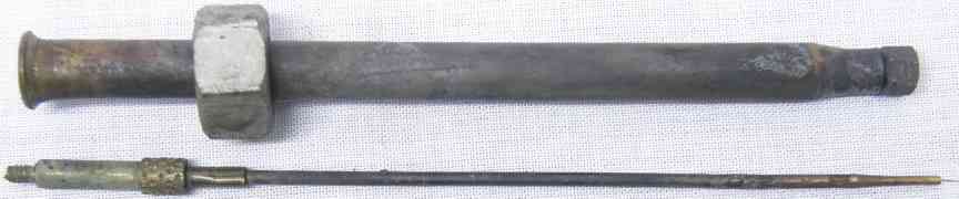

    IMG_0484.jpeg IMG_0483.jpeg IMG_0480.jpeg IMG_0474.jpeg IMG_0475.jpeg Just started stripping down a Turner 511. All going ok so far but have hit my first question. The cleaning wire looks like it should unscrew as it has a knurled section, but it’s not for budging. Wanted to check it definitely should unscrew before I apply more pressure? Whilst I’m here, same situation on the clean/gas valve wheel. It looks as though it should unscrew but again if anyone can provide some assurance before I increase the elbow torque, that would be great. Thanks.

    The pricker rod certainly unscrews but I can't remember if the controls also do. Likely do though. ::Neil::

    Yep, nice and easy when you know you’re not going to break it!
