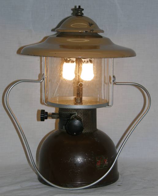

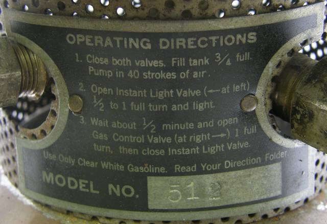

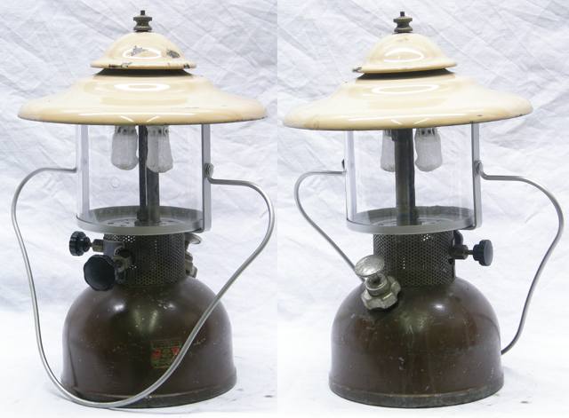

    Here is another colour combination. Coffee and Cream. I repainted the globe cage on this about an hour ago. I bead blasted it and then sprayed on Hammerite Smooth Silver. Normally this stuff takes around 4 days to full cure but I find that 20 minutes in the oven at 200c does the trick. This lantern is pretty much the same as 1511 except the pricker rod is like a Coleman with a hook fitter. I seem to recall that I have fitted a Coleman generator to a Turner table lamp so very probably this lantern would also run with 300 cp coleman generator. Handy that because it means that this model is always going to be easier to fettle because a Coleman generator is not a problem whereas Turner generators are impossible. This is the first Turner fettle I have done over the last two days that has run as it should. It instant lights and runs bright on full fuel. ::Neil::

    Wow Neil...You really are tearing into the Turners today...On a Roll!
    Coffee and Cream...another nice lantern the 512 is

    Think I 've run out now. Mind you there should be 1501 and X159 lurking amongst the pile but I could not see them today. Probably trip over them tommorow. I won't post the X159 because that is already featured here but if I can find the 1501 I might. Next trick is likely to be the Brooklures. Should be a couple of those hiding somewhere. Compared to Brooklure stuff Turners are neat lightweights. ::Neil::

    NICE Turner!!! :thumbup: I see that they made a change to the "connecting rod" that rides on the valve shaft to accept a hooked pricker shaft. I found that on my "parts" X-159.
    That Brooklure you mention is very much like the "10 pound brown" that Prentiss Wabers built for Sears. They may be "cousins".
    Bob

    Yes pretty close cousins at that. Brooklure is Joseph Spiegel mail order and it is for sure they never made them so the PW-Turner cross is likely the same lantern. I remember a few years back Terry March side by side comparison of these and some where I have some images of this. There are some variations as I recall but they are minor. Be a couple of days yet but I will dig them out and see what can be dusted off to show here. ::Neil::
