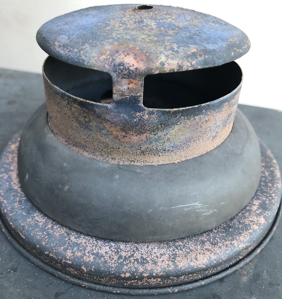

    A recent Tilley pork pie i purchased must have been used by the previous owner to support something heavy. As a result the brass hood has squashed downwards by a cm or two, closing the vents. (I can post a photo tomorrow if that would help to describe the situation.)
    The brass sections between the open vent sections have folded over under the weight. I’m wondering how to approach straightening them without cracking the brass. Is this likely to work and would doing this at high temp be best?
    Any advice welcome.

    As it turned out the hardest part was getting the old burner out of a squashed hood - tubes jammed on tight angles and no room for tools or fingers. In the end I took a destructive approach to removing the insect screen and things got easier from there. Here are some photos, in the first one it’s just been degreased.
    I was keen to try the annealling because fixing it if it cracked is beyond my tool/skill level. Its closer to straight than it looks in the photo.
    The burner dome is dented too, so that’s the next task.
  15. Tony Press
    8,097
    It’s looking better already!

    Glad to see you managed to straightened it out without breaking the three small tags, that's an achievement in itself, replacement enamelled caps are available from julian shaw at tilleylampsandstoves.
