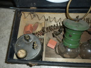

    Two hollow wire lanterns in a set, boxed.

    Karli, At last a new French lamp entry :thumbup:. It looks like a complete hollow wire system, with lamps using the Unic nr.2 burner. Have you had it running yet? It would be nice having pics of this system running.
    Cheers from La Gomera!
    /Conny
  3. karli
    karli Subscriber
    679
    Till today I hadn't the lamps running, cause
    the wires are not long enough.
    But the lanterns are complete

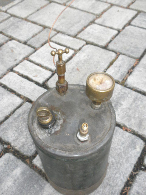

    Here are the picture from the lighting hollow wire UNIC.
    I t was a very easy starting procedure.
    Preheating with a Tilley clomb-
    Lighting, 2x needling, that was all after years of non lighting 1304311964-c1.jpg 1304311997-c2.jpg

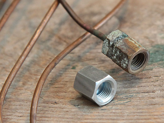

  16. Carlsson
    3,542
    Cheers Claus!
    Yes, refrigeration tubing is perfekt for this.
    Right size, more than long enough and really soft.
    If you don't want to make the nuts for the fittings yourself, you can use parts made for car brakes. There are some different sizes, and M10X1 with inner threads is one available fitting for some cars.
    And I'm pretty sure your Globe follow the normal standard for lamp fittings, which happen to be just M10X1.
    Below you can see an original hollow wire for a Swedish lamp system with attachment nut as it came when ordering it back then.
    The loose nut is just simply bought at Mekonomen as a standard brake line part, and it is perfect for the job even if it doesn't look perfectly original. But that's easy to fix if desired.
