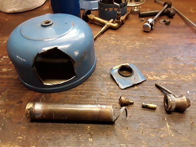

    Had a slight leak from the check valve, so decided to see what makes this tic. No luck with wide screw driver, plus by the time I found a large screw driver, the slot on the check valve(I saw it was a NRV after removing) wasn't in good enough shape to hold a screwdriver head, even with being wedged in a clamp. Funny, after the pump tube removal then the end, with two Vise Grips(expecting a battle) the NRV came loose with little effort. With the snorkel in the pump tube, impossible to remove from the fount without other measures.

  2. phaedrus42
    phaedrus42 Subscriber
    2,005
    Ouch! Any chance of finding a replacement fount? The design appears to be very similar to AGM.
  3. hikerduane
    Oct 2, 2011
    172
    I may look or see if a friend can use them, other than the slight leak, even with the pump shaft screwed in leak a little, but ran well. This was my first blue lantern , but have since gotten a Coleman 243 and two 243A's.

  9. James
    James Subscriber
    Jan 5, 2011
    1,110
    Too late now, but you could have saved the lantern by fitting a schrader valve, either in the fuel cap or in a new hole, then filled the leaky pump tube with epoxy.

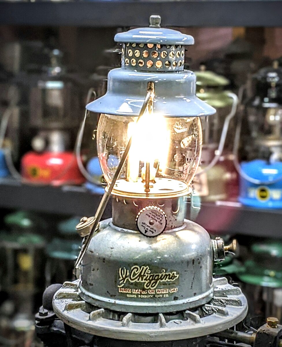

  10. Pancholoco1911 United States
    Nov 26, 2019
    260
    There’s is also another blue lantern and it’s the JC Higgins

  12. hikerduane
    Oct 2, 2011
    172
    I even had a Schraeder fuel cap which I did use to add pressure so I could remove the pump and squirt alcohol in the tube to check exactly where the leak was, although I know the air stem is supposed to close off the NRV. Yep, too late, never gave it a thought. Doh!

  13. Rustytank United States
    Nov 12, 2019
    31
    Woodbury Tennessee
    You ever heard of an ez-out?
  14. hikerduane
    Oct 2, 2011
    172
    I've never had any luck with a EZ-out, they just chew parts up, plus reaching down far enough with some extension is impossible with the tools I have. More tools cost more than a Chinese lantern is worth. I have my Coleman 243 models now to cover lanterns in blue. I just move on.

  18. hikerduane
    Oct 2, 2011
    172
    @Rustytank, genny and other parts are good, decent vent with chipping at the hole on top, be nice to just pass along. $10 +. PM a mailing address and can maybe send out next few days. PP addy is my email.
