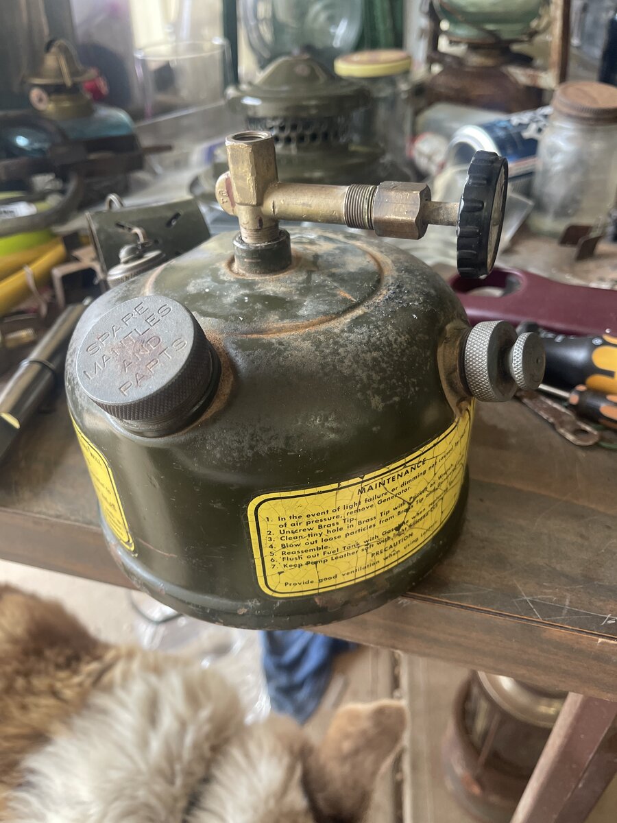

    Hi fellas, one for the Coleman fellas.
    It appears that the air tube is blocked at the bottom of the cock valve., the pump works the valve works, can not get air into the tank. I’ve tried pumping air with no valve , no air. I’ve soaked it with shellite even tried to push some through but still no air in the tank.
    Open for suggestions.
    The lantern has sat empty for a few years?

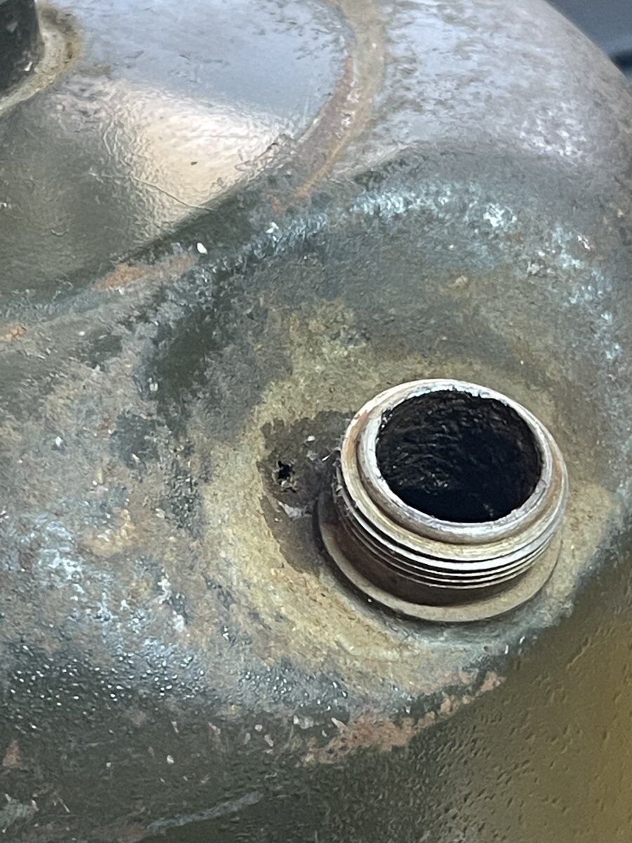

    Hi fellas upon further investigation, I think my tank has had it.
    The inside of the tank is rusty, I can see corrosion pits all through it, I have one large pin hole above the fuel cap. The out side at the bottom of the pump tube is encrusted with rust, other internal parts have rust. It doesn’t look good for my lantern.

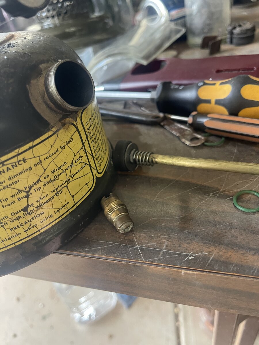

    @MYN . I couldn’t pump air into it, I removed the check valve and still couldn’t pump air in to it. I put a torch up to the openings I could see vast rust and particularly at the bottom of the pump, the bottom had a fare amount of pitting.
    I soaked it in my ultrasonic bath to heat it up 55degrees Celsius, no ultrasonic, just a good warm bath.
    When I drained and dried the tank it looked better inside but still I couldn’t put air into it,
    I noticed a small patch and under investigation turned out to be a pin hole. I did poke it to expose the hole.
    I didn’t really expect to see so much corrosion. Even now when I have a closer look there is a fair amount of pitting that I can see. Maybe my tank was doomed from the start. I hadn’t lit this lantern for a couple of years.
