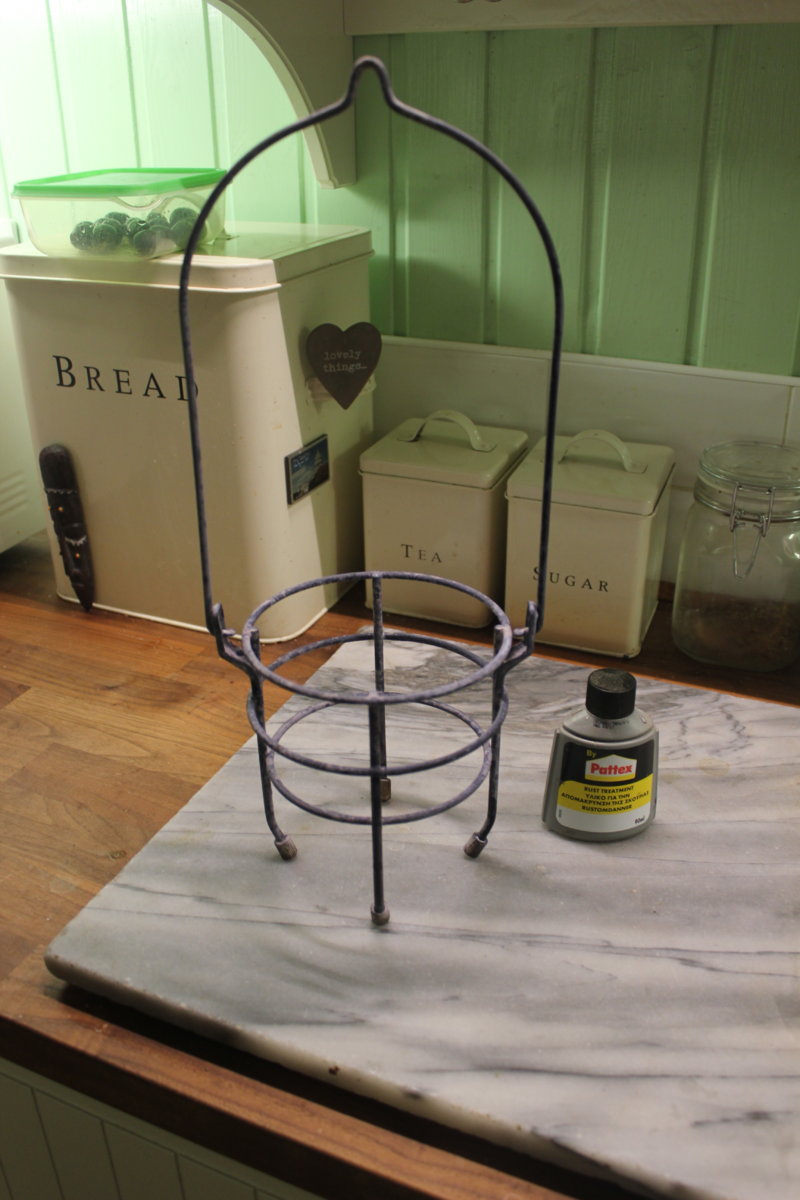

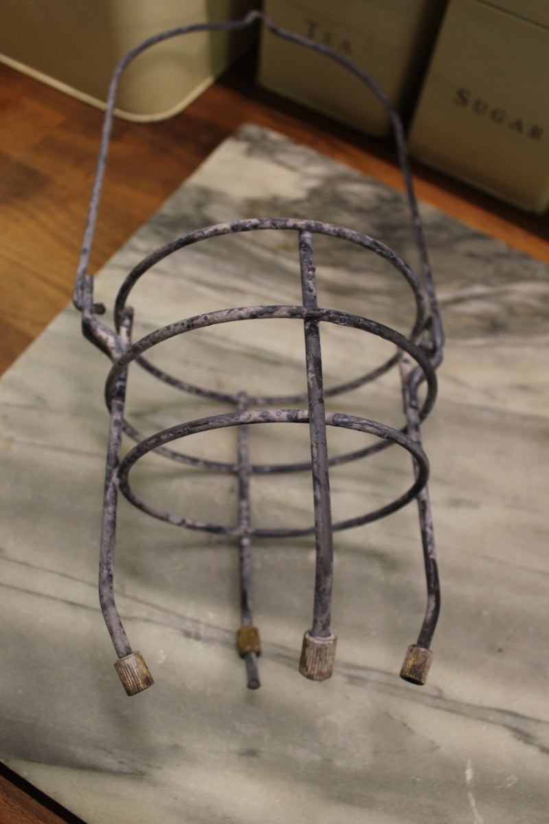

  7. ColinG
    581
    Here's the rust treatment I bought from Lidl. I can't remember how much it cost but it was no more than a few quid.
    And after two coats, this is the result.
    There are dark patches where the solution has turned the rust into iron phosphate and grey patches which I think is where there was still some paint still bonded to the surface or where the rust wasn't so pronounced. Anyway. it's only had 24 hours to fully cure so painting will have to wait till tomorrow. Also, before priming I think I'll clean the surface with fine wire wool.

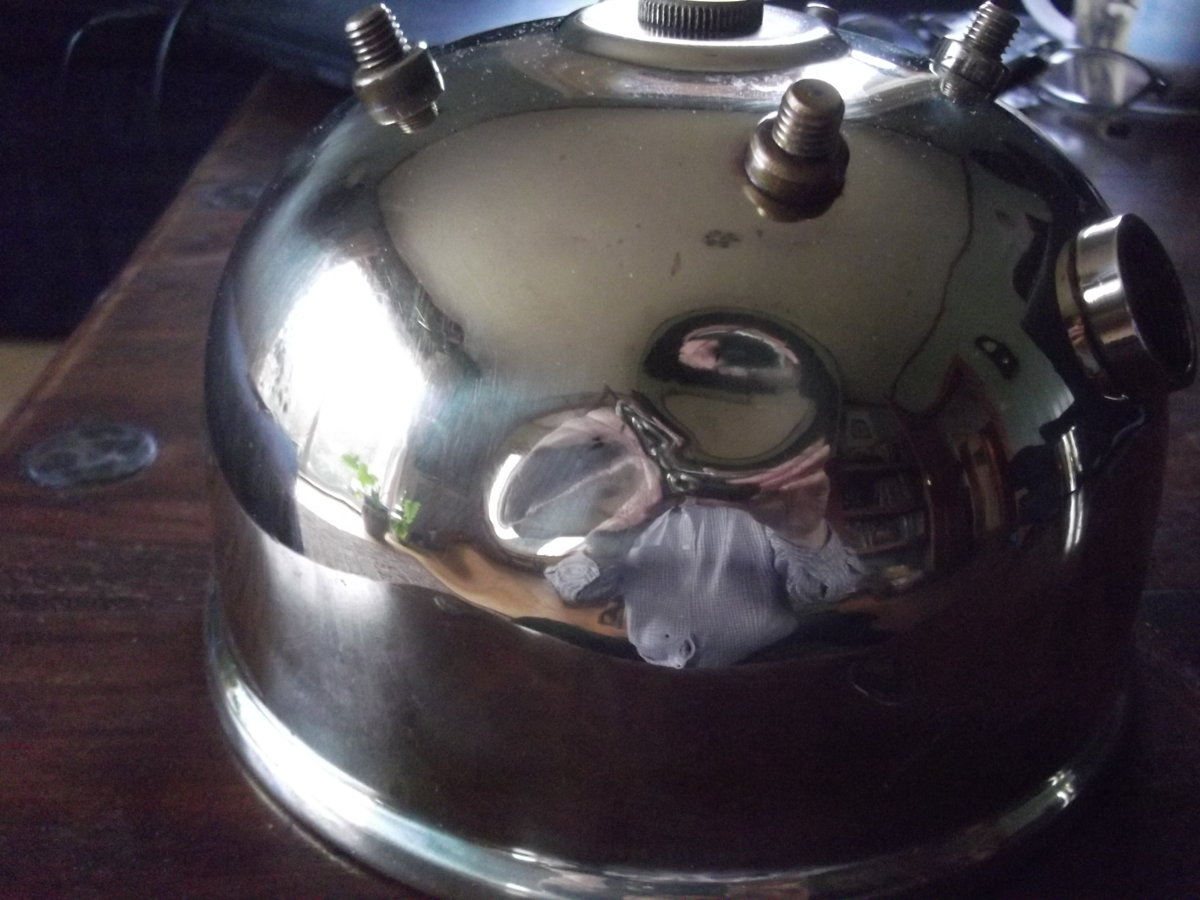

    Here is the 246A tank...
    I understand the issues concerning originality vs polishing, and the risks involved (introducing tress cracks etc) but I'd never polished a tank before and this seemed like a good lamp to try it on. It cost me nothing, it's not particularly rare and it was quite dented. The results look quite nice. I was going to try beating out the dents, or some of them at least using a technique I saw on CCS but decided against it in the end as it doesn't fully work so I just left them as 'battle scars'!

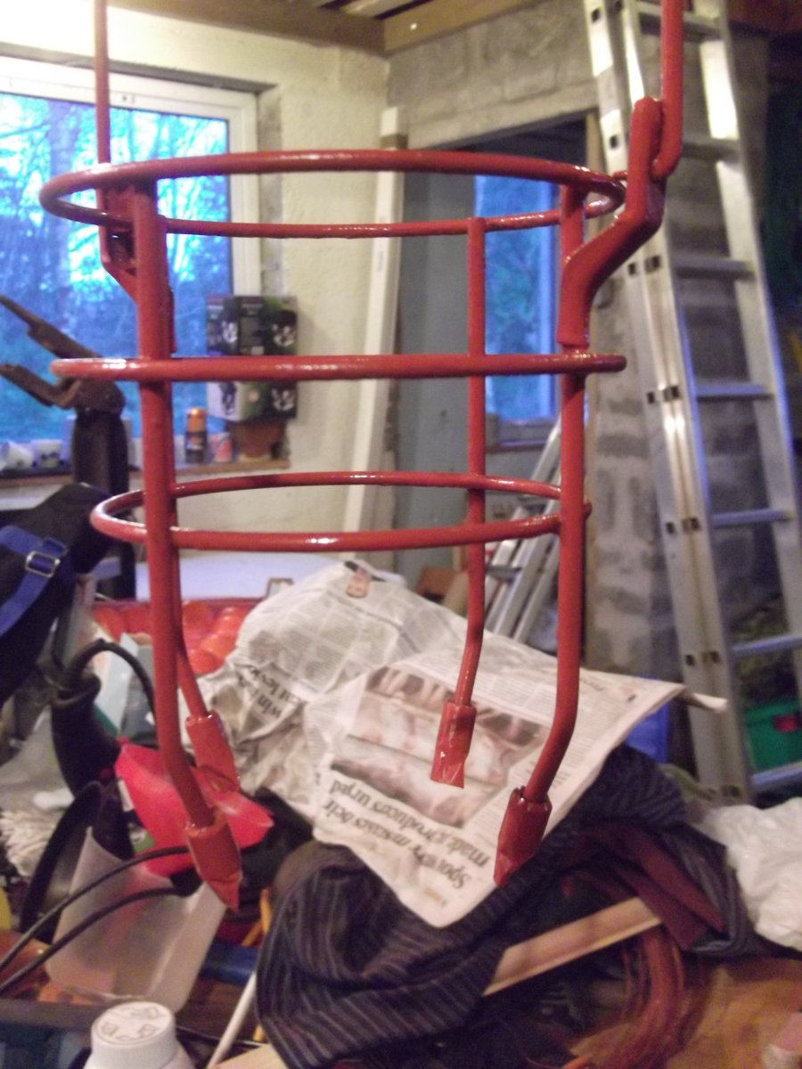

  12. ColinG
    581
    First coat of primer, still wet! This will need gentle rubbing down with fine wire wool and a second coat before the gold goes on.
    Excuse the state of my garage/workshop. It's a proper bloody mess!
