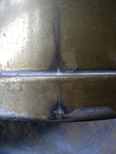

    but then I noticed 3 big ones of this:
    I didnt know Vapalux had these problem with stress-cracks in the fount - so I think after a repaint this is going to be my first shelf-queen.
    Did you take a close look at your fount ?

    Yes I checked it all over as buying a 300x with such a great feature change I then became Sherlock Holmes looking for dings dents scuffs ' deep scratches you name it. And could not see any hairline cracks as the one displayed above ' still you have a nice looking lamp there I would love to have. Just need a doner tank. Great pictures mate ' I'm jealous I want it ;)

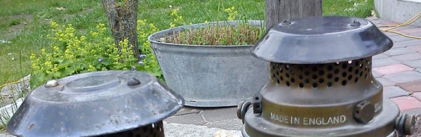

    I have these two Vapalux 300X, made in England. They are marooned coloured and with black enameled top-caps.
    Why are the top-caps different and is there any timeline in this difference?
    Claus C

    An old question that still needs an answer, if only for those reading this old thread today, so here goes:
    Ian Ashton, in his wonderfull book on Vapa's and Biala's, does only assume the top with a slight dome in the center was the early version of the simple top that replaced the E-41 style.
    This does make sense, because without a dome, hence flat, it was easier to produce, something that was a considerable factor with military orders practically taking anything that could be produced.
    So that dome disappeared in the war years, but returned after the war as some photo's of the initial postwar models suggest. It is therefore not a detail that could be linked to a specific model or time, also because these tops could easily be interchanged.
    Both are original features that have been used on the Vapalux model 300 and perhaps the initial 300X, that usually shows a bulge again in their tops.
