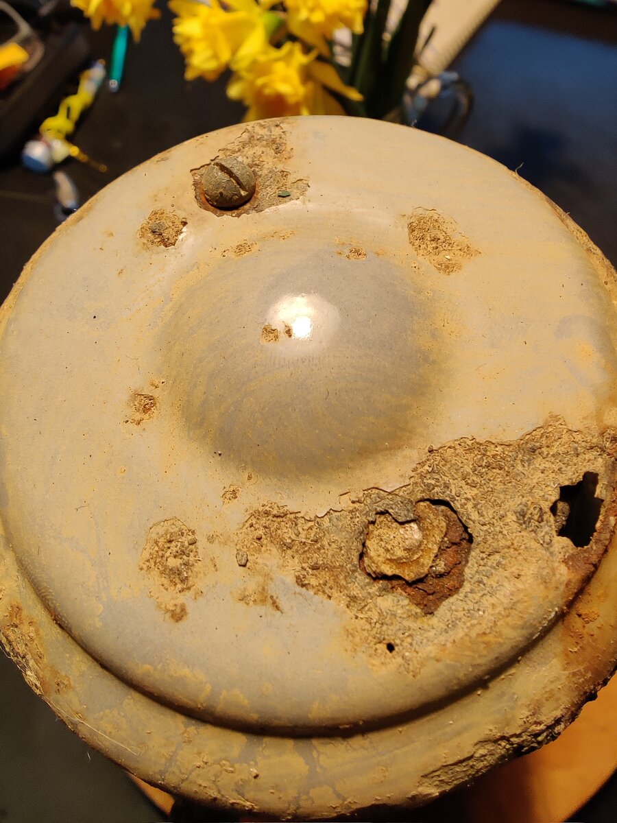

    On recently clearing an outbuilding I have found a few paraffin pressure lamps. One of them I think is a Vapalux E41. It has a brass tank and top with an enamel cap. The globe holder has patent pending stamped on it.
    I was interested in the age of the lamp and model number.
    IMG_20210219_151921.jpg IMG_20210219_151937.jpg IMG_20210219_152005.jpg IMG_20210219_152149.jpg

    Vapalux E41 hood and burner gallery for sure and likely E41 globe cage and collar but the tank is a Bialaddin 300 or 305 type and the pre heater is a Bialaddin type as well. So a hybrid marriage of 1941 to 1950ish parts and as such can't really have a "correct" model number or date. ::Neil::

    What is the physical difference between an E41 tank and a 300? I have found several different tanks and it would be good to reunite the burner etc with the original tank.

    The E41 tank has a "squarer" shape and the top part where the cage fits is recessed further down into the tank e.g. see this photo from Ian Ashton:

    I have another tank that has squarer sides and a more recessed dip. It has a brass regulator knob with"V" stamped. Seems to have the remnants of grey paint on the brass tank, I think.

    If it has the well in the top,that tank is right. Even better the control cock is right! Still need the right filler cap, knurled rather than that cog shaped one.

    I'm sure I have the right knurled filler cap in my tray of spares. The only thing I might be missing is a vaporisation tube with the correct spirit cup. Anyone know where I might get one?

    Have a look here Vapalux,& Bialaddin Lantern Spares it seems they're temporarily out of stock of vapourisers but there's always eBay.
    For the spirit cup, you'll need to cut off the tube underneath the actual cup of item V72. OR cut the tab off V72/L .

    If you can find one, I believe a Bialaddin 310 cup is a close match to original .
    Plus, I just noticed, you have the appropriate chunky pump top on that tank...jammy!
