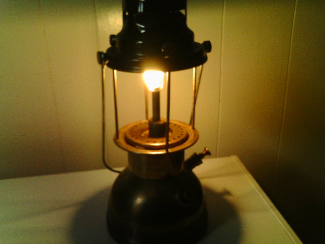

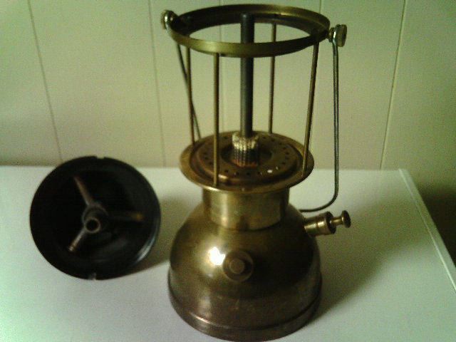

    now that is very nice ;if it was mine i would also leave it that way 'as most are worth more in value not touched or lite ;good news is i was able to get mine fired up earlier today but it seemed only half of the mantle was bright from the middle to the bottom it wasnt very bright even after i pumped it more ;the top got brighter ;might be i used the wrong mantle so tomorrow im going to fiddle with it again after awhile it started to flicker so im sure some where there is a small pressure leak;;as i was looking at the diagram i noticed on the vaporizer there is suppose to be a mantle holder really dont know what that is as mine dont have that part;so now the hunt is to find the correct globe plus that one part plus the small leak which could be either the fuel cap seal or the NRV but tomorrow is another day ;yep i know im going to get my butt chewed again as the pictures are the wrong size;seems its true you cant teach a old dog new tricks ;so here they are and yep i wait for a butt chewing ;)

    BTW, I can see the mantle holder (or 'burner spigot' as it's sometimes called) sticking out of the bottom of the burner. You obviously found it too, because you've tied the mantle onto it. Apart from the globe, nothing appears to be missing...

    i knew i did wrong again but in time i will get it and thanks for letting me know thats the correct part ;it doesnt seem to glow very birght as my others but that might be due to the wrong mantle please bear with it as i will one day get pictures correct ;trial by error' dean
