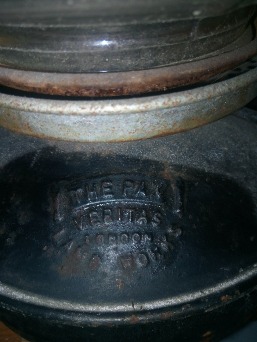

    Well just goes to show this forum is a font of knowledge.... Ive had this hanging with the other lamps for years, never paid it much attention LOL...
  15. Tony Press
    6,165
    Andy
    That’s a Veritas wick lamp.
  16. Andy-H United Kingdom
    May 20, 2019
    55
    Kent uk
    Morning,
    I know. In my quest to learn more about lamps in general ,when I see a make I've not heard of before I Google it.... The photo that comes up when you look for the 350 is the wick lamp I have!
    Never really took much notice of it before but I have now

    Veritas wick lantern, hummm... somewhere in this god forsaken garage I call a "work shop" (should call it something else) I believe I have one of these wickies. Mine is green and has the original globe. I know I've had it probably 25-30 years! At the time I never heard of a Veritas lantern wick or pressure. The pressure lantern(s) I don't any examples. I've got to learn how to post pictures here, like Confuscious said, "One picture is worth a thousand words".
