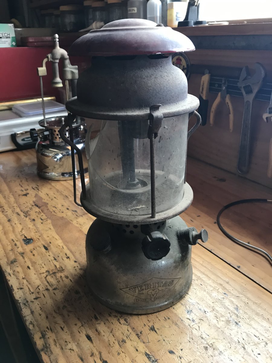

I was out today minding my own business when wandering in a junk shop this beastie jumped out at me. It has the original globe, but alas, it’s broken. All the correct parts are present and the tank, on inspection, looks to be sound. Anyway, I studiously ignored it, but it’s constant whining and pleading won me over. So I parted with $40 Australian, and now it sits in my workshop. This is all @ColinG and @Norman fault. Seriously, I’m as happy as a pig in ........ fertiliser. It’s now on the top of the fettle list and I’ll attend to it when I return from Norfolk Island. Cheers Pete

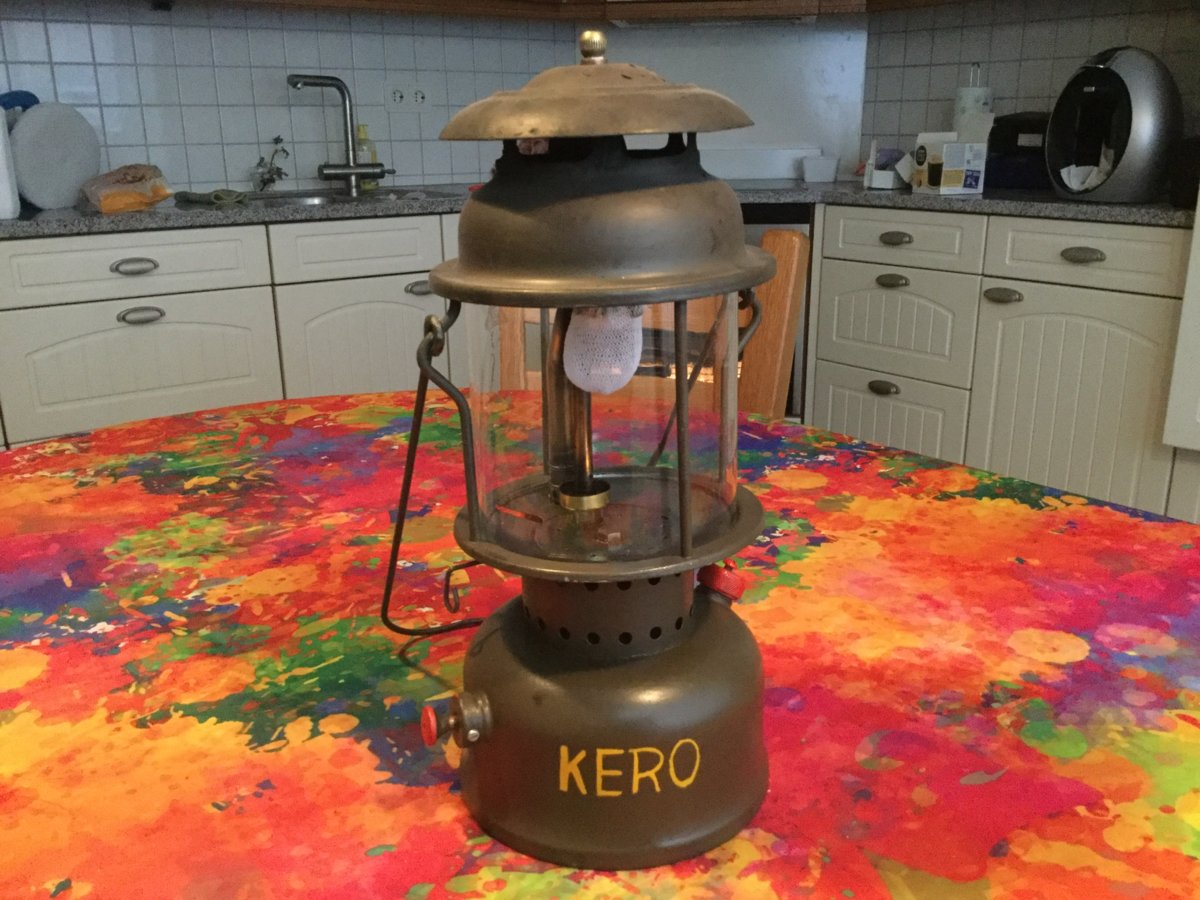

@ Aussie Pete : looks nice ! happy fetteling , love to see pictures of your Veritas overhauled. Here’s a picture of the ‘ coleman fuel ‘ Veritas 350 version I have that was used in the 50’s in our dutch army. Please note that a soldier has painted the word ‘ kero ‘ on it but that’s not correct ! Greetz from the Netherlands, Tjerk
Hi Pete, This one should clean up nicely. If you have a Dremel Tool and a Diamond cutting wheel for the Dremel you can shorten a Coleman 220 glass globe to fit the Veritas 350. For a job like this I prefer getting a replacement 220 glass from American Mantle because these are unmarked. These American Mantle glass globes also cost less then the Coleman 220 glass. Globes I hope this information helps a bit. Cheers, Norman

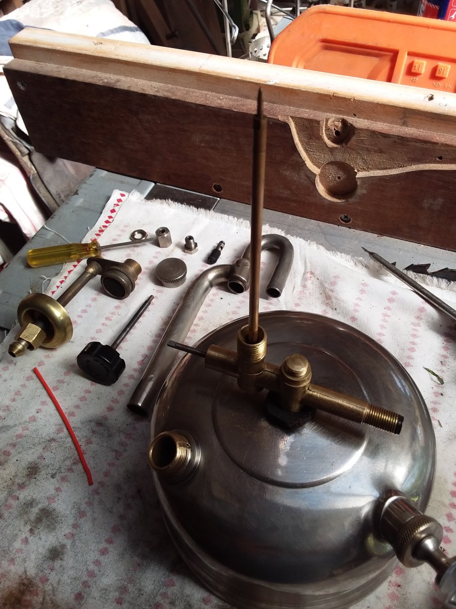

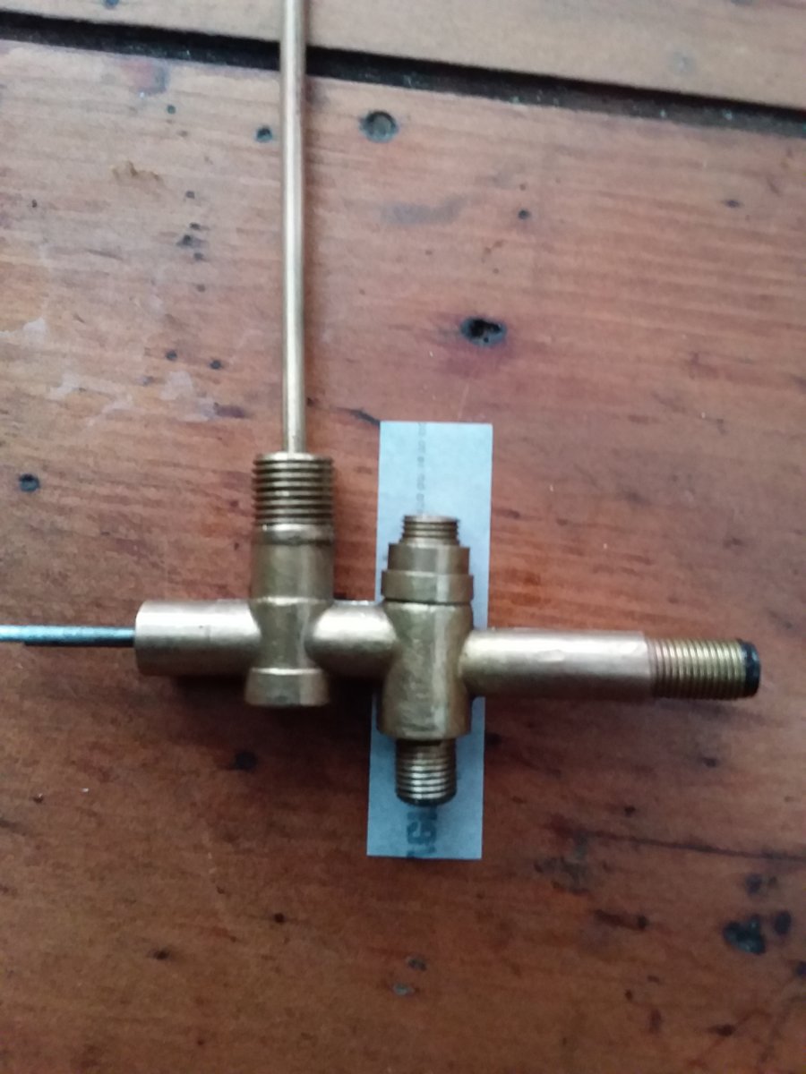

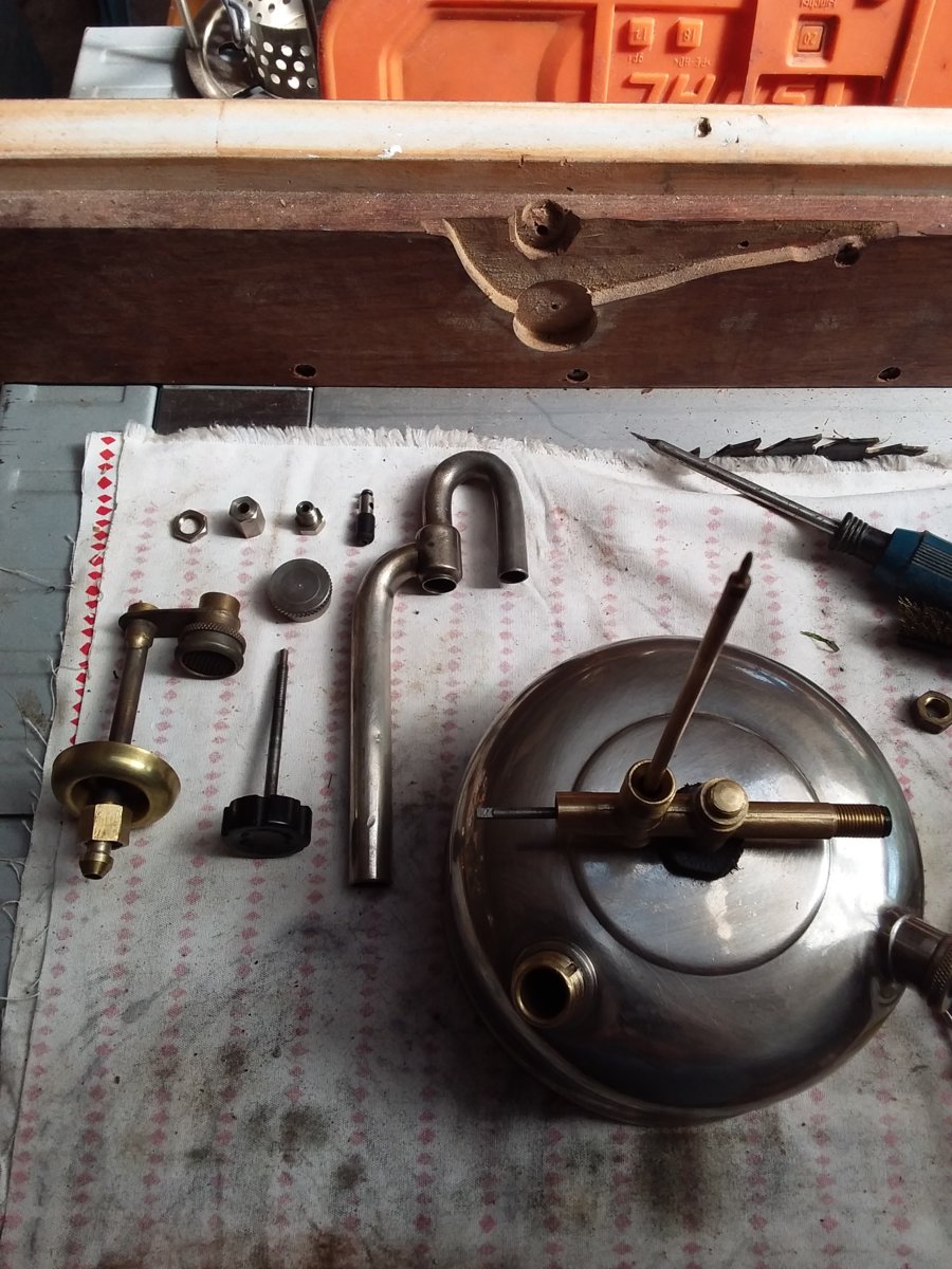

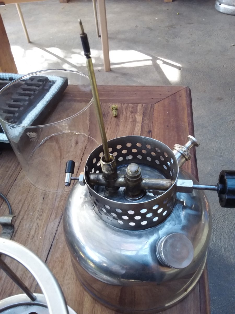

Cheers Pete. More dramas. I'm not getting any jet or flow up the vapouriser tube... nothing's jetting out of the nipple etc. I've pumped the thing, but not sure if it's holding pressure, but cannot visualise nor hear any leaking air. If it is in fact leaking, will this completely inhibit the vapouriser from actually drawing up fuel? I've thrown a photo of the disassembled parts and I'm wondering if any of these, or all of these, threads could be the culprit. I've screwed the main valve back on the fount with a makeshift leather washer... could this be the problem?

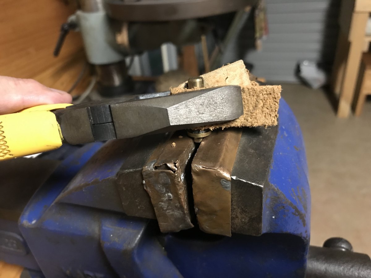

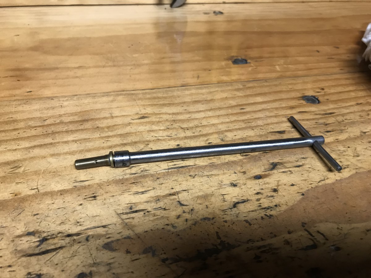

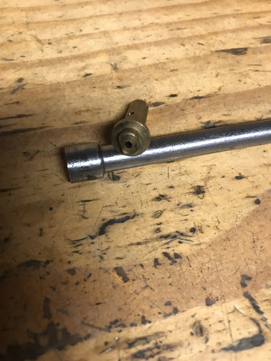

Hi @Damien The first thing to check is that the pump is actually pumping air. I do this by ensuring that the fuel valve is closed taking off the fuel filler cap and placing a thumb over the opening as a seal. I then operate the pump for about 10 pumps. If the pump is actually pumping, when I remove my thumb, air is heard escaping. If no air escapes, check the pump leather is sealing and oiled. Then the NRV (Non Return Valve located in the bottom of the pump tube) needs to be checked. Quite often, as in my case the NRV was leaking and allowing any pumped air back out after each stroke thereby not allowing air into the tank. To remove the NRV, a tool can be purchased from Juliands, via eBay. Alternative a largish steel bar with a 5mm slot cut into the bottom may be used. The slot has to fit over the NRV’s head, the snugger the better. Unscrew the NRV. (lefty loose, righty tightly). Once the NRV has been removed and cleaned, soak it in penetrating oil for a while and then place it in a vice that’s gripping the NRV’s head, firmly not too tightly. DO NOT ATTEMPT TO UNSREW THE BARREL FROM THE HEAD USING THE SCREWDRIVER LOOKING SLOT IN THE END OF THE NRV BARREL. THE NRV WILL BE DESTROYED. Using a pair of pliers and a strip of leather or rubber, grip the NRV’s barrel and with moderate force unscrew the barrel. You will find a spring and a brass carrier with a pip inserted inside it. The spring and carrier must be cleaned and must move freely within the barrel’s bore. The pip will need to be replaced. I use a pip punched out of a sheet of 3mm Viton, bought from eBay. With the serviced NRV replaced, repeat the earlier air pump test. You should have air escape when you release your thumb. If not then I would now replace the fuel cap seal. You can make one from Viton rubber or temporary use a O ring or another gasket. I would now remove the valve fuel pickup assembly from the tank. Ensure that the pickup tube is not buried in sludge at the bottom of the tank. With the valve open you should be able to blow through or suck through air. If not then it’s blocked. Diluted citric acid or vinegar can be used also a wire pricker to try to clean out the obstruction. I actually use a ultrasonic cleaner to do this job. I then, after checking that the assembly is clear by sucking one end, screw the cleaned assembly back into the tank using a pipe sealant on the threads for a good seal. On mine, I didn’t replace/use a gasket. After the valve assembly has been cleaned, cleared and installed ensuring that the pickup tube is clear at the bottom, the NRV has been serviced and replaced and the fuel cap has been made air tight, the pump’s leather oiled, you should now be able to pump up the tank. Hope this helps. Let me know how you go. Cheers Pete

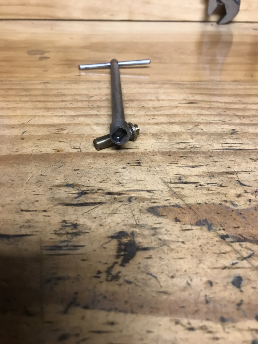

Or use a loose drill chuck. I have found this the best way to grip a NRV barrel (and lots of other parts).
The slot at the top can also be used with a screwdriver if you fix the other end in the vice as shown.
@Nils Stephenson thats a good clue. I never thought of gripping the NRV in a drill chuck. It’s now my preferred method. Thanks for sharing. Cheers Pete
Hi @ColinG Yes, it can be done, however I tried it once and watched in dismay as the torque shredded the barrel. The main cause of the lamentable destruction was that the barrel had seized onto its thread and my commensurate Herculean grip of heroic gusto. Of course, obeying the law of all small and important things, it’s was the only one I had at the time. I like the method Nils has shared and it’s going to be my preferred method. Cheers Pete

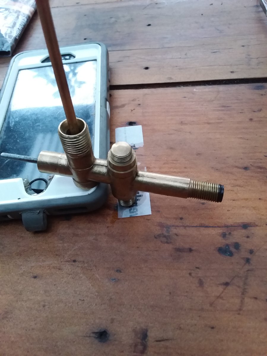

Been out at my little property near a town called Neville, NSW. Only mention it because I haven't been able to thank Pete, Nils, et al. due to the fact there's no service of any kind out there. Eternally grateful for this, and every other thread. I didn't even know that this part existed... and that's AFTER looking at the diagram in the reference library! So is the actual Non Return Valve inside the mixing valve that screws into the fount?
