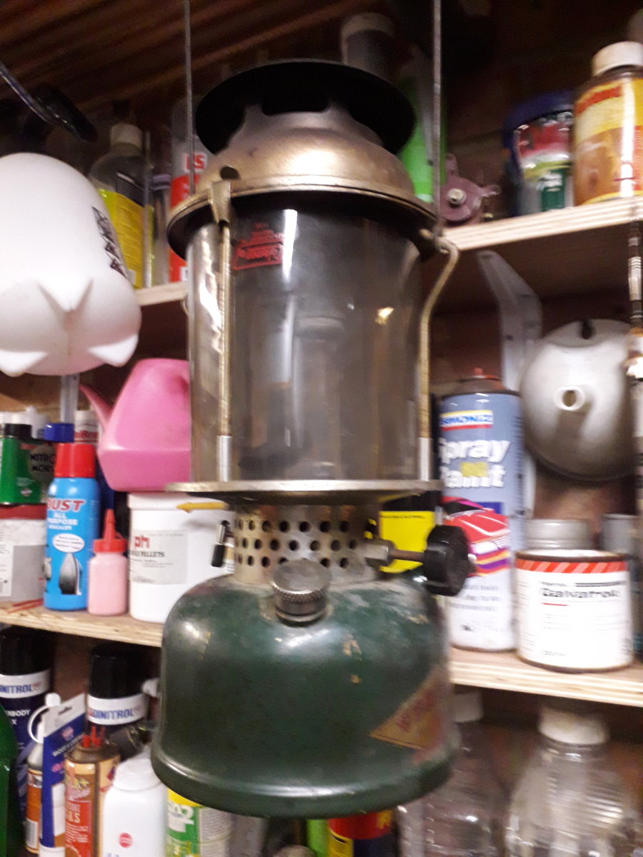

  11. oily rag United Kingdom
    Jul 30, 2018
    6
    bournemouth
  12. X246A
    306
    Norfolk, England
    @oily rag
    Your Veritas is a nice looking lantern. She may be a shelf queen at present but parts do occasionally turn up.
    Thanks for sharing the photograph.
    Regards Jeremy

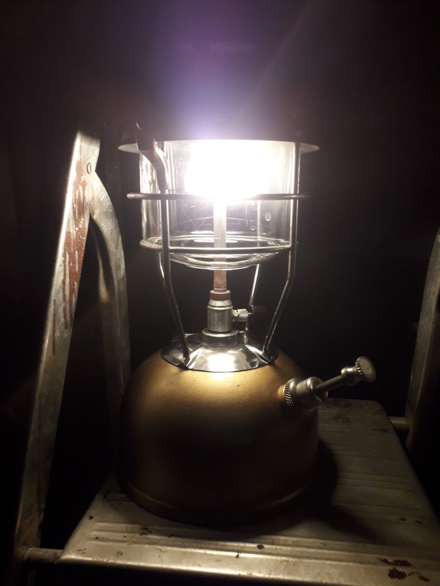

  13. oily rag United Kingdom
    Jul 30, 2018
    6
    bournemouth
  14. oily rag United Kingdom
    Jul 30, 2018
    6
    bournemouth
    jeremy, heres my new lamp after a bit of cleaning. i cant wait to use it on an outing. ive never had alot of luck with pressure lamps til now. i think now i can see how good they are, i shall certainly be using them often. that old veritas actually did me a big favor as an introduction to lamps. many thanks for your positive encouragement.
