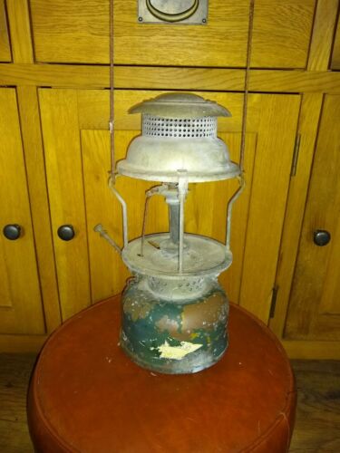

    Hi, Thanks to all for your advice. I have now ordered a sheet of fine brass mesh, which has not been that easy from France - UK suppliers seem to be quite resistant to sending things "abroad" and, if they will, it is at quite a cost. The alternatives, however, from Australia or China, although cheaper take a long time to arrive. So enough moaning, I will let you know how I get on when the mesh arrives. See attached photo of the lamp as purchased. regards
  9. AussiePete
    1,884
    @RoyBuchan
    In your picture, she looks to be a good fettling project. It’s a bugger sometimes about the things we have to do when obtaining parts, but that just adds to the chase ..... the quest.
    I’m looking forward to the story of the fettle and of course, the money shot.

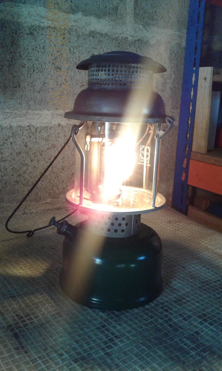

    So, after taking advice from several of you, here is a photo of the first proper firing. I inserted a roll of mesh into the vaporizer, which included about a inch of lamp wick at the base which sorted out earlier problems although there is a little bit of flaring around the mantle, currently a Peerless 2C-HG. Still have to fit a replacement pricker rod but am pleased with progress. Thanks to all who gave advice.
  12. ColinG
    2,163
    It's looking good so far!
  13. AussiePete
    1,884
    Well done, she's definitely a worker. You're very nearly there.
