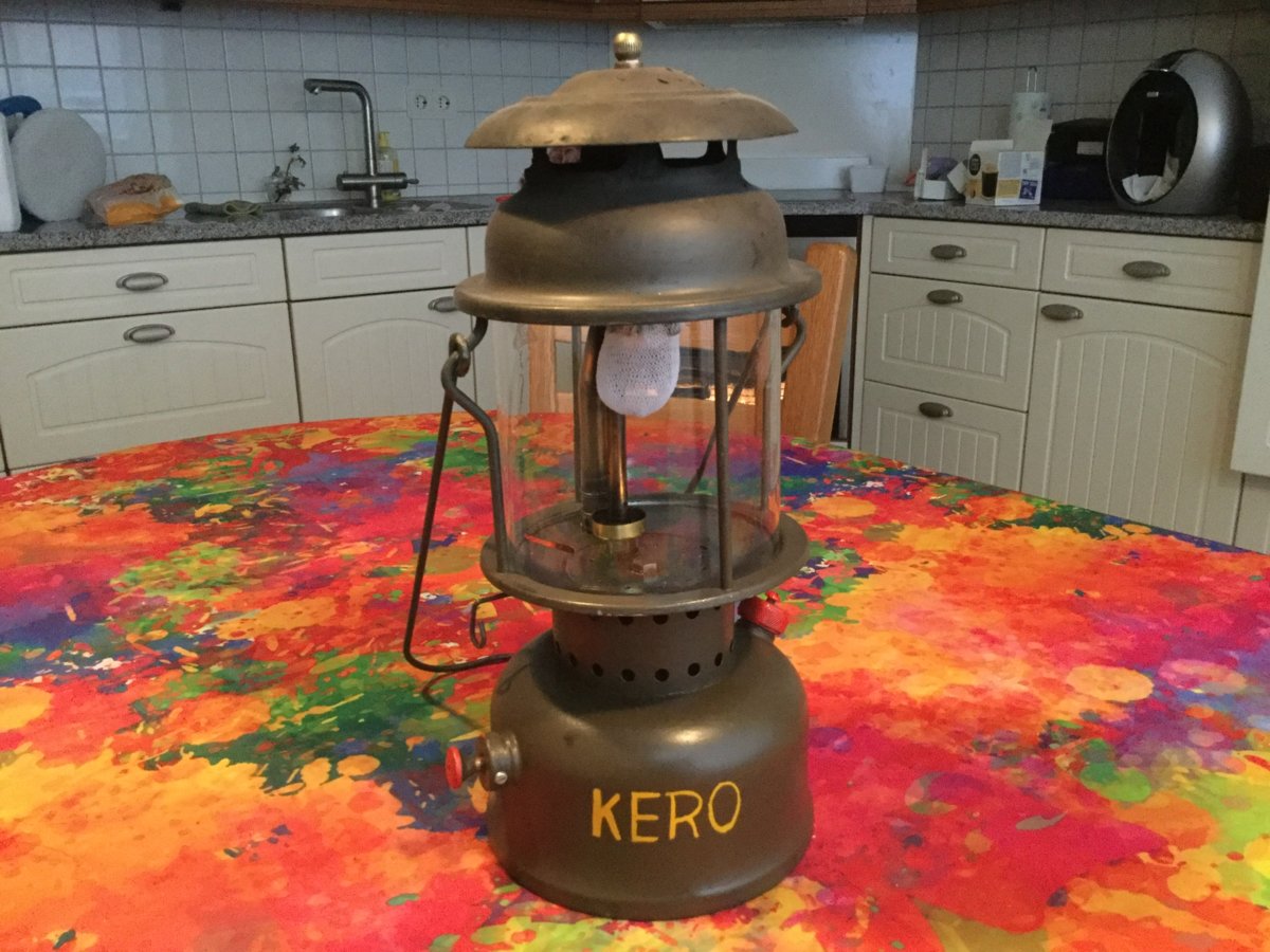

  7. Tjerk
    May 17, 2016
    24
    Veenoord, Netherlands

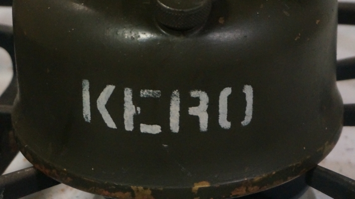

    @Norman and Darryl
    as you can see... my dutch P 350 has also the ( wrong ! ) word KERO painted on.
    Runs very well on Coleman fuel but I fill her up with a liquid called ‘ wasbenzine ‘ , stuff you can buy cheap in every supermarket all over the country here.
    And yes, it has a cup, in the beginning I was wondered about it but use it every time now before lightning the lantern.
    I changed the original globe for a MEWA ( East Germany lantern DDR made ) one.
    Advantage : it has a hole in it (easy filling with meth !) so I can lit my cup at an easy way with a long match.
    Preheating the generator results in a start with no flames coming out of the hood such as all my Coleman lanterns do !
    Cheers from the Netherlands,
    Tjerk

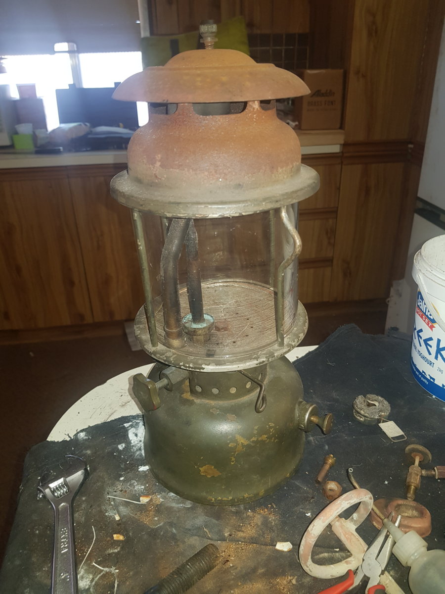

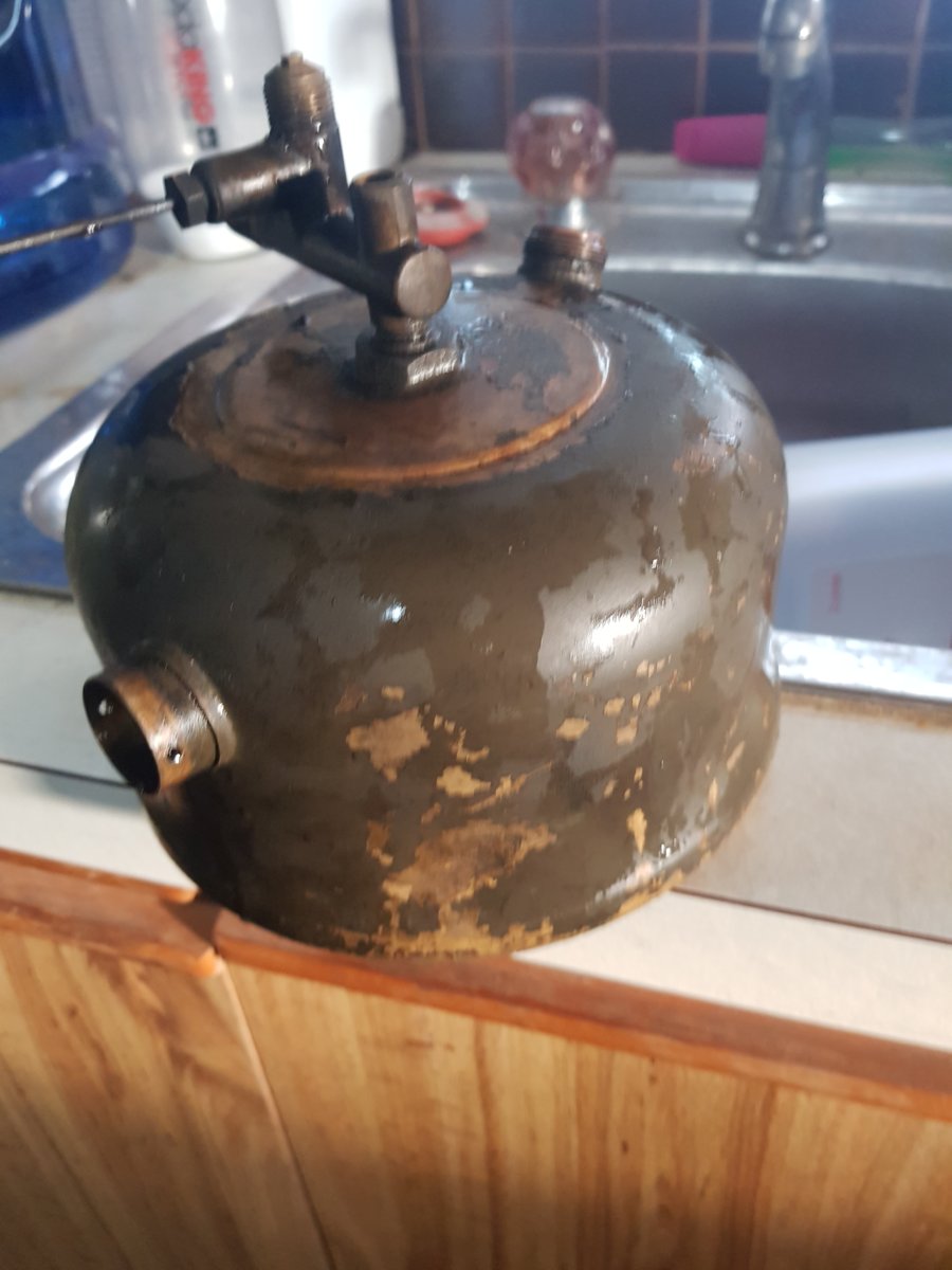

  8. Darryl Durdin
    1,013
    thank you Norman for your information and tips on this lantern,
    the paint work on mine is not good so im going to re do it, the burner frame has what looks like green paint on the frame housing but the center of the plate is flaky silver and some rust, all the other bits just need a wash and clean up. the lid is good but the rim where the globe sits is burnt/ rusted, I was thinking of painting it with high temp paint black , or just leave it

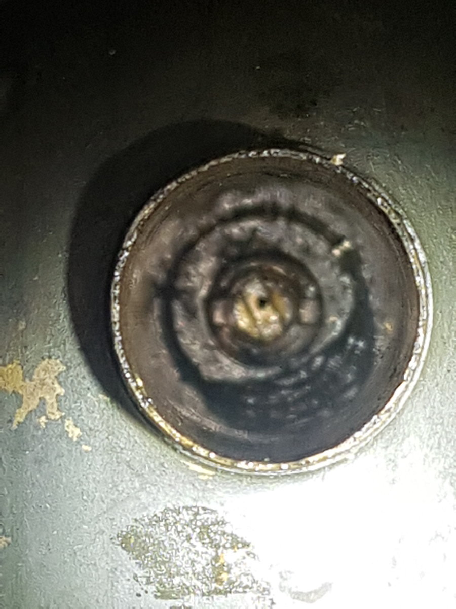

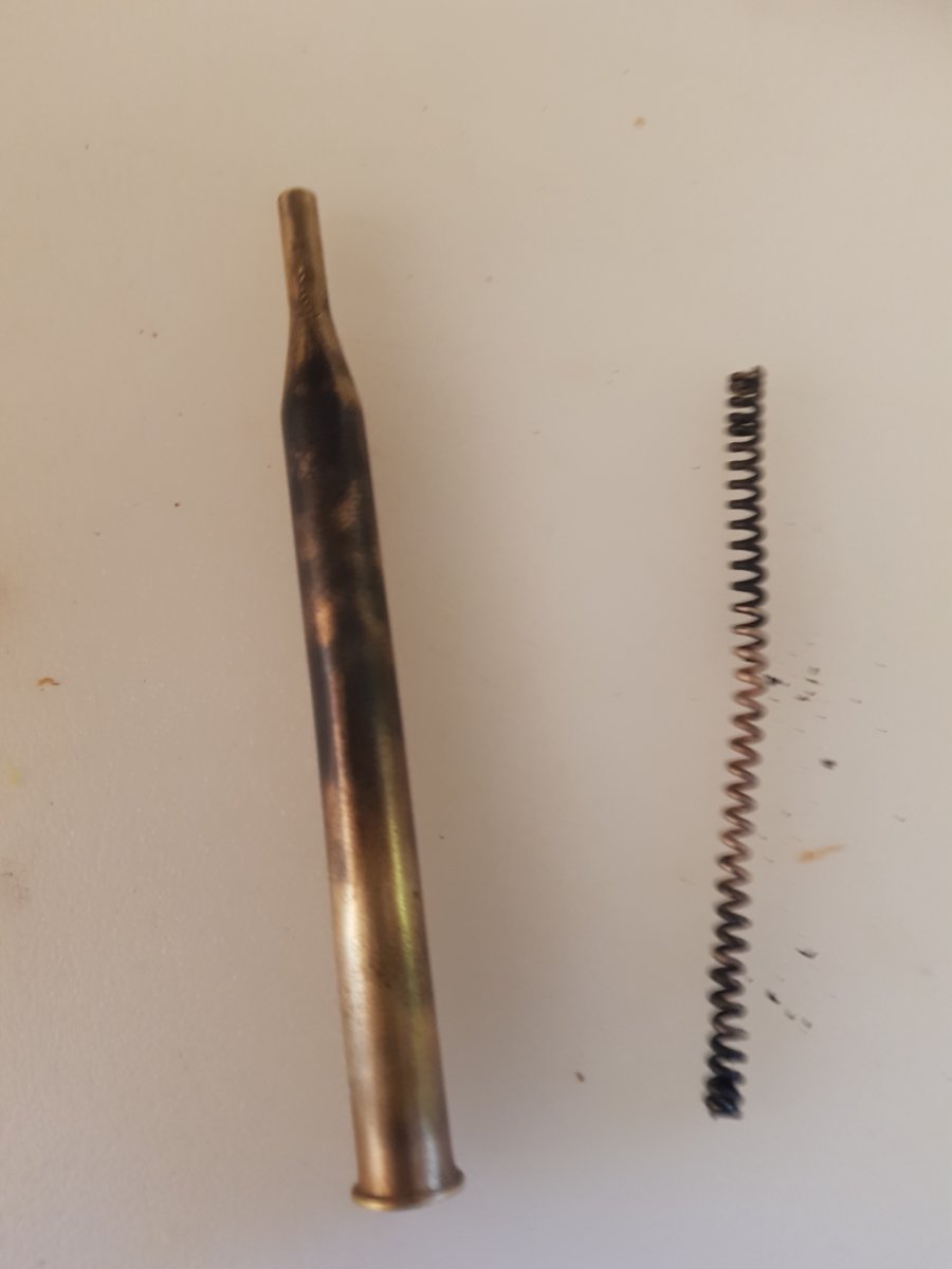

    Hi fellas, can you tell me
    What is inside the vaporisor.
    Should it come out.
    The curly wire thing came out after i heat and quenched a few time.

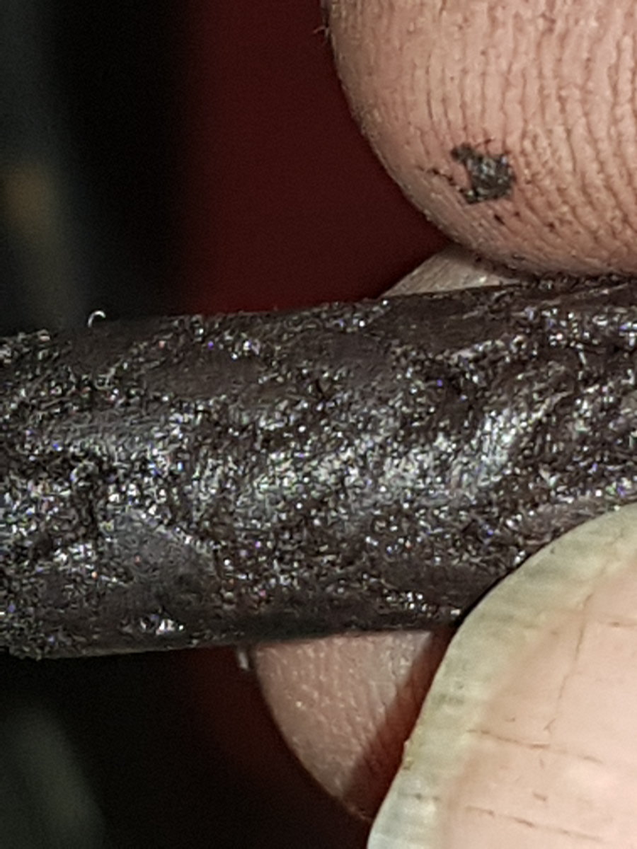

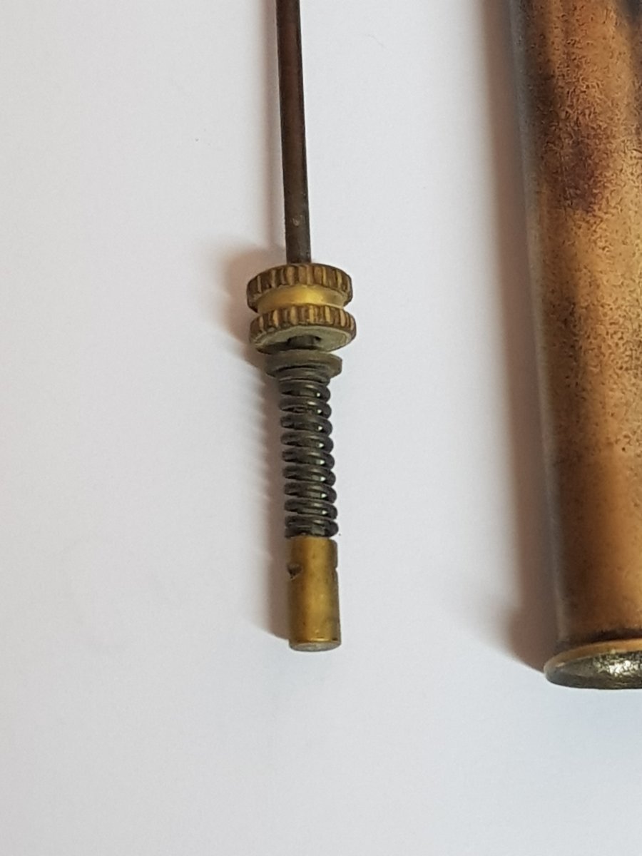

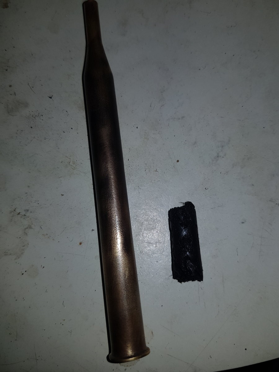

  13. Darryl Durdin
    1,013
    This is inside the vaporiser?
    Any idea, i know its some sort of restrictor, but should i clean it? I have no idea, it looks caked in burnt residue 20200227_150311.jpg 20200227_150416.jpg
  14. Norman
    Jul 1, 2011
    660
    Spokane, WA
    Hi Darryl,
    Some of the manufacturers used asbestos in their vaporizers and this could be the remnants. If the previous owner used Petrol/Auto Fuel then what you are holding is exactly what you will find. Personally if I were you I'd dispose of what you are holding and use some brass mesh inside the vaporizer tube.
    Cheers,
    Norman

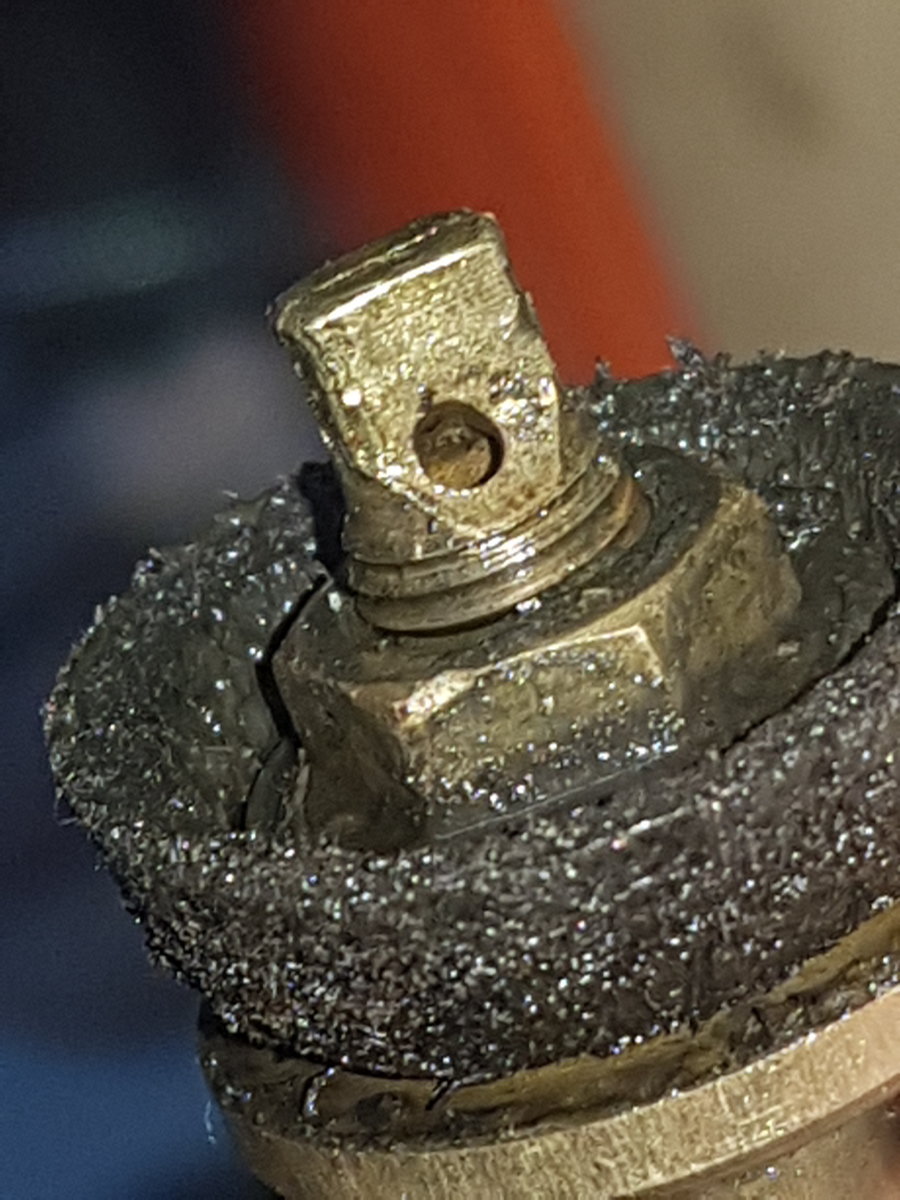

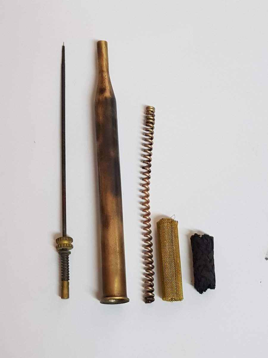

  17. Darryl Durdin
    1,013
    This is what is inside the generator.
    The old bits black aspestos what ever
    Replaced it with fine brass mesh
    The pricker and rod seem to work and look abit like inside rod of a tilley vaporisor 20200228_093208.jpg 20200228_093235.jpg

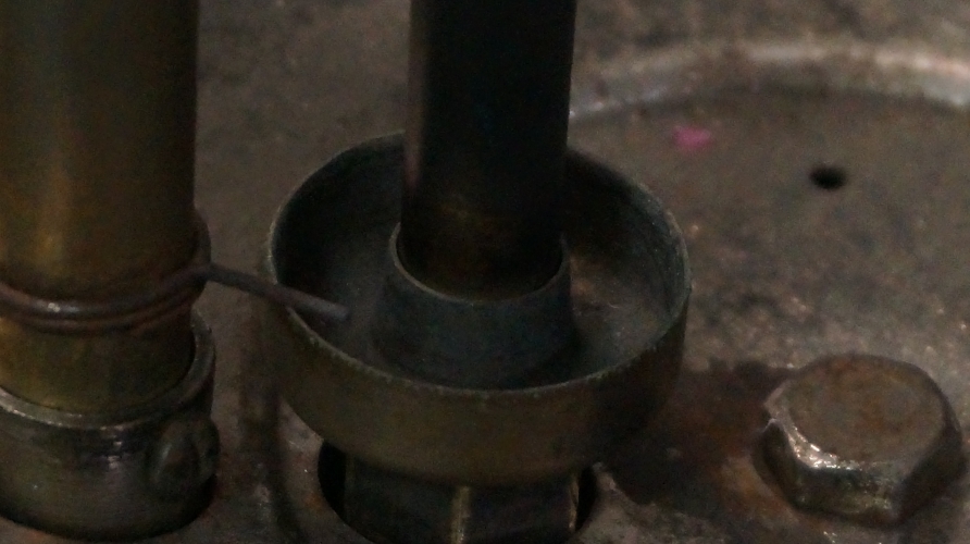

    Photo : Homemade cup in my Coleman 220 F
    Greetz from Holland,
    Tjerk
