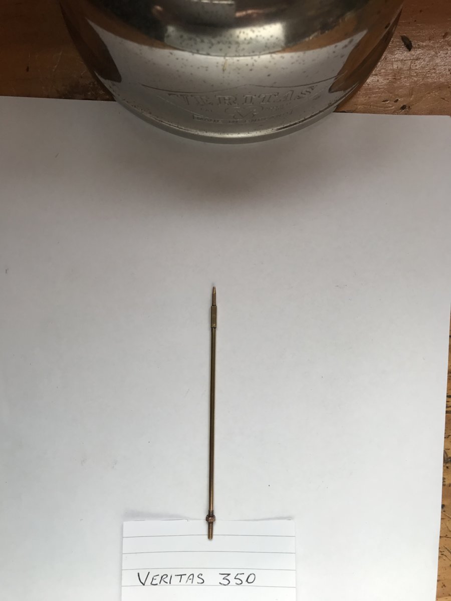

    Those of us who fettle or have fettled Veritas lanterns are often faced with the pricker wire damaged or missing.
    To my knowledge there are no “off the self” replacements. Usually, any replacements require modifications to similar prickers from different makes of lantern to fashion a workable replacement.
    The other alternative is to fabricate a new pricker replacement from scratch.
    The following is the story of my fabrication of a new pricker replacement for a Veritas 350 lantern.
    First of all, the crime scene .....

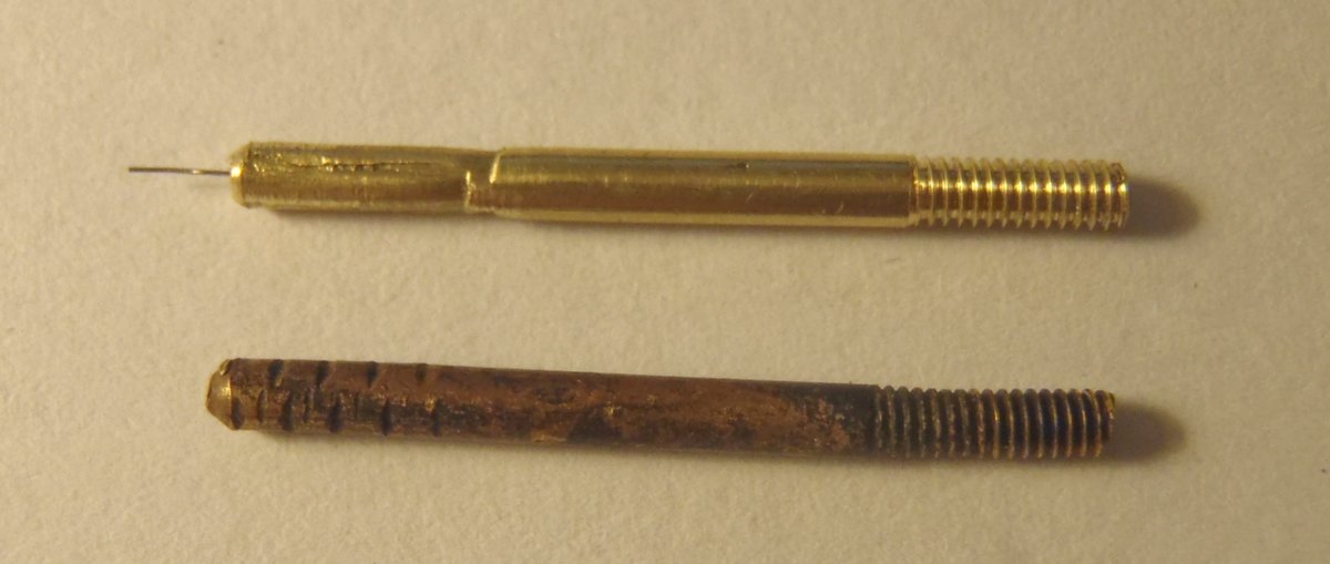

    The above photo shows the tip of the pricker wire is missing, an all too familiar discovery while fettling these beasties.

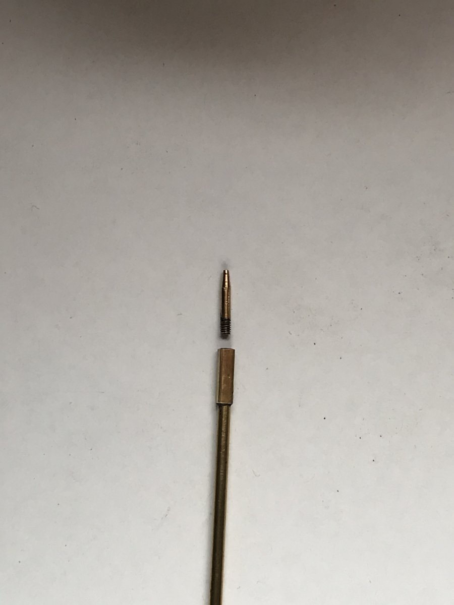

    The broken pricker can be unscrewed from the lanterns pricker rod, as seen in the next picture.
    The thread of the pricker head is a metric M2.0.

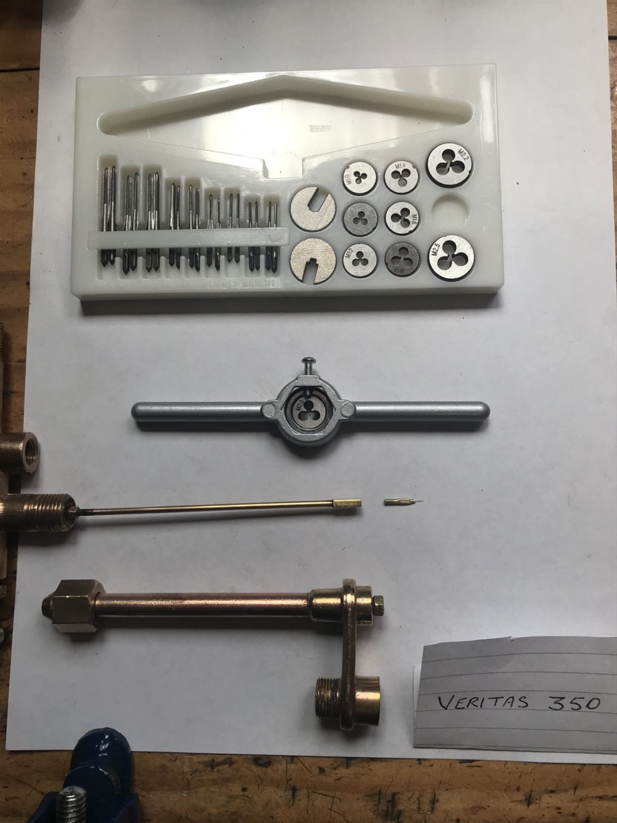

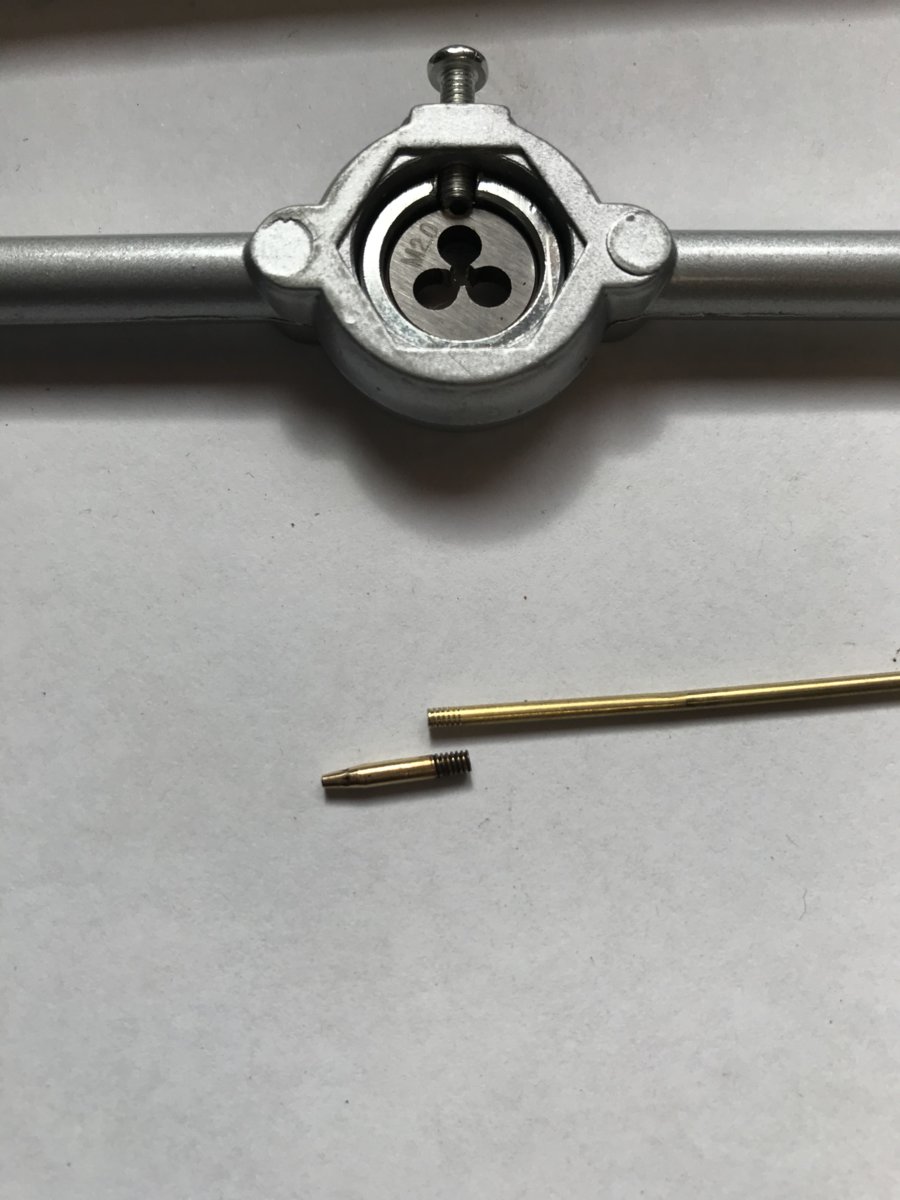

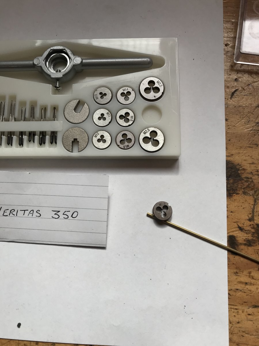

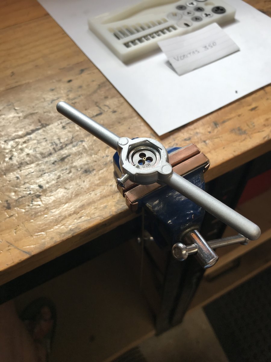

    I sourced 1/8” brass tube from a hobby materials supplier. The benefit of the 1/8” brass tube is that it’ll take a 2.0 mm thread, and because it’s a tube, I can insert the new pricker wire inside.
    The brass tube took the thread very well as seen below. Whilst being threaded, the 1/8” brass tube was held in my miniature vice, using copper keepers on the jaws.
    The new threaded tube shown along side the original broken pricker.

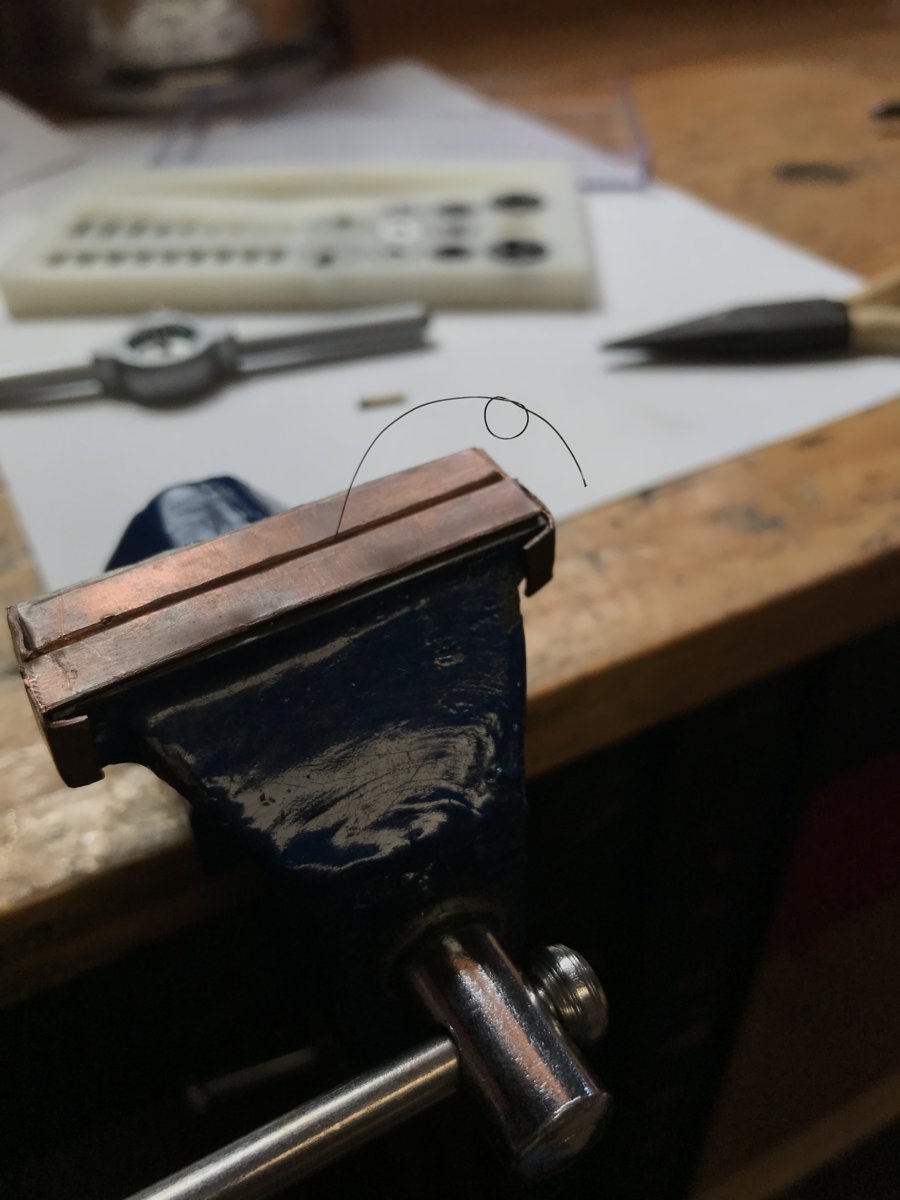

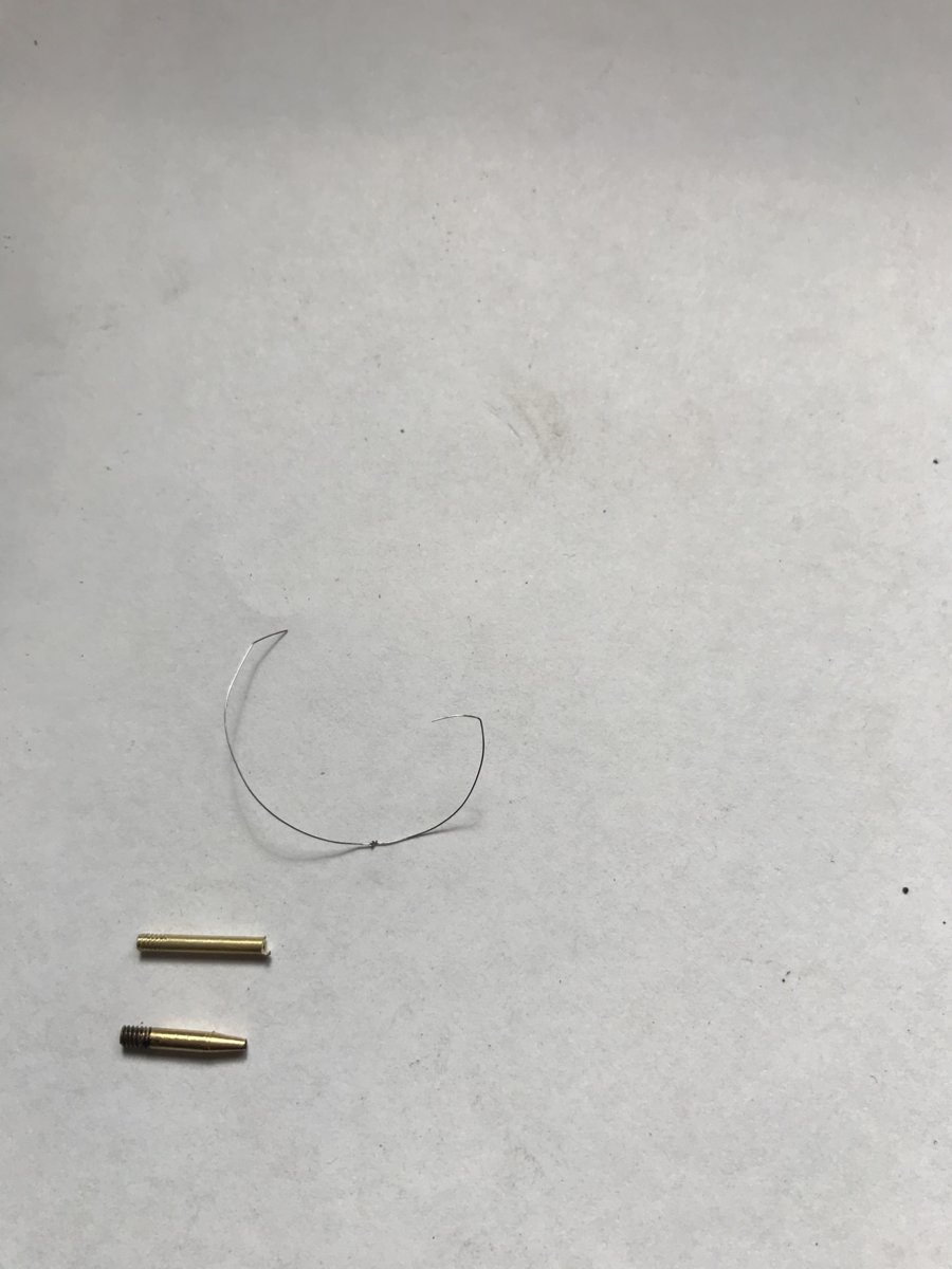

    A .0006” stainless steel wire was then selected and a knot tied into its middle. This knot will be crimped within the pricker tube thus preventing it from being pulled out.
    The new pricker unit was then cut from the brass tube stock. The knotted pricker wire is shown ready for assembly to be crimped within the new pricker’s brass tube using the vice.
