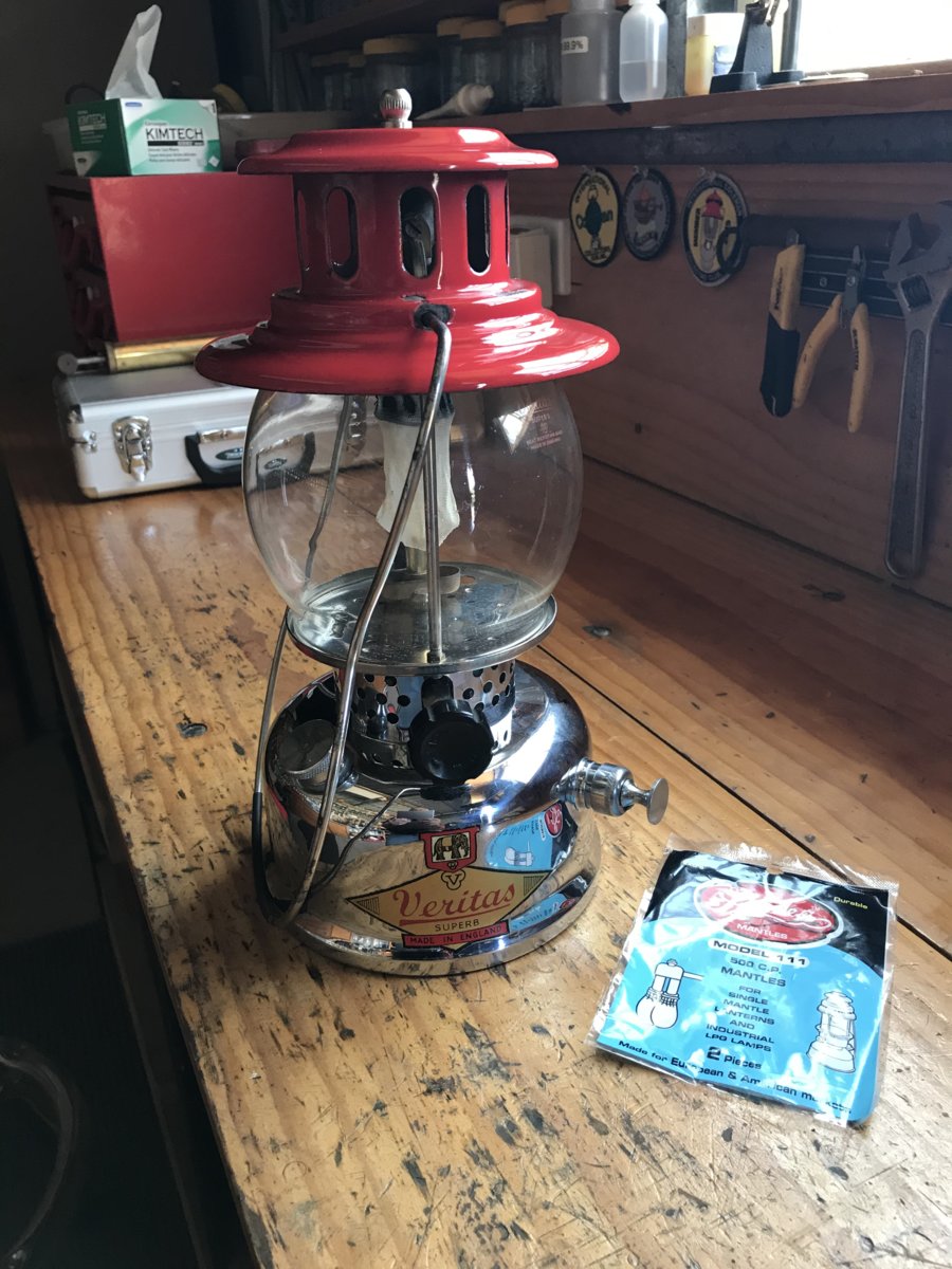

    Hi All
    Not so long ago I purchased , from an Aussie collector, this near mint Veritas Superb.
    Today, after being inspired by my mates @Norman and @ColinG I checked her over with a plan to lighting her.
    It is in exceptional condition and it only needed the NRV pip and the generator’s washer seal to be replaced and the leather pump washer lubricated with neats foot oil.
    I used a Peerless model 111 mantle because it’s bigger and longer providing adequate heat to the generator.
    I used only kerosene as the fuel. The fount was pressurised with about 20 pumps of air, the preheater was charged with methylated spirits and lit.
    Just before the last of the methylated spirits burnt off I opened the fuel control cock ......... and she elegantly and without any fuss ...... lit.
    I then put another 50 or so pumps worth of air into her.

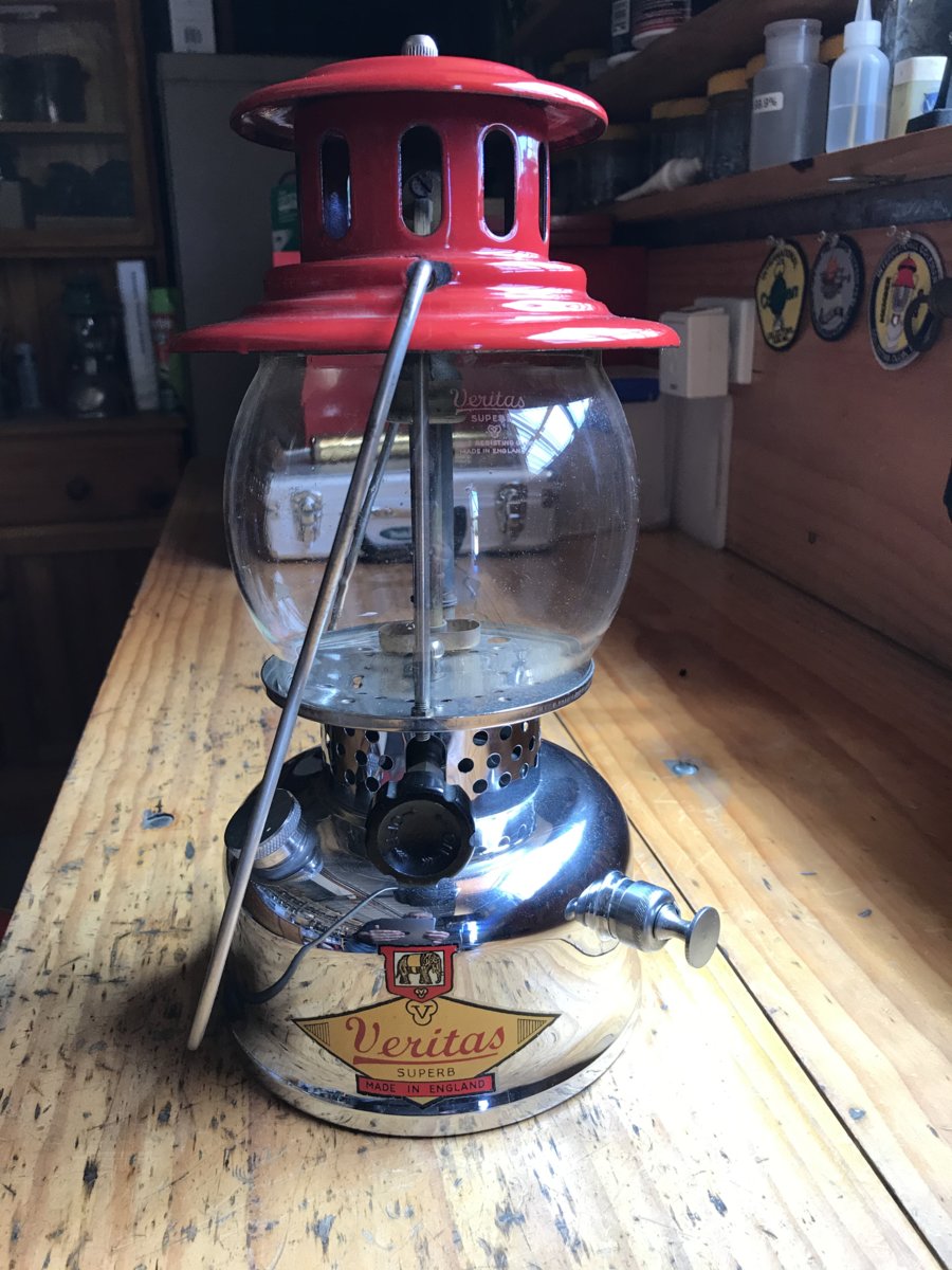

    The Money Shot
    Summary
    This lamp is an excellent example of the Veritas Superb. Further when lighting it, it behaved impeccably and was very easy to light.
    I’m aware that these lanterns have a negative reputation, however this lantern certainly doesn’t follow the reported errant ways.
    Note: This is the second Veritas Superb that I have that has no issues with lighting and running.
    This lantern needed little or no fettling other than the usual maintenance seal replacement. It’s a joy to light and I spent a wonderful hour, with a cold beer or two, watching it light my workshop, how good is that ............. :D/
    Thanks for looking

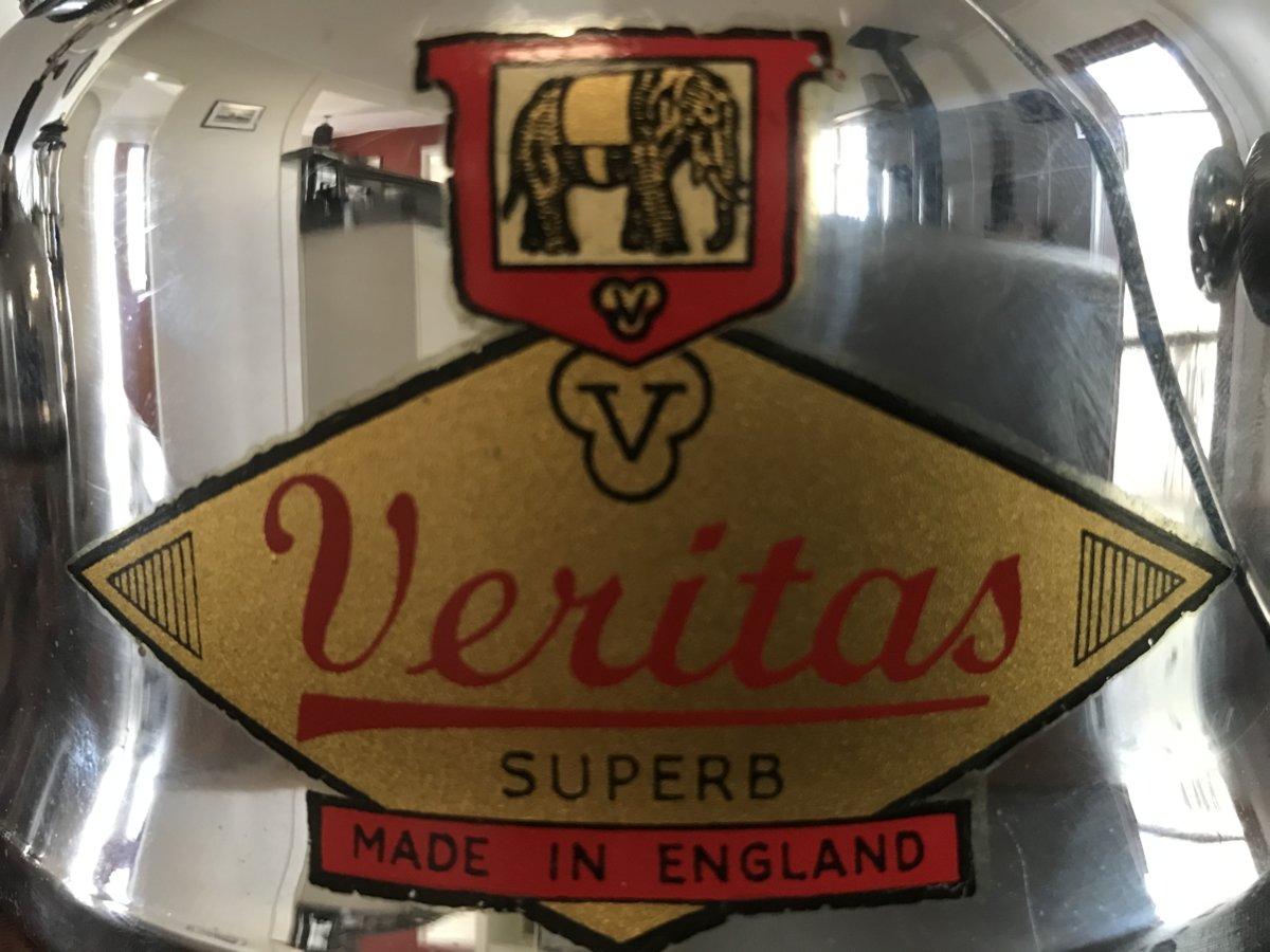

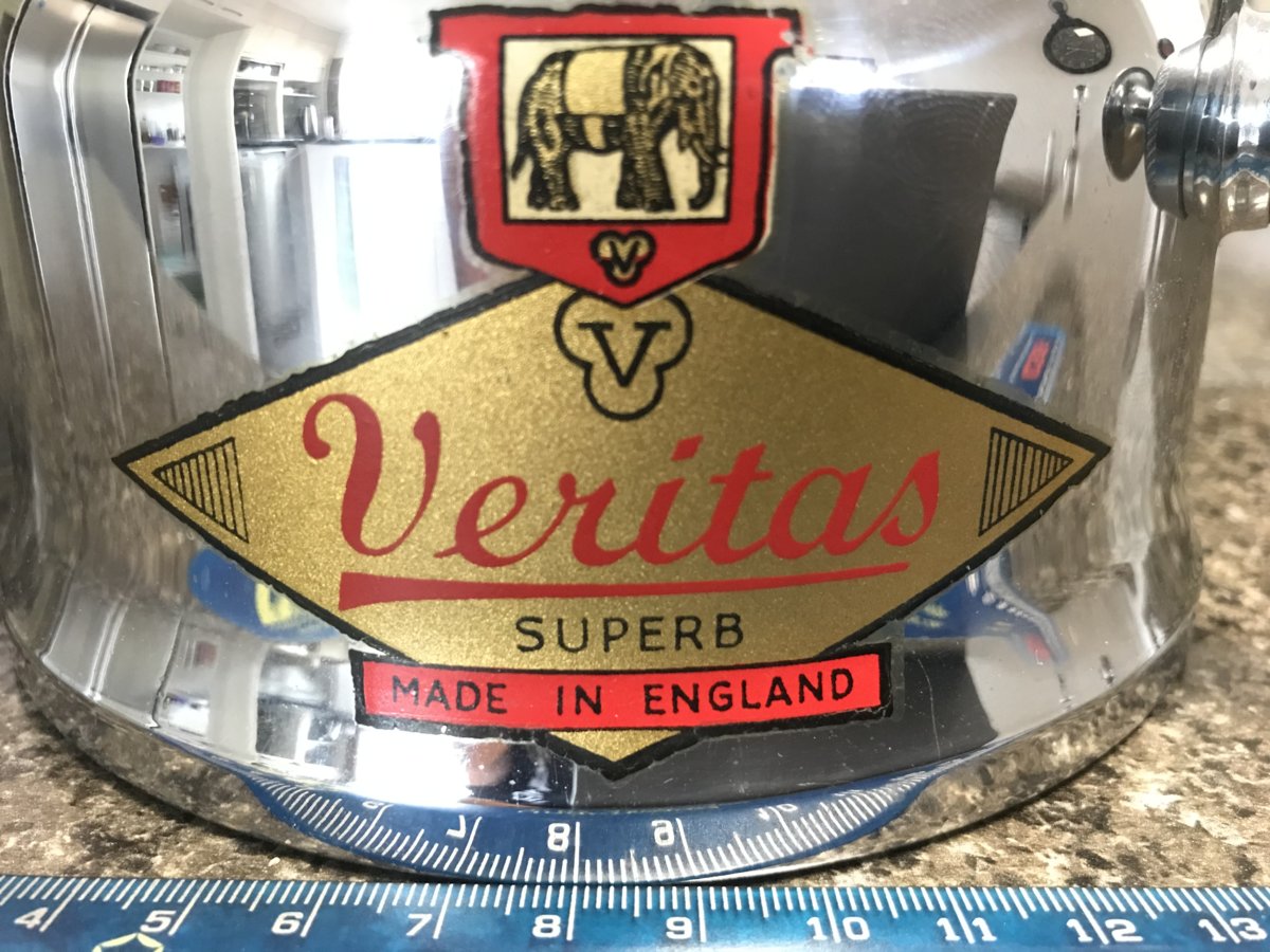

    Would it be possible to take a good quality image of the logo? I intend to have a new waterslide logo made but I need a photo for the guy who makes them - artypharty on eBay.
  15. AussiePete
    1,676
    @ColinG
    I’ll get on to it today, I’ll have a picture of the logo by this evening Aussie time.
  16. AussiePete
    1,676
    @ColinG
    Here are the pictures of the Veritas Superb logo.
    2 photos to enable your artist to see the detail and the subtle difference light has on the subject.
    The width of the logo is 93mm and the height is 58mm.
    01077445-50E6-4D6D-B703-961CD748BAB2.jpeg View attachment 71377 692AAC5D-2523-4518-895D-0B7CE472BE0B.jpeg
    Hope this helps.
