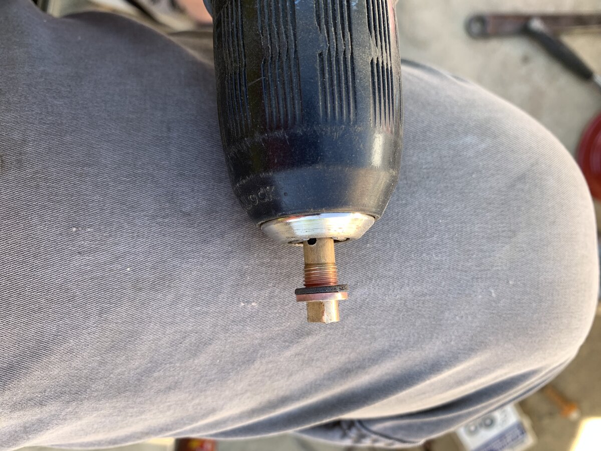

    I have a veritas superb that I’m fettling as I type and the NRV needs the pip replaced but can take apart the lower section of the NRV and don’t want to mess up so here is my question
    is the thread counterclockwise or clockwise?
  2. Henry Plews
    2,021
    The ones I have dealt with were all right hand thread so counterclockwise to take apart.

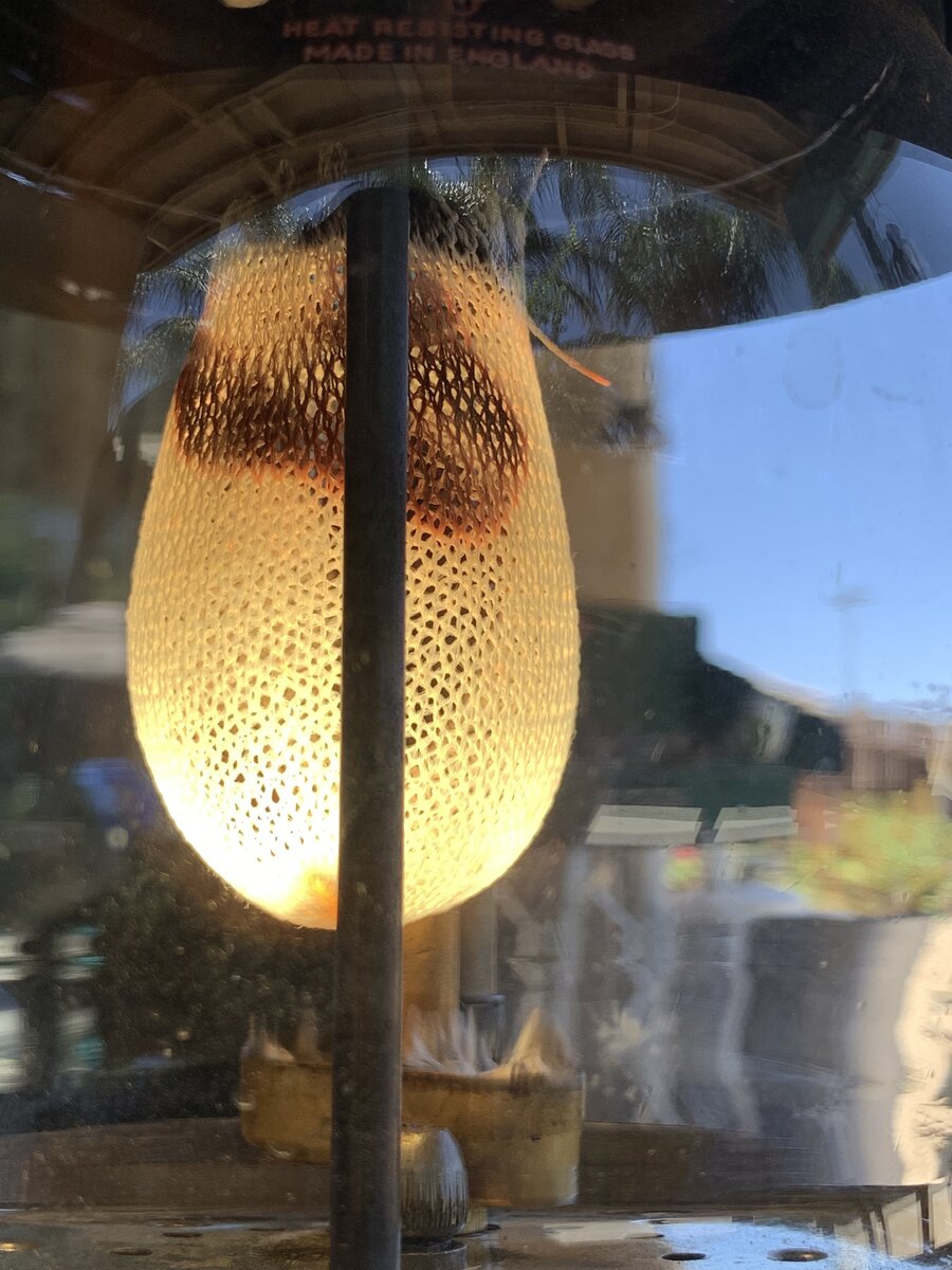

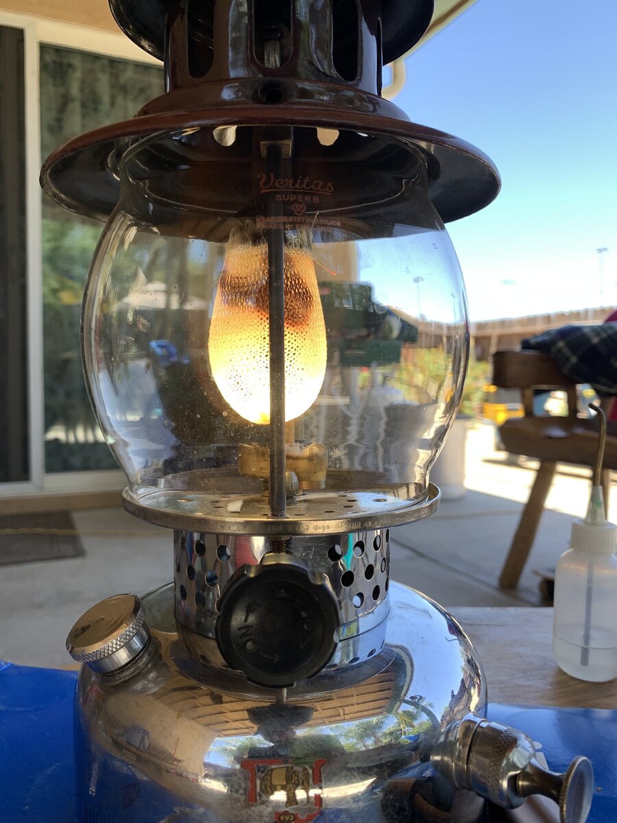

    Now I have another issue. Installed a 500cp mantle an getting over burn, deep cleaned the vaporizer also took it apart and still doesn’t want to work correctly and I’m getting frustrated lol
    here is a picture of the lantern burning
    0BF94761-6D67-464C-9249-B195FD3BEB27.jpeg 4F99CEB5-8E17-43BF-80E6-5587CB9BC23A.jpeg

    No halo with CF. So maybe oversized jet

  5. AussiePete
    3,368
    @Pancholoco1911

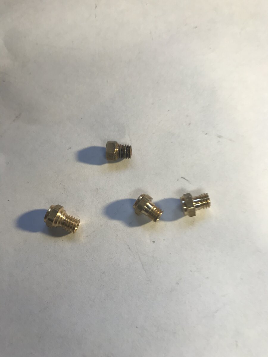

    Your jet is oversized. An Austramax jet will fit the vapouriser’s thread. You may need to turn, with a lathe, it down to suit the length.
    The top jet is the original. The jet on the bottom left is an Austramax jet and the 2 jets on the bottom right are the lathed results.
    You can still get Austramax jet’s from:
    Kerosene Presser Lamps Parts
    Hope this helps.

  9. ColinG
    3,722
    I just noticed the cork sleeve around the pricker control is missing. When it's been running a while that thing will get damned hot! I've never had to replace the cork myself but I'll have a think, see what I come up with.

    What tool did you use to remove this? Didmyou make something yourself?
