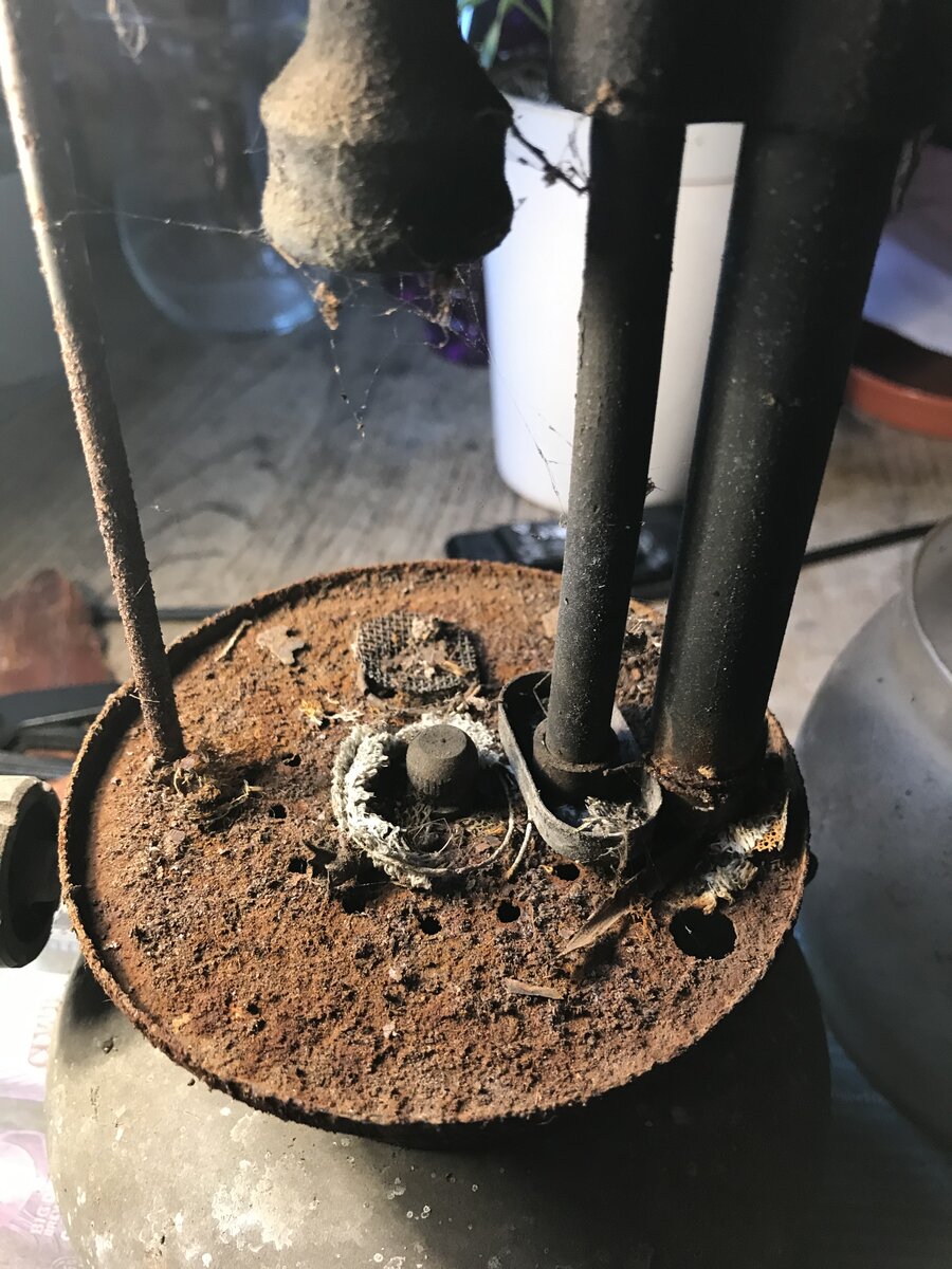

    Following the Primus 981 death wish and the Coleman 427 nightmare, here’s another nice wreck I’m just starting to tackle today. I think it’s a Veritas superb in brass (no nickel plating). I got it from a local salvage dealer a while back, along with a couple of Tilleys. Photos below. Please note the abundant collection of dead spiders, rust and dust inside it. Total dereliction?...
    I got a ‘154’ set of seals from the Fettle Box. Hopefully it’s the right set. Apart from taking everything apart gently, where would you start?!...:shock::roll:

    I was wondered where you had got to Alex. Well this looks like a challenge but from where I am looking it would appear a very viable resuscitation candidate. I guess it is going to come down to how much metal there still is on the bottom plate ! We all look forward to it's progress..

    I think I’d start with a long ponder and a stiff drink!
    As mentioned above, I guess it’s down to the level of corrosion. When I was a lad working in garages, we had a bucket of diesel for soaking corroded together objects in...

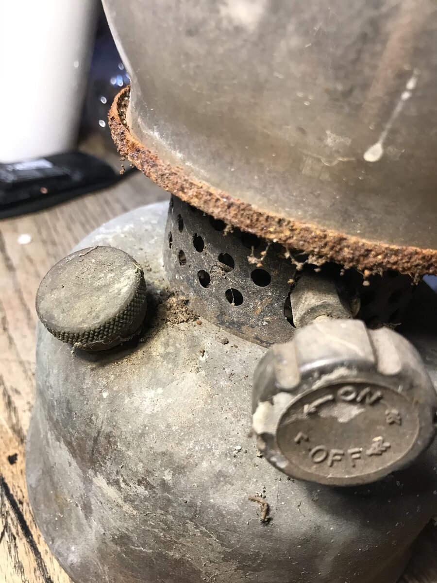

    Awww thanks guys. So progress already. I got it apart to find a pound of dust and rust, but guess what! It pressurises and old paraffin squirts out of the vapouriser! Maybe it’s not as bad as it looks. The steel (?) plate at the bottom of the cage is rusty but all solid. The lamp came with some residual manky fuel in it, so the bottom of the tank ( steel?) doesn’t leak. I’ve now drained it out and rinsed it with fresh kerosene. The glass cleaned up ok with hot soapy water.
    Can anyone tell me what the little ‘tube screw’ at the opposite side of the stop cock does? Is it just fir depressurising? It unscrews freely but doesn’t come off the valve....

    Hi there it is your pricker lever, it’s missing a tubular piece held on with a screw, if you find your lantern in the gallery you can see what it should look like,

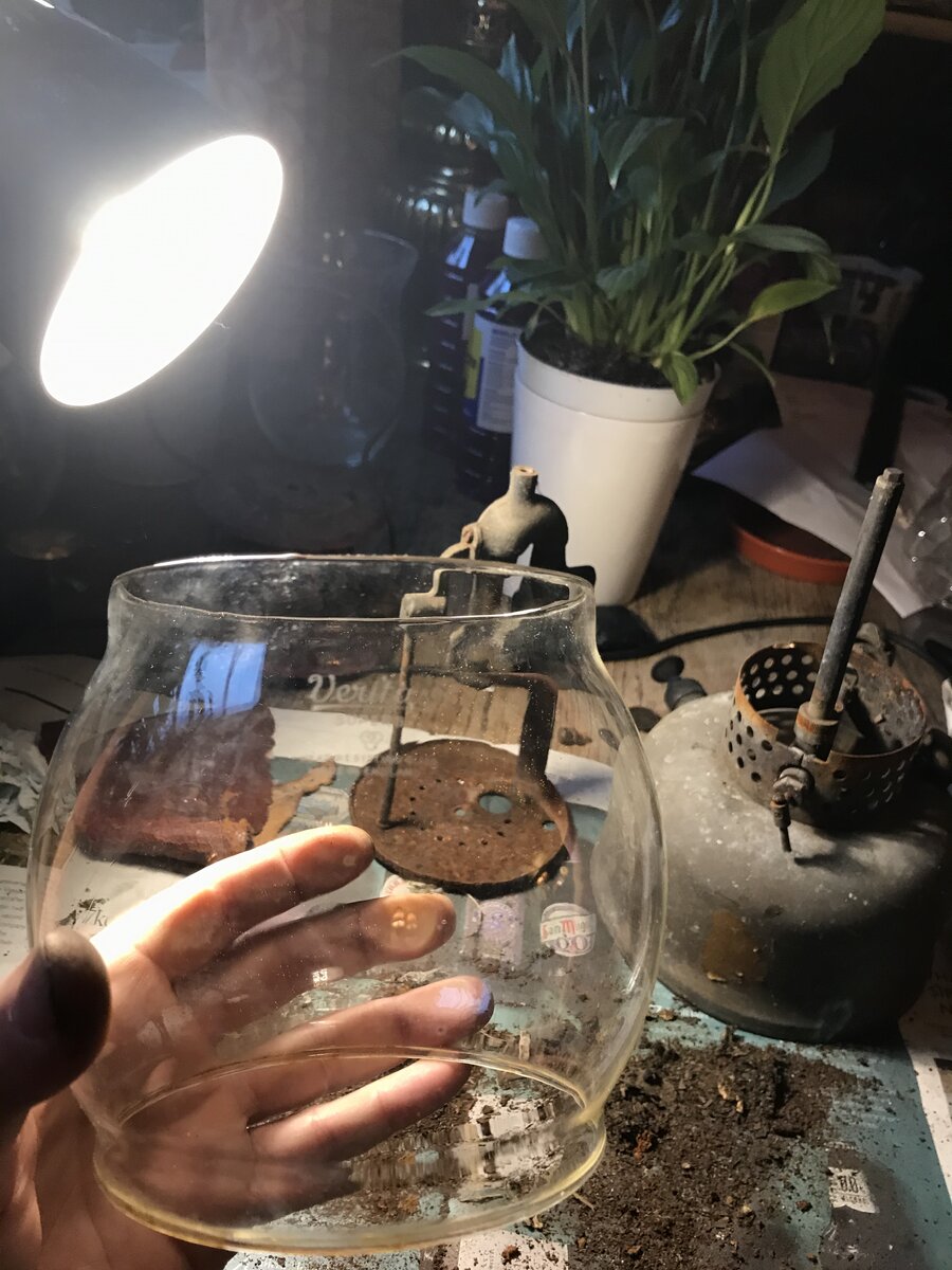

    I'd be worried about the burner screen lying on the globe support plate. If it's already fallen out of its own accord it's probably not going to remain in place when you run the lantern. Maybe you could return it to shape and it might spring back into place and stay there. Otherwise I've no idea where you might get a replacement but you could possibly cut another one from some stainless mesh of the same gauge. Fingers crossed with it. [-o<
    One little tip, see that small screw holding the top of the support rod onto the burner? - don't try to remove it unless you absolutely have to. :oops:

    David- yes, the burner mesh screen had come loose and was lying on the base of the cage among the dirt. I’ll try and do what you suggest. I also found a metal ring next to it- presumably the retaining ring as its the same diameter?

    I came by one in much the same state but minus the globe unfortunately. The pricker lever is meant to have a small piece of what I think is cork tube. It slips over the brass tube and is swaged over at the end to hold it there. Its meant to stop the heat burning your fingers when you operate the pricker mechanism but you still have to be careful!
    I've used some stainless mesh from a kitchen strainer on the burner and so far it's held up ok.
