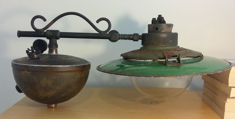

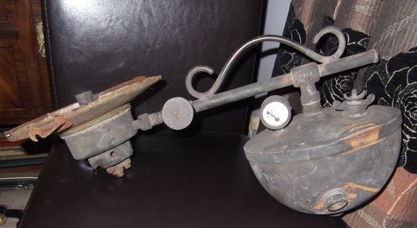

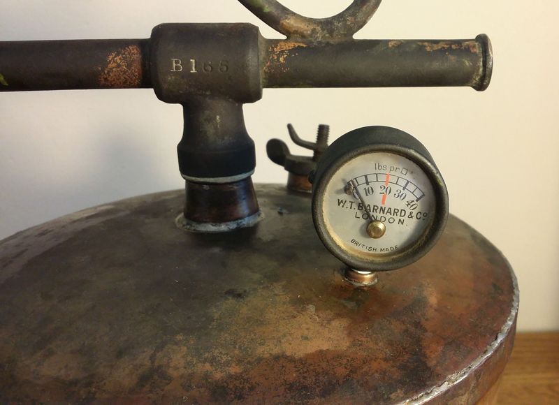

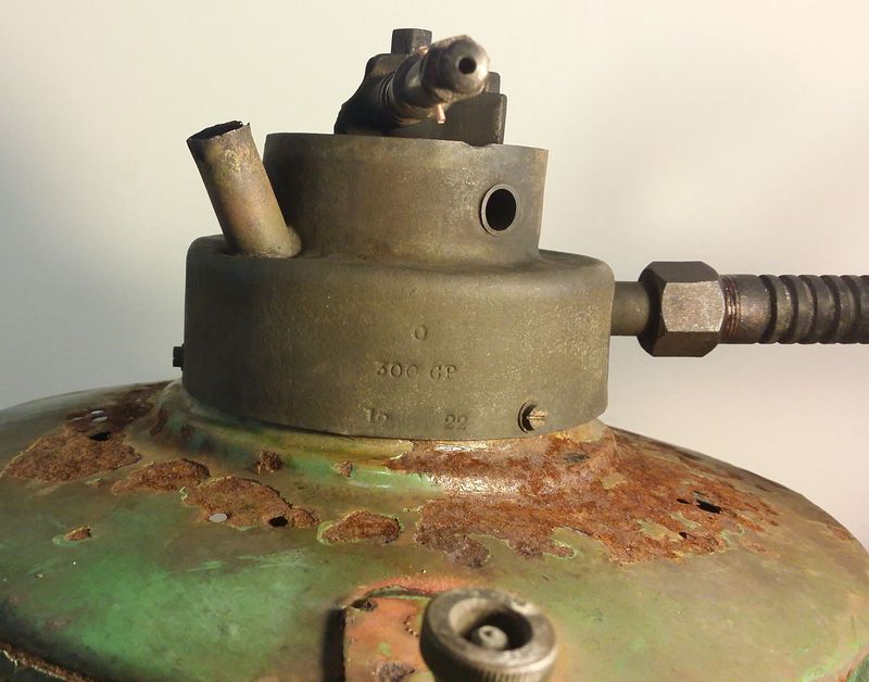

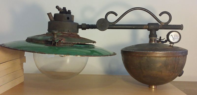

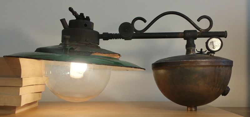

    Burner is date stamped 1922. The tank was dismantled, annealed, reshaped and re-assembled. No badge on it and I can't see any sign that there ever was one but maybe it fell off. The inner reflector is a bit ratty but it is pretty sound. The outer reflector is borrowed from another lamp. Anyone fancy making me a globe cage for it so it will sit upright without the aid of a pile of books?

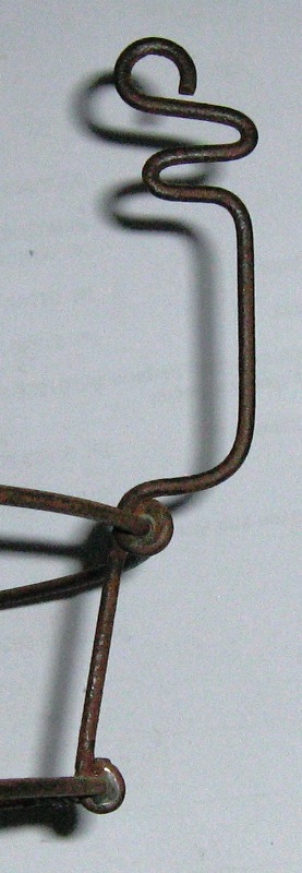

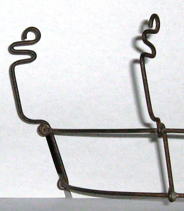

    I don't have any wire but I can give you measurements I've taken from my example. The construction method is basically the same as the wire guard on a Tilley PL53 but there are 6 legs.
    The wire is 0.128 inches diam. (whatever gauge that is).
    The bottom ring on my example is a little distorted but averages 11.25 inches diam.
    The upper ring is 12 inches diam. and sits 2 inches above the bottom one.
    Unlike the PL53 guard, the legs come up the inside of the rings and are (silver ?) soldered in place.
    After the legs have come right round the upper ring, they step out 1 inch before rising 2 inches. They then go inwards, then outwards approximately 0.75 inch before coming back in 1 inch and finish with an outwards facing loop.

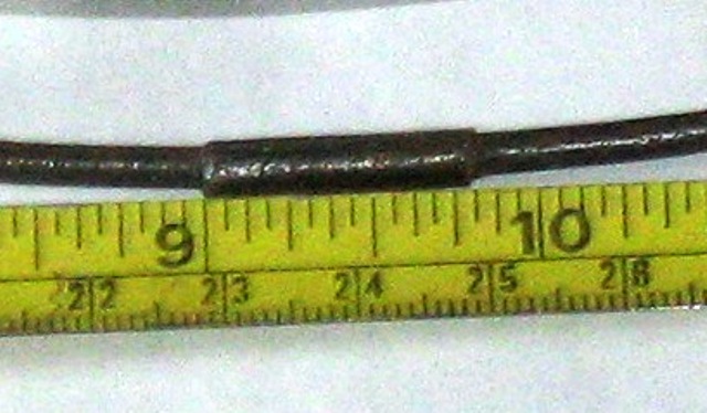

    Thanks for the pictures and measurements Henry. How is the wire joined to form the rings? Is it butt welded?

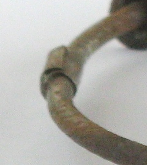

    @James, Sorry, I forgot to mention that. The rings are joined with sleeves which have been made by rolling strips of thin steel sheet into a tube and soldered.

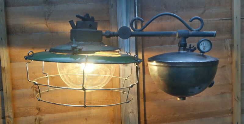

    I have made a wire guard for it. Thanks for the help Henry.

    @James Your guard certainly adds the "finishing" touch, at least from my point of view. Well done.
    What sort of wire did you use ? I have some lengths of 3 mm stainless steel wire and had thought about having a go at making one myself for my model 1397, that is, until I found out the price of flux I need to silver solder stainless steel.

    This was my technique for making the uprights.
    I printed the photo of the upright onto paper to the correct scale and taped it to a thick wood offcut.
    Using the photo as a guide I hammered nails where the tight bends needed to go and cut the heads off.
    The looser bends I drilled larger holes and left the drill bit in the hole.
    I was then able to wrap the wire around the nails and drills to form 6 identical uprights.
    The hard part was I had to heat the wire red hot with a blowtorch to bend it properly.
    Of course this chars the wood. I would pour water on it every so often to keep it from burning too badly.
    Maybe I could have put something on top of the wood to protect it from the heat e.g. a sheet of thin metal.
    Messy business. If there's a better way I would like to know.
