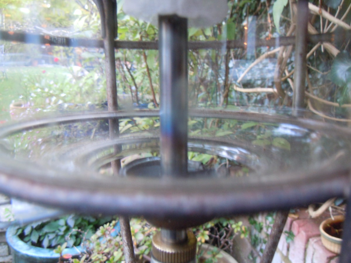

  24. JonD
    JonD Subscriber
    Apr 15, 2014
    624
    Hertfordshire, England
    It is probably not very hot at the bottom end. I was playing with a new Korean vap which had a nice shiny finish and after the first lighting it did this.
    Checking the colour charts for tempering steel the bottom straw band is under 200C and the upper blue one approaching 400C. All that happens in quite a short part of the length...
