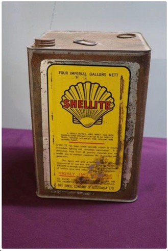

    In the "old days" the recommended fuel for kerosene lanterns and lamps sold in Australia (for example, Tilley and Coleman) was "lighting kerosene". "Lighting kerosene" was standard, good quality kerosene. It was sold by "Shell; "BP" (British Petroleum), "AMPOL", "AMOCO" etc. What is sold in Australia today as kerosene is essentially the same, except that most of the kerosene is imported as Jet A1.
    Today you can buy "Diggers" kerosene in Australia. It is the same as the "old" kerosene.
    For "gasoline" lanterns and lamps, what the Americans call "white gas" was sold and used. It was made for lighting by various companies, but the most commonly available "Shellite". Shellite is naphtha. It is still available today (also sold as Recosol).
    I use Jet A1 for kerosene equipment, and Shellite for gasoline.

    You seem to collect these nice containers as well, Tony? Love 'm! Mike
  14. Tony Press
    9,632
    Mike, I don’t collect them — they wouldn’t fit anywhere! Those are “public domain” photographs.
