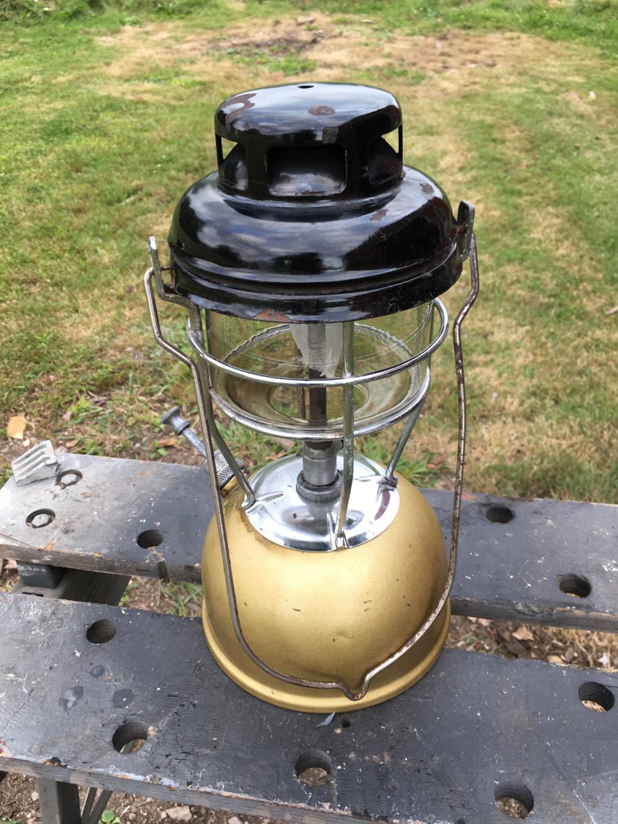

    I've never had a Tilley lantern before, in fact I've never even seen one in person before I bought one online.
    After a quick cleaning, replacing the usual seals it is now working great and runs for hours but I wanted to double check how the control valve is supposed to work:
    I have to open it all the way counter clockwise to get it to light.
    But if I leave it all the way counter clockwise it will go out in a few minutes.
    So I quickly figured out if I turn it back clockwise almost to the click that turns if off - then it runs for hours, holds pressure perfectly etc.
    My question, is this normal and how they should work?
    Again, I'm in the USA and have never even seen one before, there are not many around.
  2. Mackburner
    6,272
    It's an X246B so the control is an alloy type which were never the best engineered product. They are supposed to work full open. So all the way anti clockwise to open and all the way clockwise to operate the pricker. However some of these are a bit too restrictive so they partially close of the fuel flow and it sounds like you have a suspect valve. I have found a very few of these valves that won't pass fuel at all. I cured at least one by removing the spring and valve and drilling a small hole through the inner plug so it passes fuel but will still operate the pricker. Drastic but otherwise scrap and it worked. Tilley lamps actually don't need a shut off valve anyway so doing this does not affect peformance. ::Neil::

    It has been out there running for a couple hours tonight. Nice and bright, holds pressure and runs for hours. Just needs the valve open just a crack, if you open it all the way it goes out. I might leave well enough alone for now as long as it is working so well. I’ll take it camping this weekend and see how it goes.
