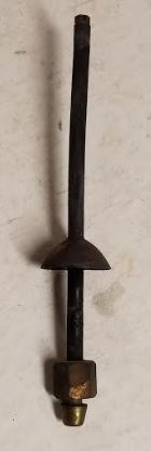

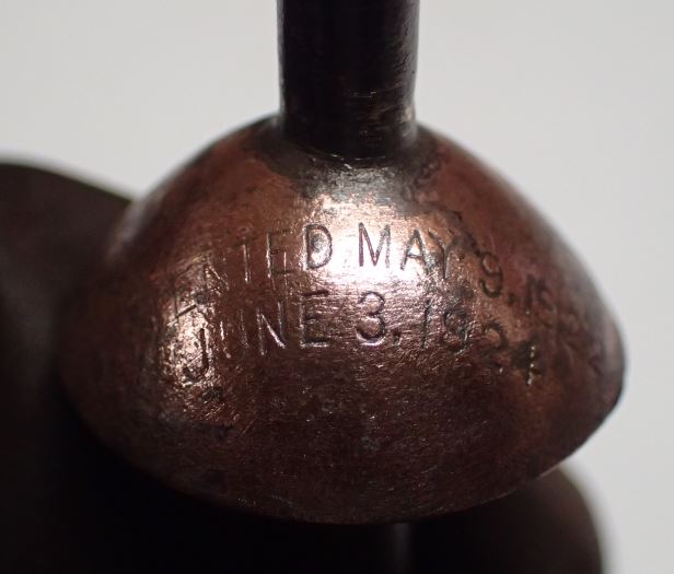

    I'm working on a recently acquired Nulite No. 5 lantern and have what appears to be the original umbrella-type generator on it. I can see that there is a screen inside of the generator tube, near the bottom, however, I can't see light through the generator with the tip removed. Anybody know what's inside of the generator? I'm wondering if I need to remove the screen and clean out whatever is in there, similar to what you'd do on a Coleman Q99 generator.
    Here's what the generator looks like:

    They are packed with asbestos so even new you can't see through the tube. With a well used generator you may have to drill out and replace the old packing because they choke up with carbon and eventually restrict gas flow to the gas tip. ::Neil::

    This was Nulite's answer to the Coleman Q99. One lit match held under that little "umbrella" and that's all you needed. It will, when not stopped up, lite as fast as a Q99 generator.

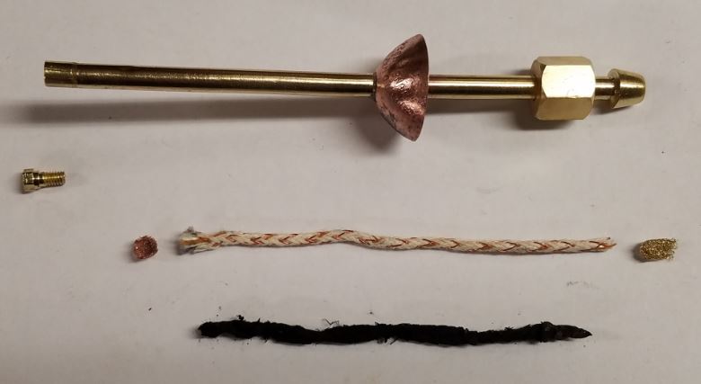

    Thanks for the information. I think I'll give it a soak in an ultrasonic cleaner (to keep the asbestos fibers wet) see if I can remove the screen and then first try a shot of compressed air to see if I can blow out the packing. If not, then maybe on to some heat and quench cycles and possibly drill it out. Finally, maybe use a Zippo wick for replacement if the packing is really bad. Thanks for all the info.

    Well . . . success! I soaked it in the ultrasonic cleaner and alternated with heat-quench cycles. I was able to remove the lower screen, but the packing didn't come out when using compressed air. So, I used a twist drill-bit gripping the bit with pliers and it grabbed the packing and I was able to remove it. There is also an upper screen which I didn't expect and pushed it out with a piece of copper wire. The packing was falling apart and I'm thinking that as it continued to deteriorate it might have continually clogged the generator tip, or possibly the built-up carbon, so I'm satisfied with my choice to get it all cleaned out. In the photo you can see the old packing and the new Zippo lighter wick I plan to use as a replacement.

    Maybe copper mesh as a new packing is also a good replacement.
