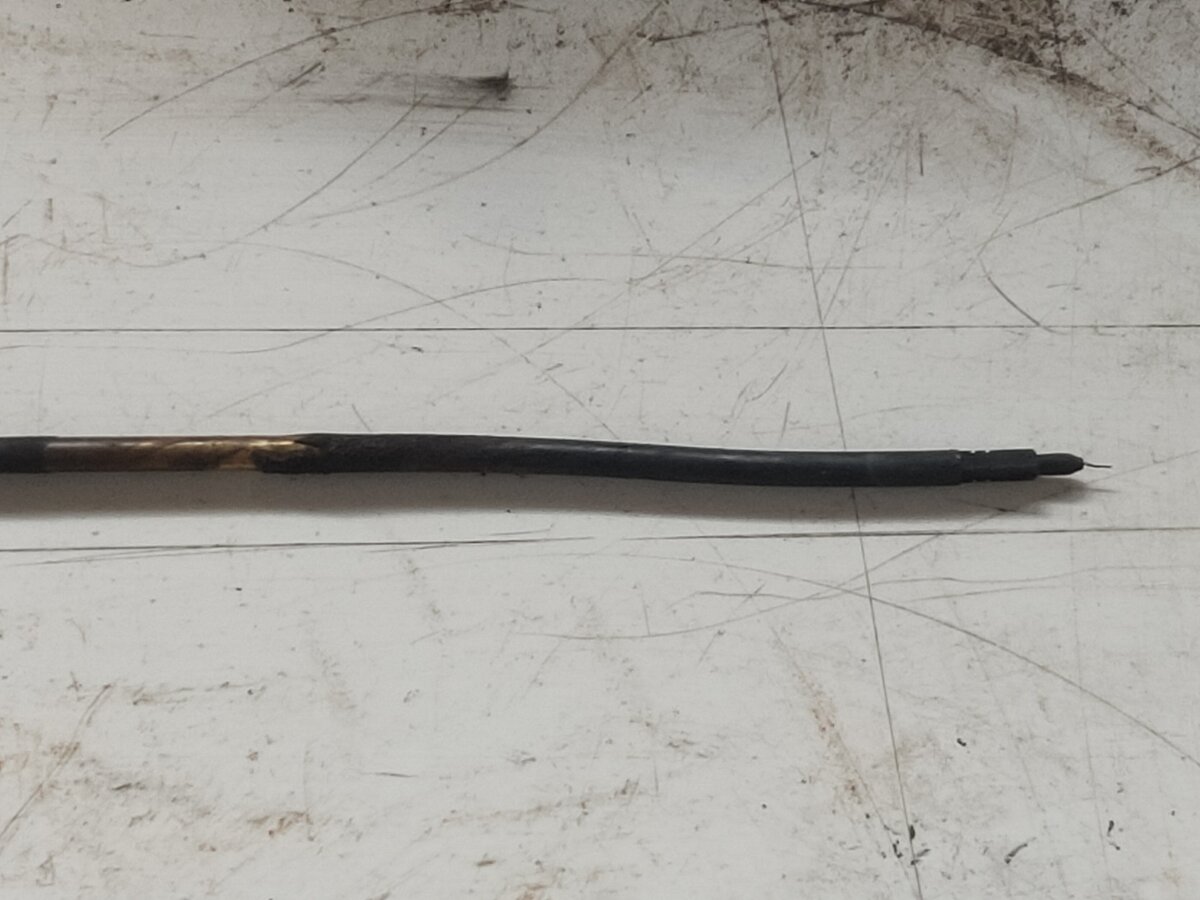

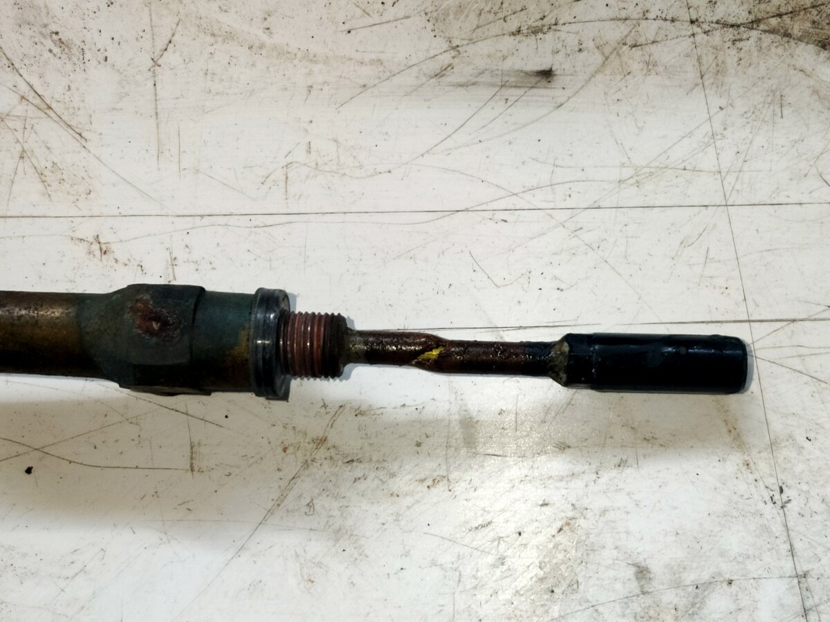

    I can make pump leathers so they’re not an issue but I need seals and NRV pips and (maybe) the lower half of a vaporizer if I can’t get it apart enough to replace the tube. The lower part (which I think is a valve) is completely varnished over with shiny black stuff and the tube itself is torn.
    The generator rod is somewhat bent and incredibly fouled up with carbon on the one I’ve dismantled so far. Hopefully it’s recoverable but I’m guessing I should probably replace the needle at least.

    The shiny black gunk is probably old fuel residue. I find it is easy removed by soaking in Automotive General Purpose Paint Thinners.

  10. WimVe
    2,574
    I wonder where you found those parts (which) for those prices.
    Two 250cp vaporisers cost 70chf = 73euro = 76usd = 105nzd.
    But it all depends on what you really need to replace. Maybe showing pictures will give us a better understanding.
