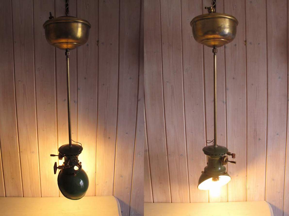

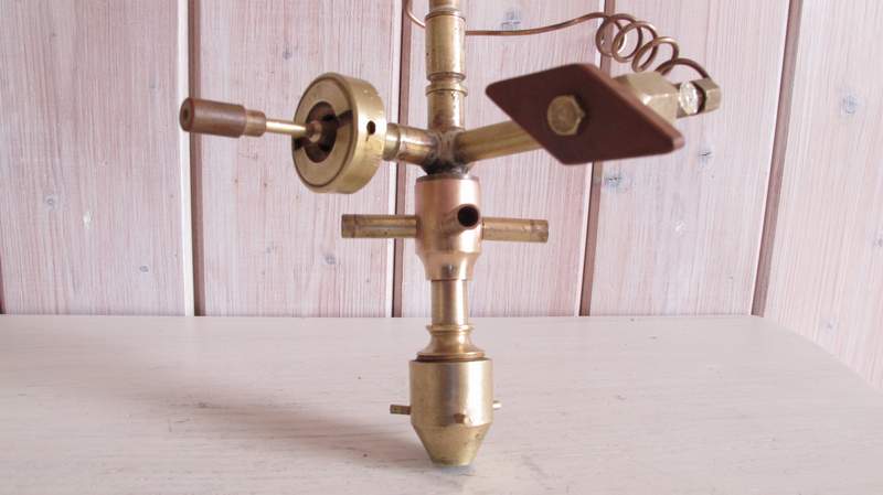

    Hi all

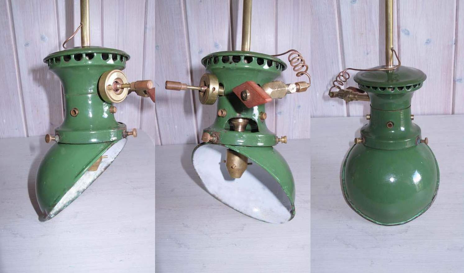

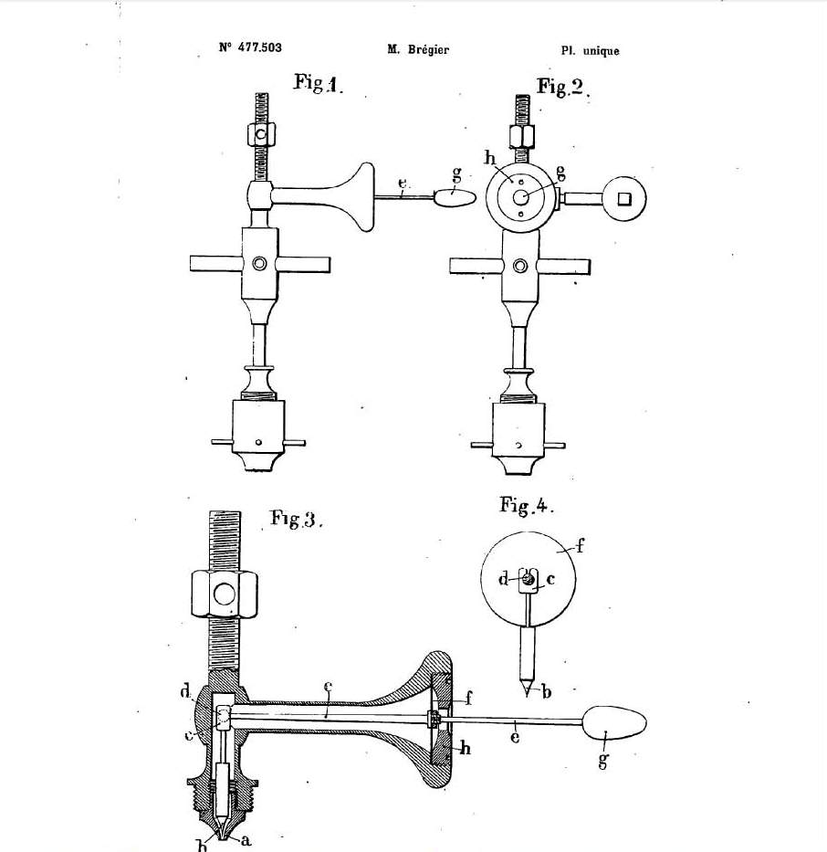

    here is my last restauration. A hunging lamp from Bré (15, rue de lancry, Paris X or 19 & 23 Rue Bichat, Paris X) It runs with gasoline with a wellknown burner.
    The small brass rod is the needle cleaning system. It is protected against the heat by a bakelite cylinder.
    In order to clean the jet, you just have to push it up to the top.
    here is a drawning of the patent (june 1914 FR 477503)
    A very simple and solid burner.
    Unfortunately, I cannot give it a try, because is missing the manometer.
    It is difficult to give a production's date, because I have never seen this lamp in any paper, but I believe from the 20's.

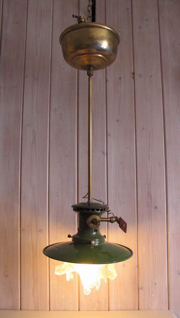

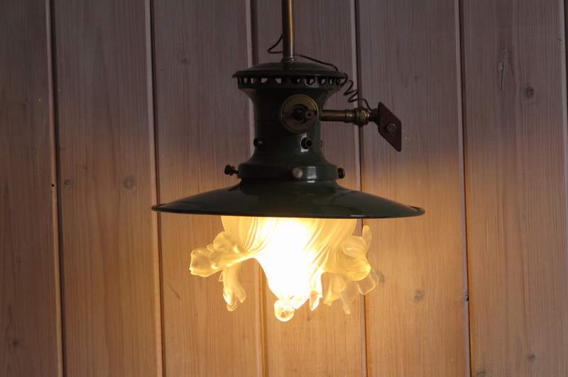

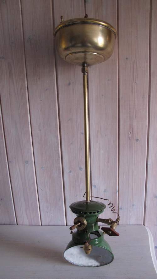

    Sorry Claus, I havn't seen your questions :
    the shade can be turned all around, because it is held by the 3 screws, as a globe.
    I don't know what was the use of this lamp, but I think in a workshop where they have needed of a lot of direct light.

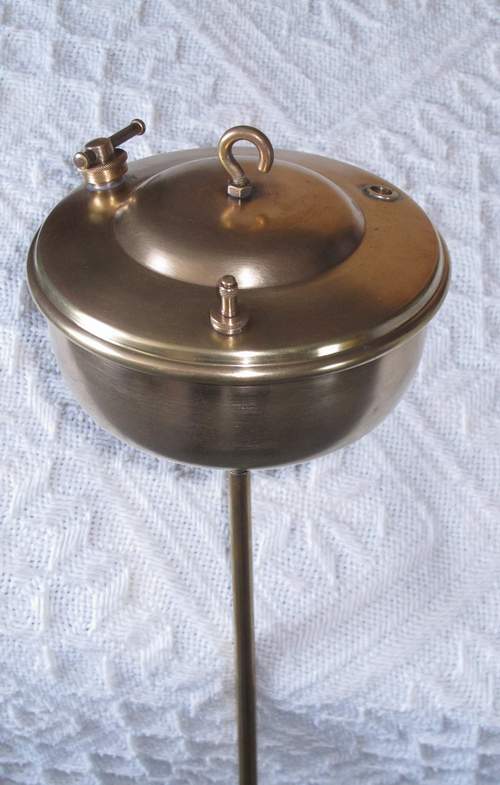

    1/ I had to find either a manometer, or a screw to plug the tank's hole. No manometer at this instant.
    And the thread is an old special french thread (difficult to find)
    This is done.
    2/ when I have first pumped, I have realized that the tank was very stressed all around.
    I had to tin solder the bigger cracks by the outside and to do a epoxy resin treatment by the inside.
    This kind of burner was usually given for 250/300 CP. But this one is more powerfull. Around 500 CP, not less. The 4 air intakes are open in contrary (for exemple) to this Bré table lamp : http://0flo.com/index.php?threads/9498
    here is the lamp, as I found it, a workshop's configuration :
    And here, more cosy ("bourgeoise") with a enameled shade and a fantasy glass from the 20's.
