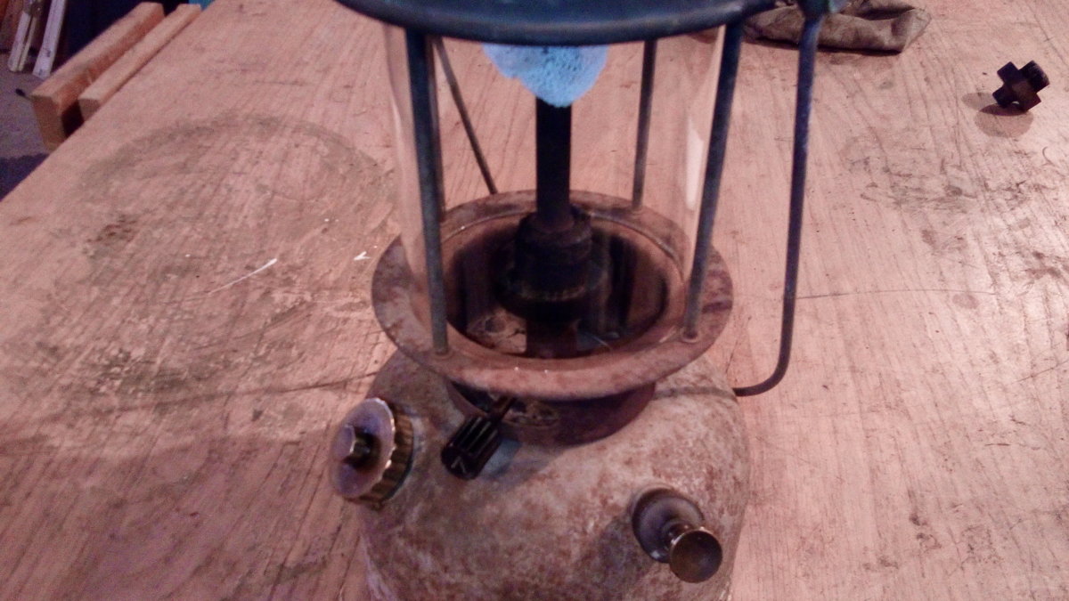

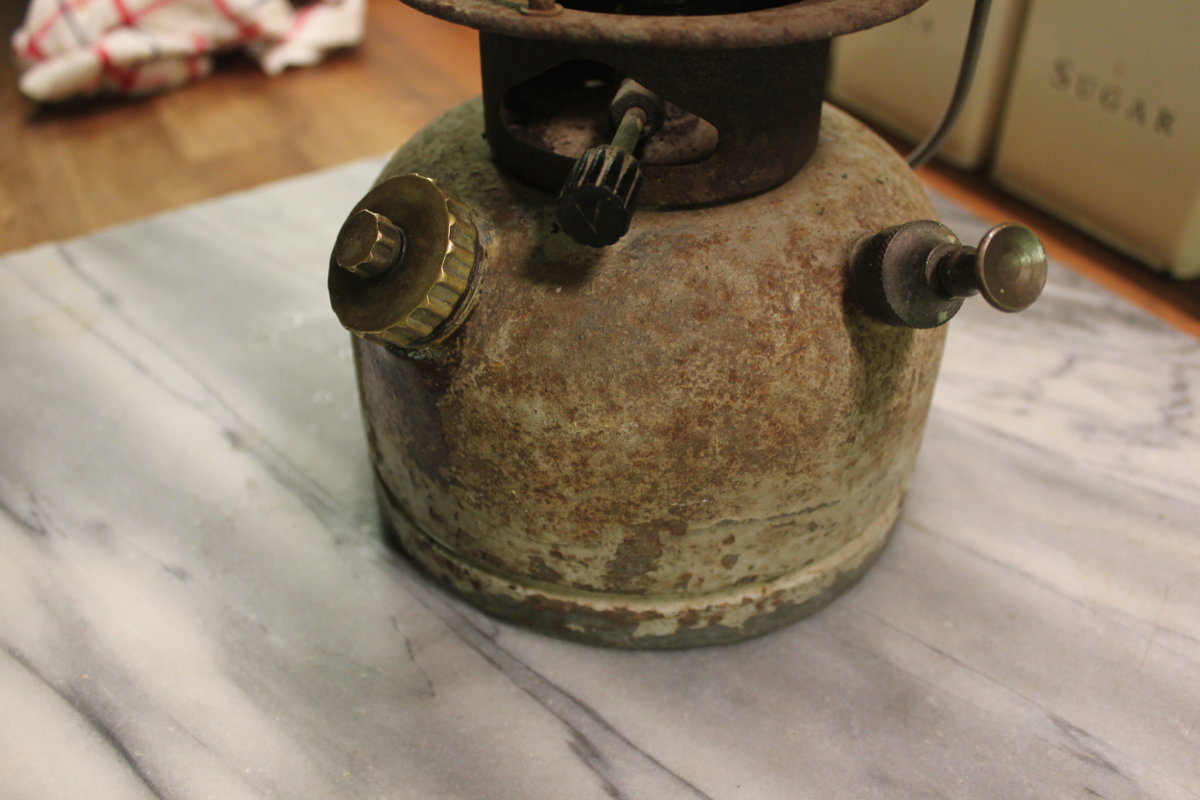

    I received this early on in my lamp collecting career and at the time I wasn't confident enough to fettle it so I left it. It worked extremely well so having lit it a few times I shelved it until I was ready to begin giving it the TLC in needed. Here are some 'before' shots to show the condition when it arrived...

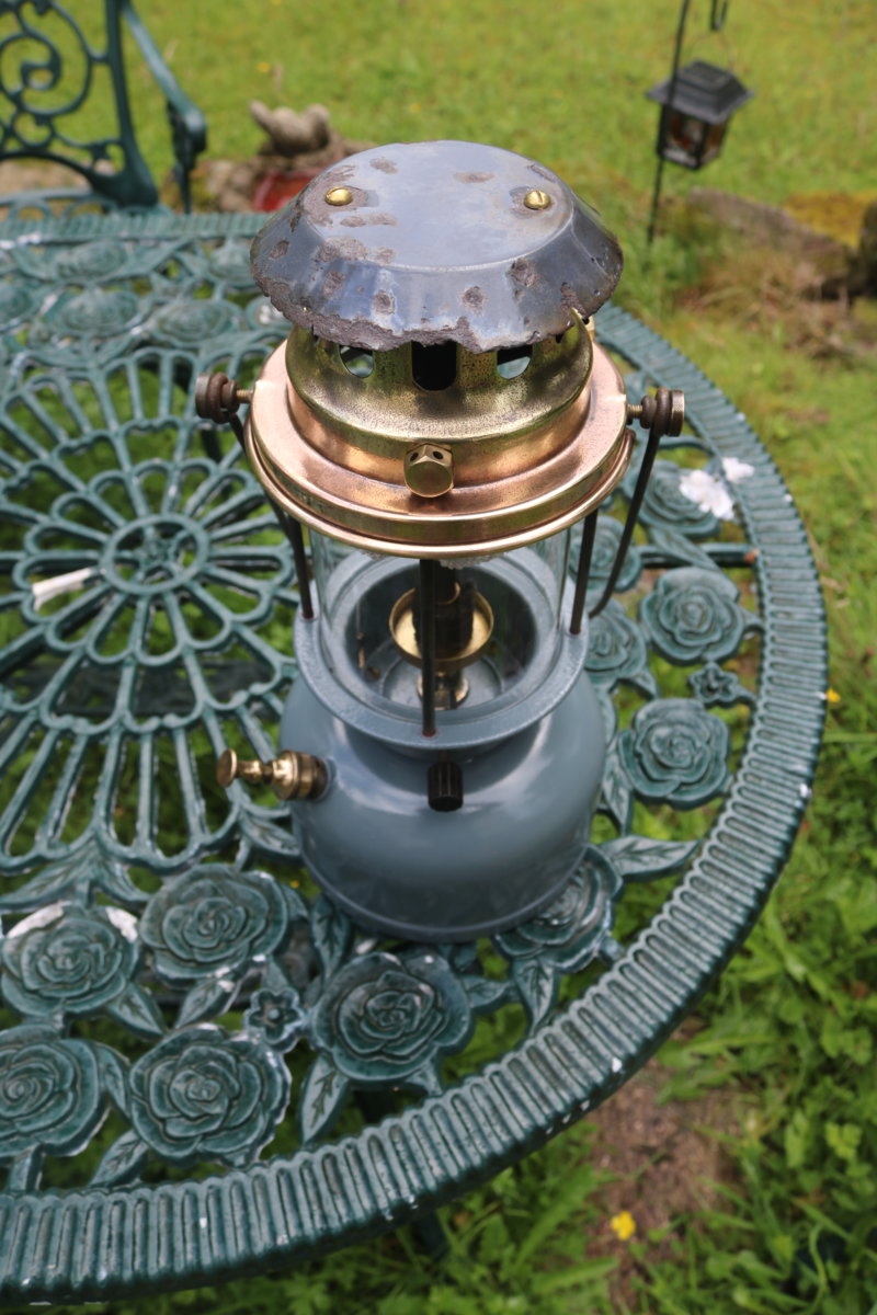

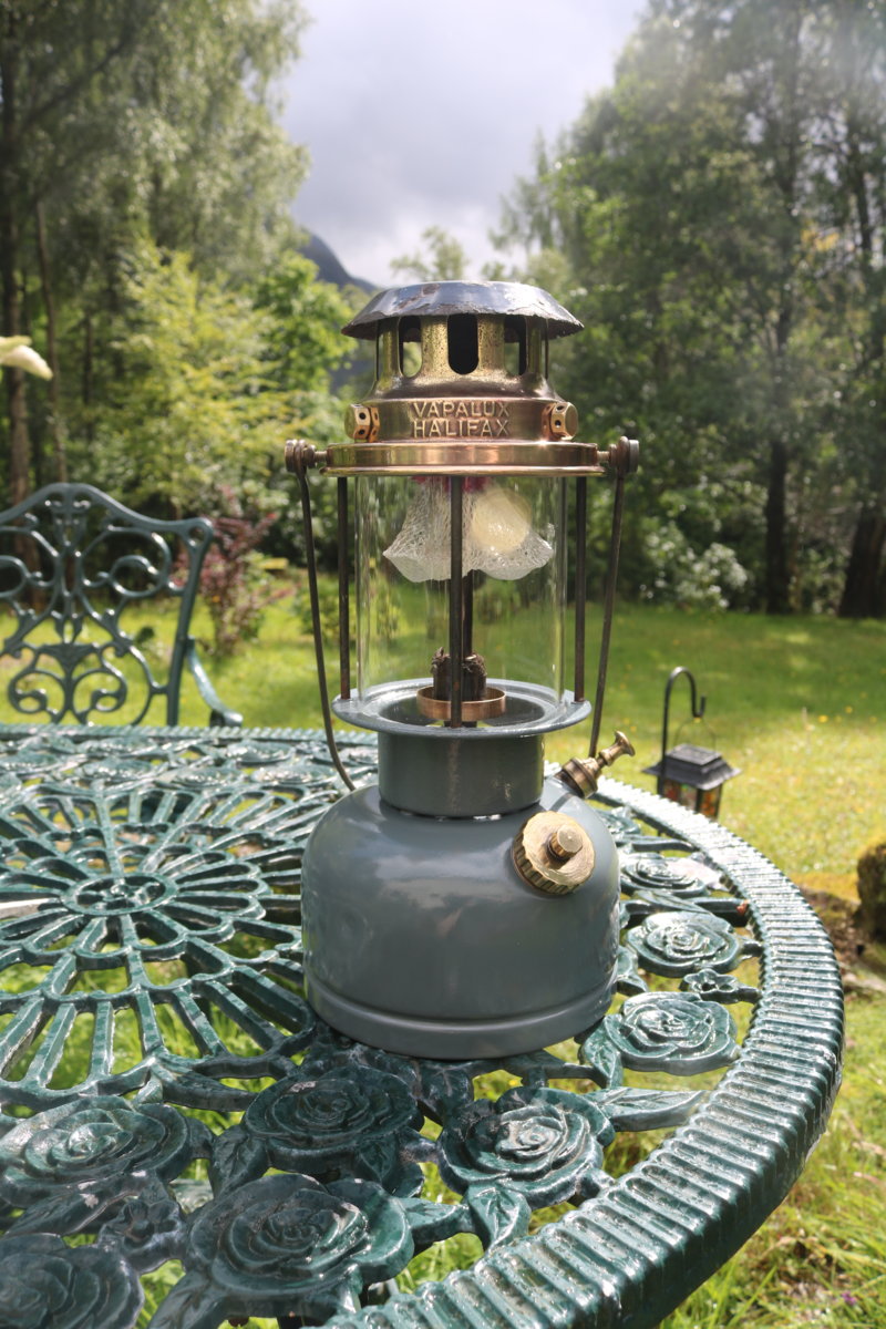

    And here's how it looks now... I had no idea there were any dents in the tank because the corrosion and general grime were so bad, but I left them as they were and didn't attempt to fill them. The brass hood is very pitted and I didn't try to rectify that, oh and someone had got the lamp too close to something plastic (a carrier bag maybe?) which had melted onto the brass making it very hard to remove! The colour isn't that close to the original but the choices of spray paint in Fort William aren't great. I was told that it was an RAF issue lanterns by the previous owner... is this likely? I definitely found traces of grey/blue paint on some less corroded sections.
    ...and finally a money shot of the old girl working as intended!

    The enamel hood 'cap' is original. I thought about replacing it but I don't think they make them in grey and anyway, I think it looks fine as it is.

    A beautiful restoration job. You must be very happy with the paint job? And the brasswork is a sight to behold. I'm amazed that the lamp actually worked in its original condition. It looked ready for the scrap-heap....
  6. ColinG United Kingdom
    4,808
    So was I when I first got it. The guy told me it had been used regularly as a backup when the power went out but the glass had been smashed years ago, so for most of its life it had been run rusty and with no globe... and it had been kept in a damp shed! Incredible!
    The paint job is pretty good all things considered. I'm not that worried about the colour but there are a few corrosion pits that were originally fixed after the first red oxide coat but that proved to be a disaster. Now it's stable it should last for years.
