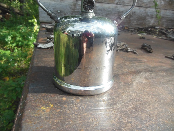

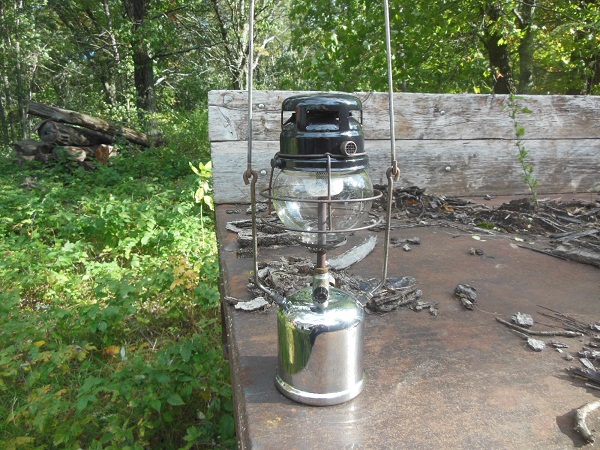

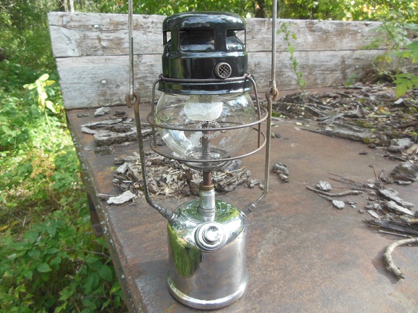

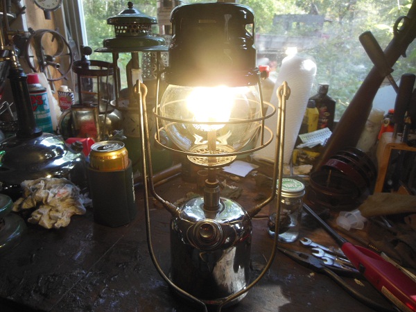

    New seals, and seems to run well. 1474940816-410_001.JPG 1474940853-410_003.JPG 1474940889-410_002.JPG 1474940920-410_004.JPG
  2. Mackburner
    6,362
    Cute little lamps these. This is the older one with the twin air tube burner. The later X410A has a three air tube burner. Nice to see another running. Rare things in the UK. I think nearly all of them were exported to the US. ::Neil::
