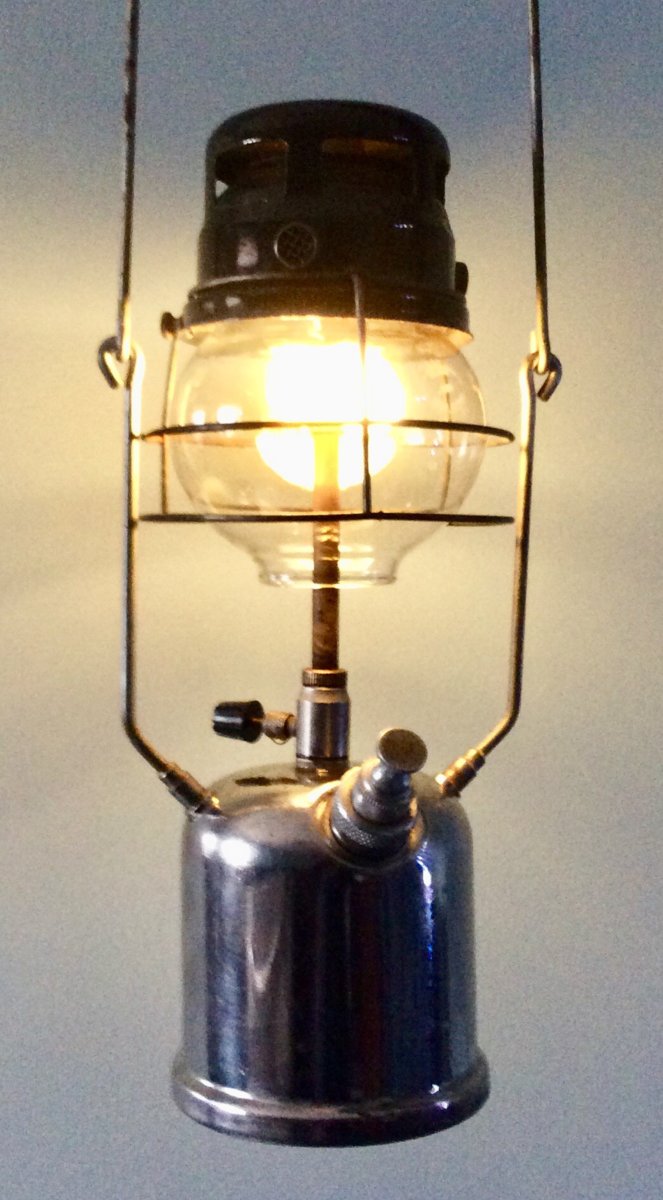

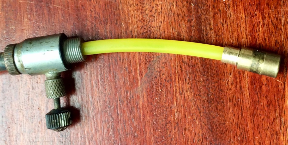

    1CC6C345-B909-4EAF-9BCC-05A3C5F9D761.jpeg 9BFF7C81-F176-48AE-AA2F-D67FFD840706.jpeg With a litle help from John (OK he did it all) a new pipe was fitted and also the end filter from a long control cock.

    Nice!!:D/:thumbup: Well done!:lol:
    9,683
    Well fettled John!:thumbup::thumbup:
  4. AussiePete
    2,574
    Your lantern is running well, looking good and would be a nice acquisition to your collection, well done.

  6. Matthew92
    Matthew92 Subscriber
    Feb 13, 2012
    1,993
    Very nice Jean, I love these little lamps.
    You appear to have a drip on your cock though, better get that seal changed.:lol:

  8. AussiePete
    2,574
    @Matthew92 Well spotted, one cannot have drippy cocks, can one, as it would be a sign of things not quite right ......:-#
  9. Jean J
    1,643
    Gentlemen, please! Not to worry Matthew, all sorted out after pic was taken and no new leaks. It’s a little sweetie and I like it as much as I’ve come to like the wee Coleman lamps.

  12. Ernest Kimm Korea, Republic of
    Nov 21, 2018
    18
    South Korea
    Thanks for pic on new pipe replacement.
    Could you please let me know whether the non-return-valve exist or not?
    If then, please give me a further explanation on where the non-return-valve is located.
  13. Henry Plews
    1,113
    @Ernest Kimm
    This model does not have a non-return-valve. The repair to @Jean J 's lantern is just like the original.
    Henry.

  15. Ernest Kimm Korea, Republic of
    Nov 21, 2018
    18
    South Korea
    Thanks Henry.
    Then how to flow control off without check valve at cock? Could you please explain?
  16. Henry Plews
    1,113
    The cleaning needle will close the jet but not always 100%. Unscrew the pump and release the pressure is the best way to make sure the flow of fuel is off.

  17. Ernest Kimm Korea, Republic of
    Nov 21, 2018
    18
    South Korea
    OK for your answer.
    Understood for me.
    Thanks.
