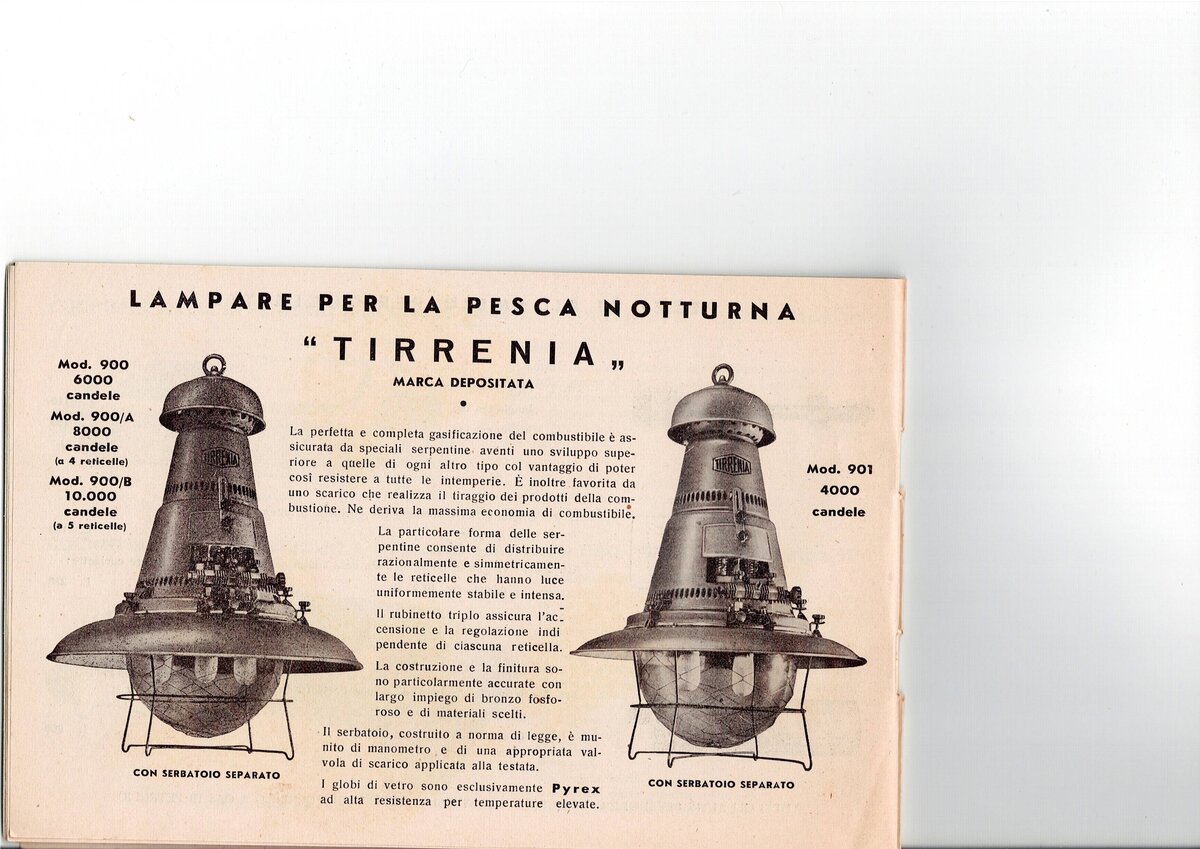

    I found a catalog from Petroflam (Italy) from 1953.
    This catalog also includes several Tirrenia fishing lamps.I'll show you an initial image. If you find the lamps interesting, I'll show more page in the library with many fascinating details.

    Those lamps are new to me and yes, I would like to see the rest of the catalogue.

    Ok , Jeff,I'll do it.
    The strongest of these Tirrenias,in my opinion,has 5 times 2.000 cp = 10.000 cp !
    Without any mirrors.

    Very interesting Lamps @Reinhard , surely the biggest ones I've seen yet. I'd be interested to see the catalogue, too.
  12. WimVe
    3,487
    Looks as if there are five nozzles to clean ;-)
    Good find.
  13. MYN
    3,809
    This is interesting. I haven't yet found any pressurized kerosene, gas mantle lanterns with such high CP values.
    I know Luxor made some 2000/2500cp mantles though.
    The Tirrenia seem to be large hanging lamps. Never seen it.
    Mod.900A has 4 'reticelle' (nets?)
    Mod.900B has 5.
    Would be interested in the catalogue too.
