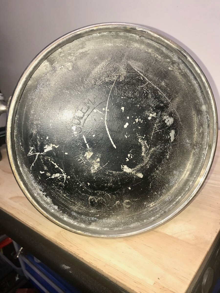

    1. This lamp of @ROBBO55 is dated 8/37 (stamped on side of fount in the usual manner) and has the following base:
    Note: It has no model number. Has “CQ”
    stamped on the base.

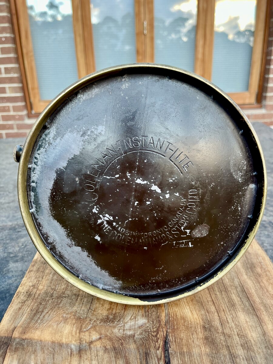

    2. This lamp of mine dated 7/37 (stamped on side of fount in the usual manner) has the following base:
    and “0” stamped on the base.

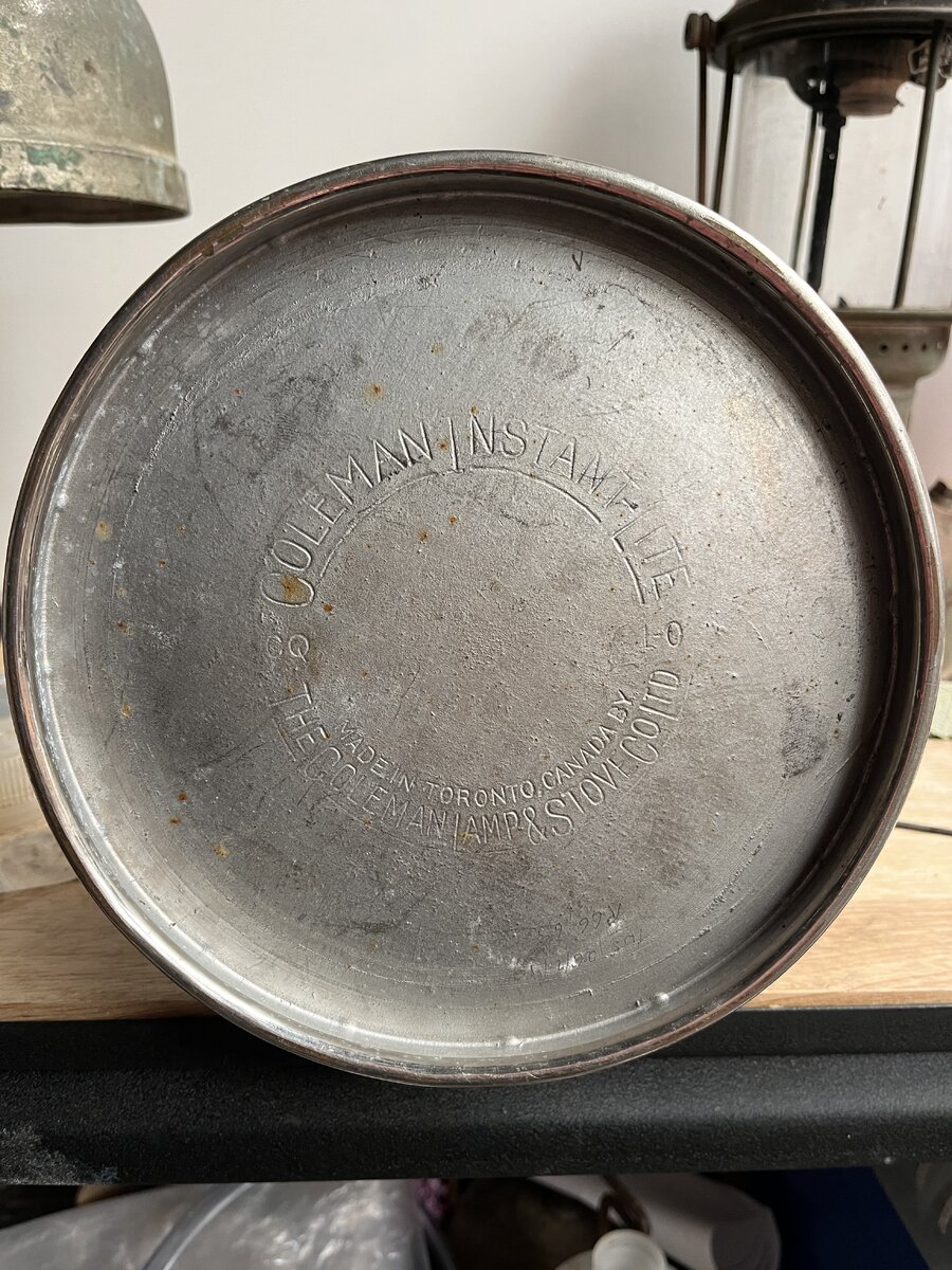

    3. This lamp of mine dated 12/35 (stamped on side of fount in the usual manner) has the following base:

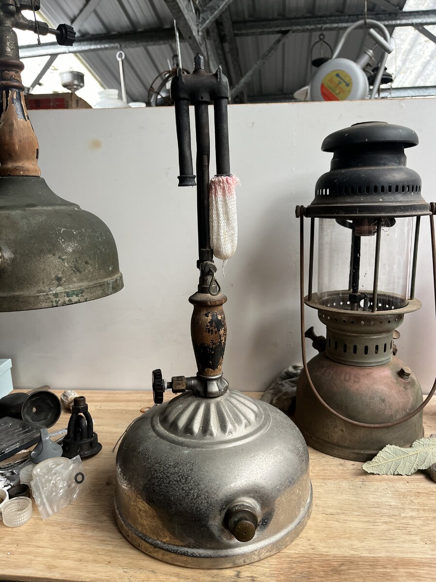

    4. This lamp (below) of mine is undated and has the following base:
    Note: It has no model number. Has “CQ” and “1-0” stamped on the base.
    The lamp:
