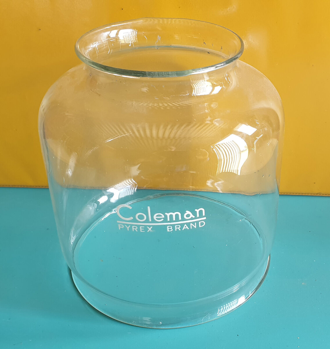

    The standard, or common, Pyrex 355 globe had a top opening of about 75 mm and a lower opening of about 87 mm. This is the 355 globe most people are familiar with and the only one known by many folk.

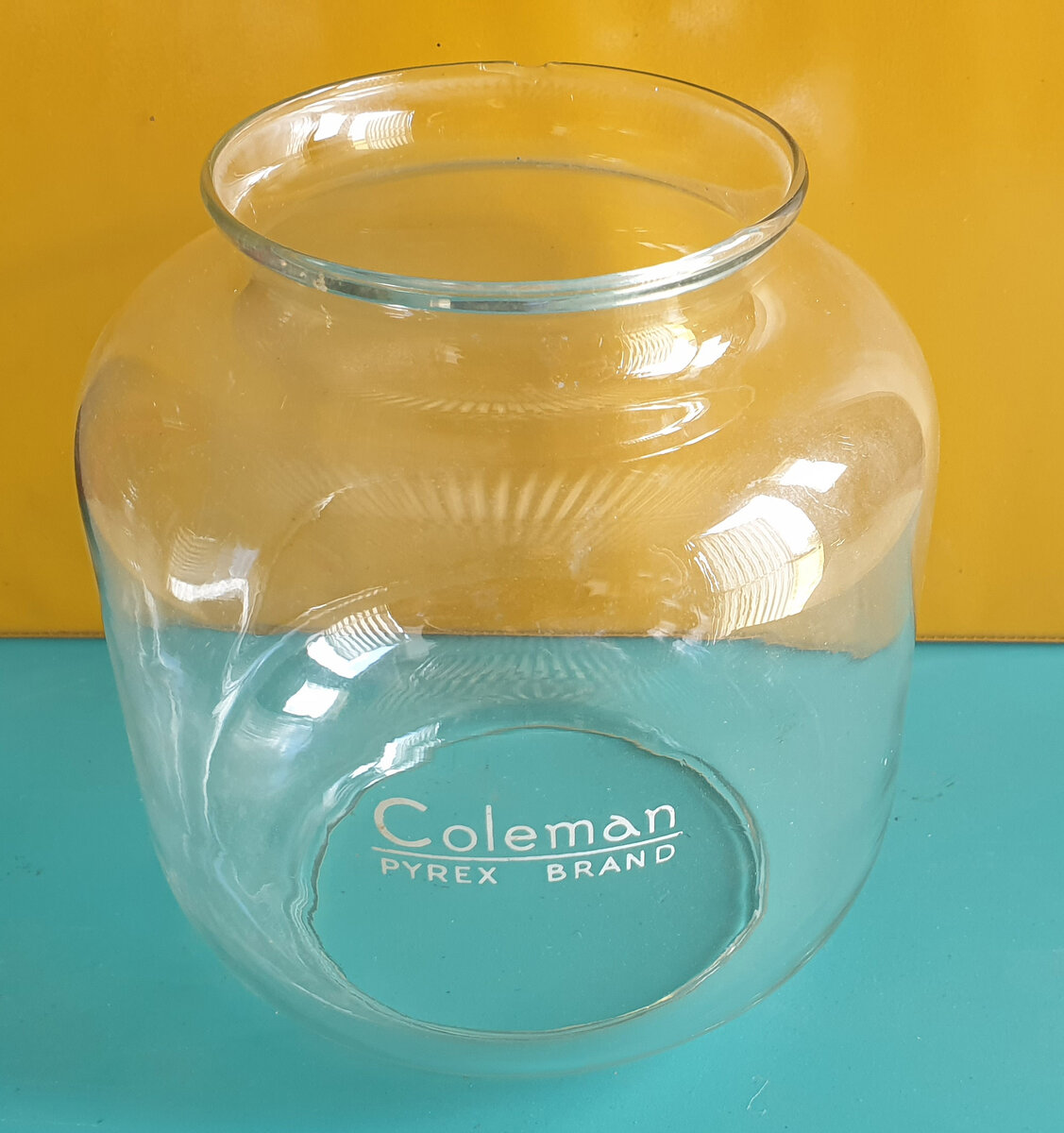

    However, there is another version of the 355 globe that is fundamentally the same size excepting for a completely open bottom end. The best name I can find for this version as a differentiation is the ‘Export’ model 355. This export version globe is featured in the 1949-50 C J Thomas (Australian Coleman retailer) catalog.
    Standard 355
    Export 355

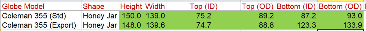

    Dimensions

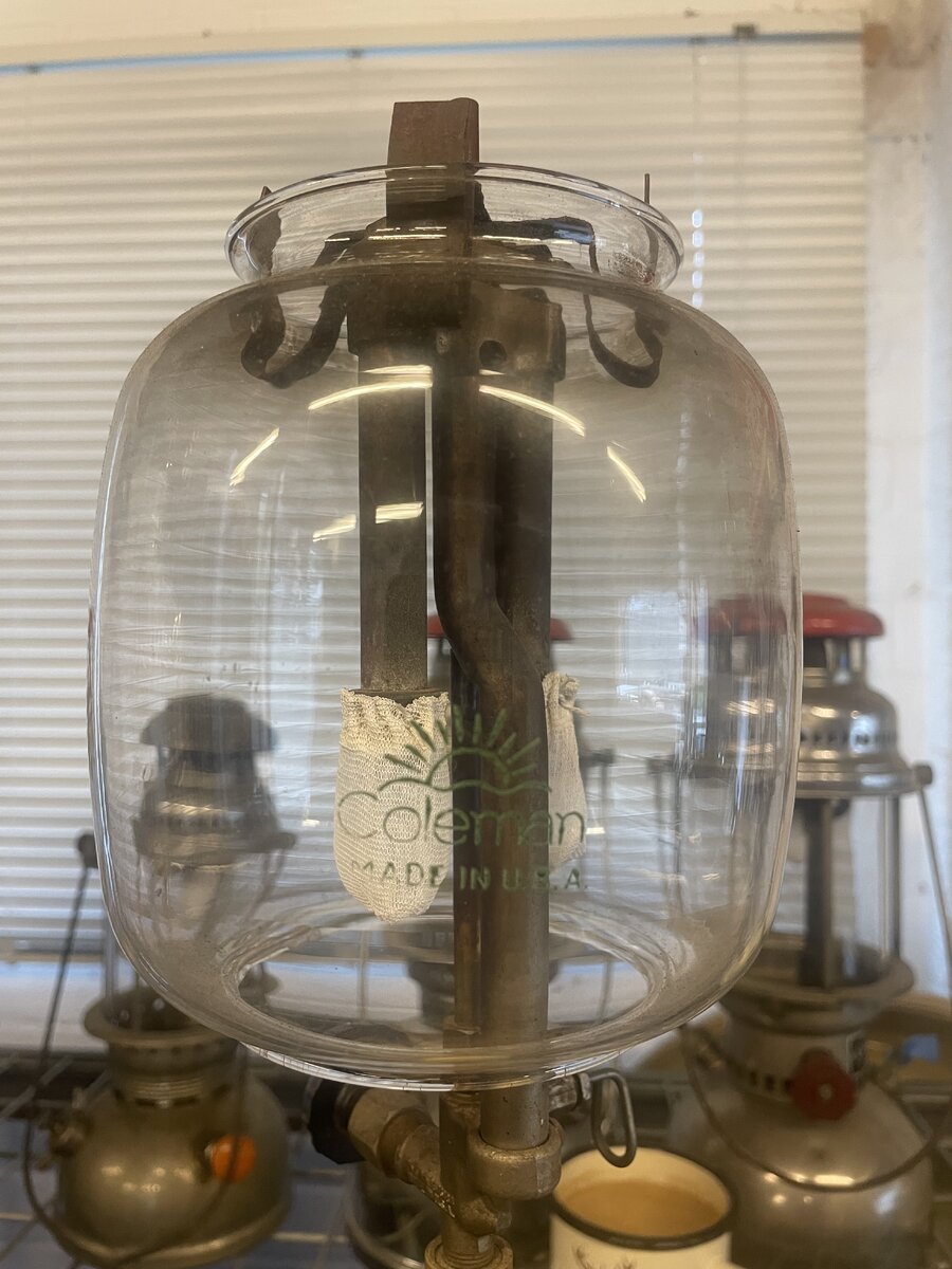

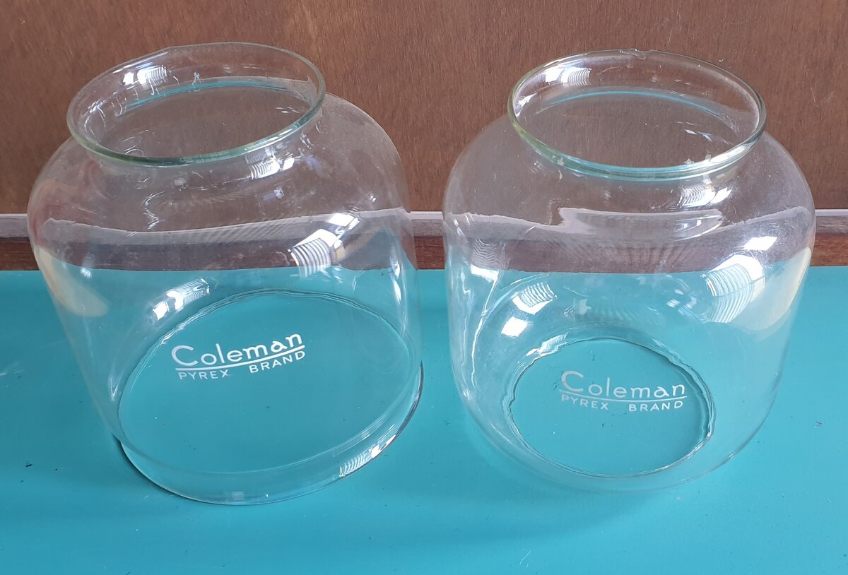

    @Sedgman
    I’m over in WA (not the USA version) at the moment but I have at least two variations of the Coleman 355 globe (and I may have another):
