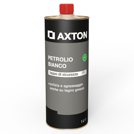

    Hello @83glt
    "Petrolio Bianco" isn't Coleman Fuel. It is more like kerosene:
    The CAS No. is 64742-81-0.
    Officially named as "Kerosine(Petroleum), Hydrodesulfurized".
    (Normal 1-K or 2-K Kerosenes have a CAS no.: 8008-20-6). The above is still a kero-like liquid and can be used in your Austramax. The boiling range is 145°C to 300°C (similar to kerosene's).
    The MSDS is attached.
    Besides "Cherosene" and Petrolio Bianco, you might also check on Petrolio Lampande, Illuminante, or other names. Do check the MSDS of the respective products to ensure the physical properties are similar to kerosene and not "lamp oil". The latter is not suitable for pressure lamps.
    You should be able to find kerosene from a number of hardware, DIY or home improvement stores around Florence, Italy.

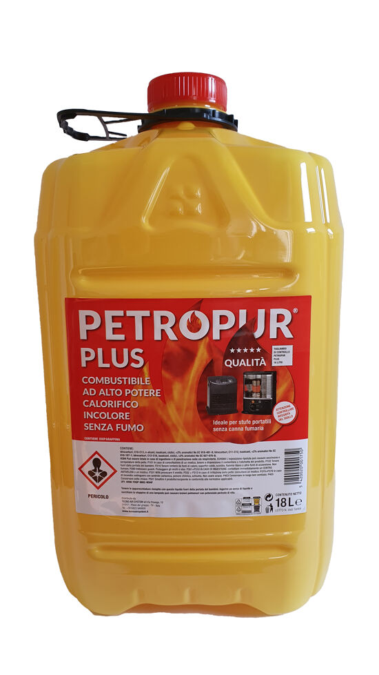

    The Petrolio Bianco can be found in Bricocentre. Besides that, here's another option from the same store:
    Petropro Plus.
    * This is more refined and has a narrower boiling range.
    It is a mixture called: "Hydrocarbon, C11-C14, n-alkanes, isoalkanes, cyclics, <2% aromatics".
    It might be slightly harder to startup than normal kerosene but should still burn cleaner with less carbonization on your lantern vaporizer.

    Oh wow! This is super helpful. Thank you so much!
    I thought the petrolio bianco was just “white gas” as we know it in the US or wherever, and wouldn’t work. But I’ll check around the local ferramentias and see what they have on hand. I’ll check the MSDS as well.

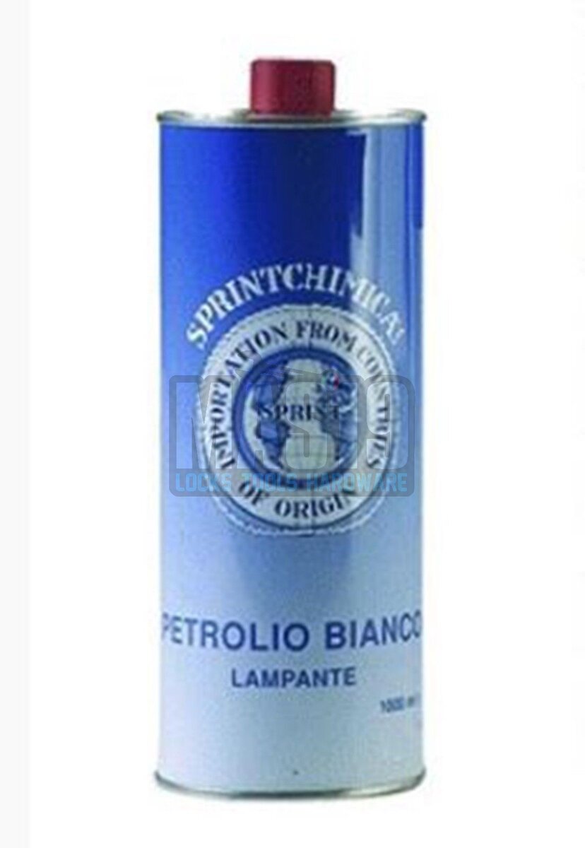

  7. MYN
    3,826
    This would be easier to light and would burn even cleaner since it excludes a lot of higher boiling point constituents that tend to carbonized when heated.
    Also highly refined.
    It is a specific mixture of C10-C13 aliphatic/alkane hydrocarbons with <2% aromatics.
    This?:-
    PETROLIO-BIANCO-LAMPANTE-SPRINTCHIMICA-LT-1-CONFEZIONE-20-PEZZI-extra-big-3860-471.jpg
  8. 83glt
    83glt Belgium Subscriber
    Jun 3, 2023
    11
    Kenya
    Yes, that is the exact product that is immediately available to me. Looks good then? Thanks so much!

    You're welcomed.
    Perhaps someday you might find normal kerosene from some local stores.
    The Petrolio Bianco in Italy seems to come in various boiling ranges. It is not exactly kerosene but specific blends of hydrocarbons around the kerosene boiling range.
    Choose something that best suits your needs.
    From the USA, there is a product called Klean Heat from KleanStrip. It has received favourable reviews and recognition by many as being a low odour and clean burning substitute for kerosene.
    I believe some Petrolio Bianco products are similarly good if not better in certain characteristics.
