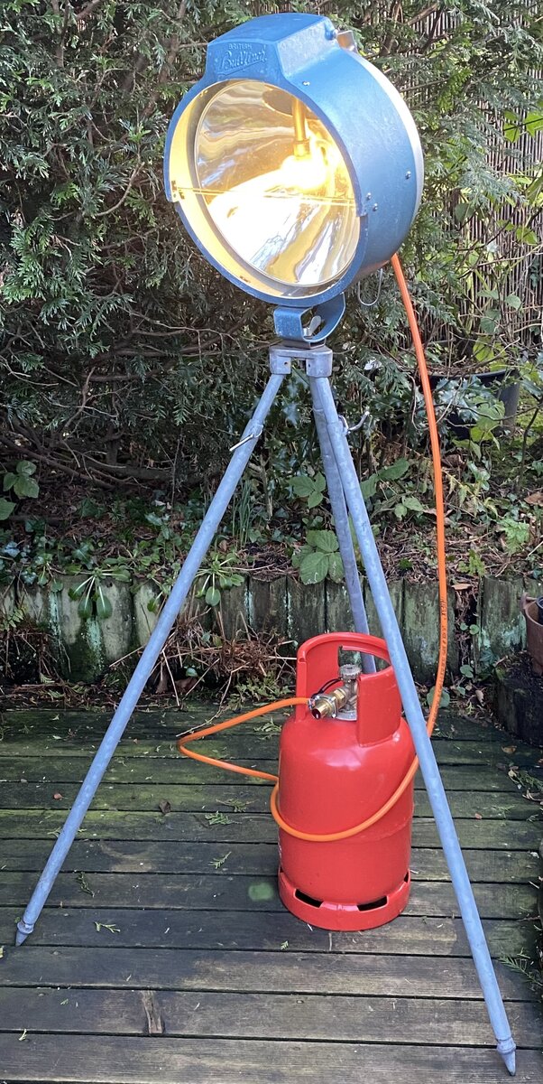

    … ok, it’s a propane one
    One of my Tilley FL6’s may well end up on that hefty steel tripod though, extending to 7 feet.

    The propane floodlamp’s brightness is determined by the efficiency of the reflector and the light output of the mantle, which is no greater than if made luminous by kerosene or naptha vapour.

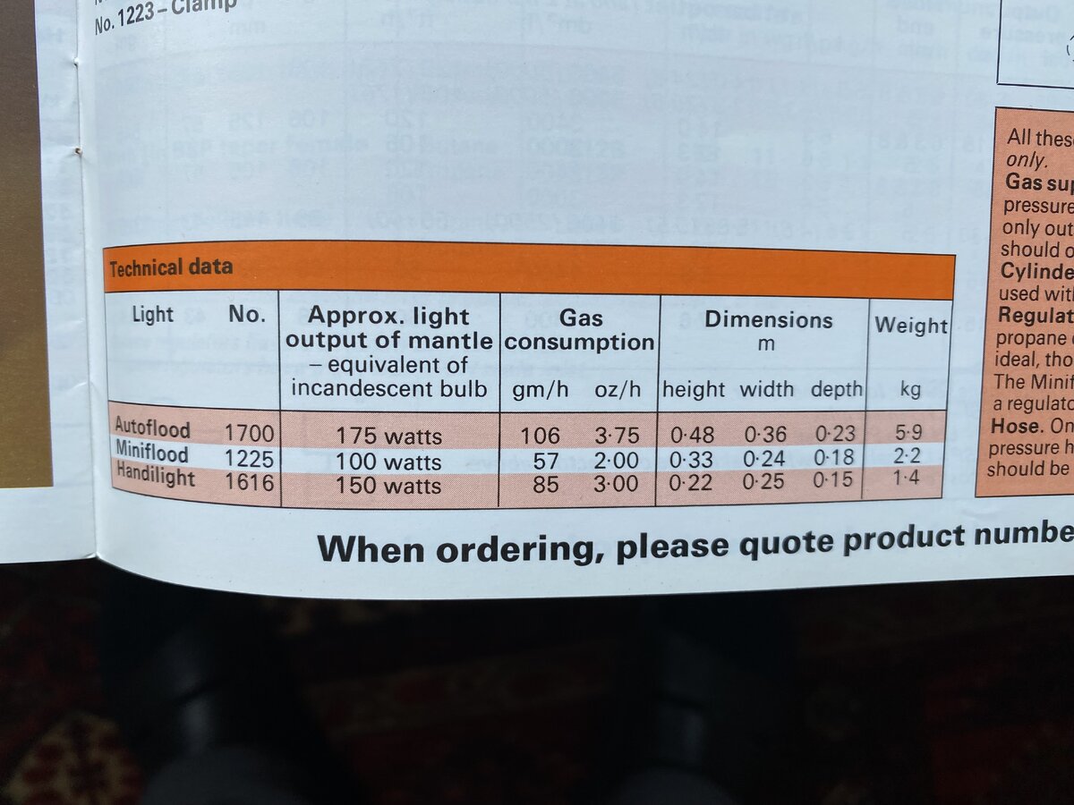

    In terms of fuel consumption, I have a catalogue from 1983 featuring the floodlamp (called ‘Autoflood’ in it because of the easy lighting feature using a piezo spark generator).
    The propane consumption for the Autoflood is given as 106 grammes per hour.
    I’m using a Calor gas cylinder containing 6 kilos of propane, so at the quoted hourly rate of consumption I could run the floodlamp for 56 hours continuously. Exchanging the empty cylinder for a full one, I pay for just the gas - £32 (6,778 JPY). I’m unable to give a comparison, but that compares very favourably with the cost of running a FL6, even more so in the case of a naptha-fuelled lamp.
