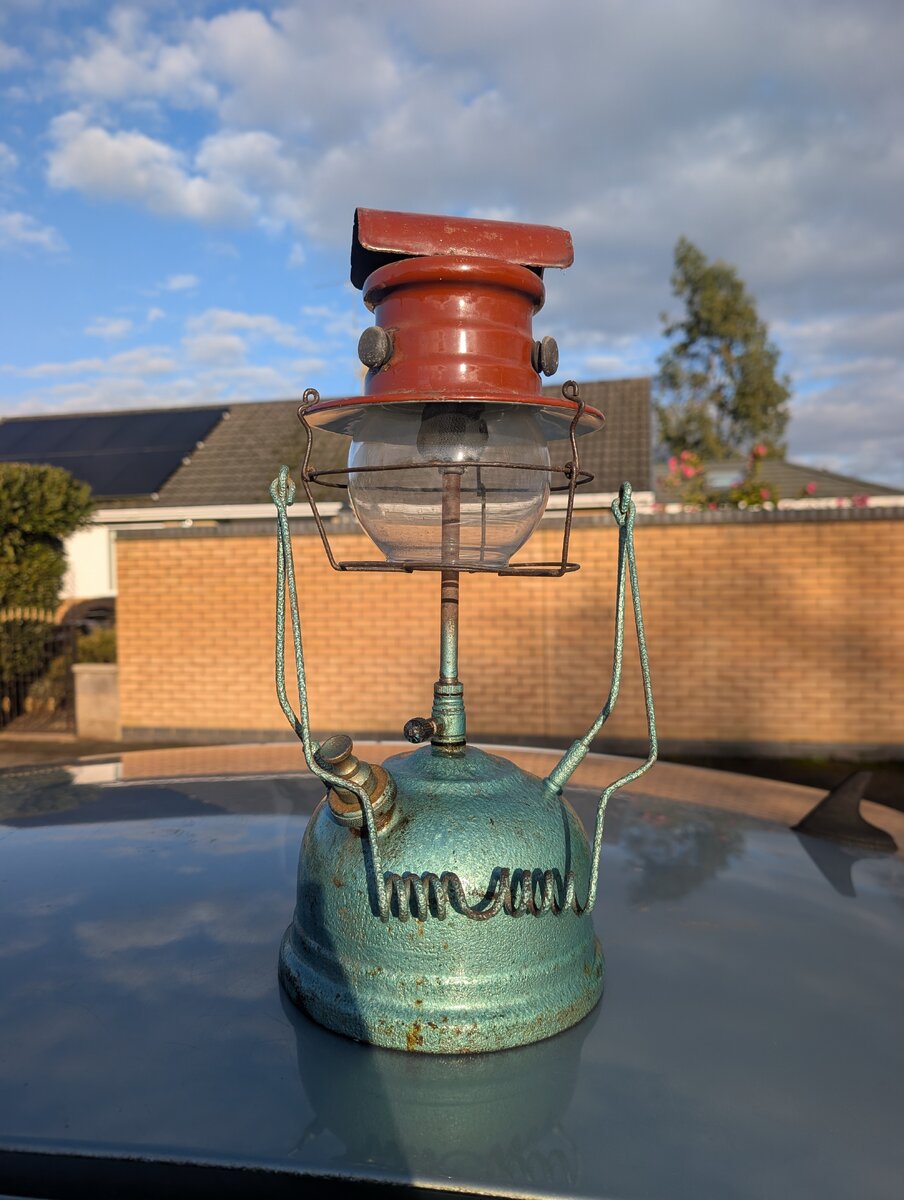

    Hi, looking to borrow on some expertise with help dating this pl53 I managed to buy today, had a Google and can't see many at all in this colour so I'm wondering if it has been sprayed by a previous owner?
    Any information at all is much appreciated

    Hi Patrick,
    looks like a steel wartime PL :thumbup:
    most likely had a coat of hammerite by a previous owner
    looks pretty good from here :-)
    regards
    pb
    edit ** they were tinned/hot dipped before painting and they usually had a decal warning about rust and to routinely empty out the fuel etc

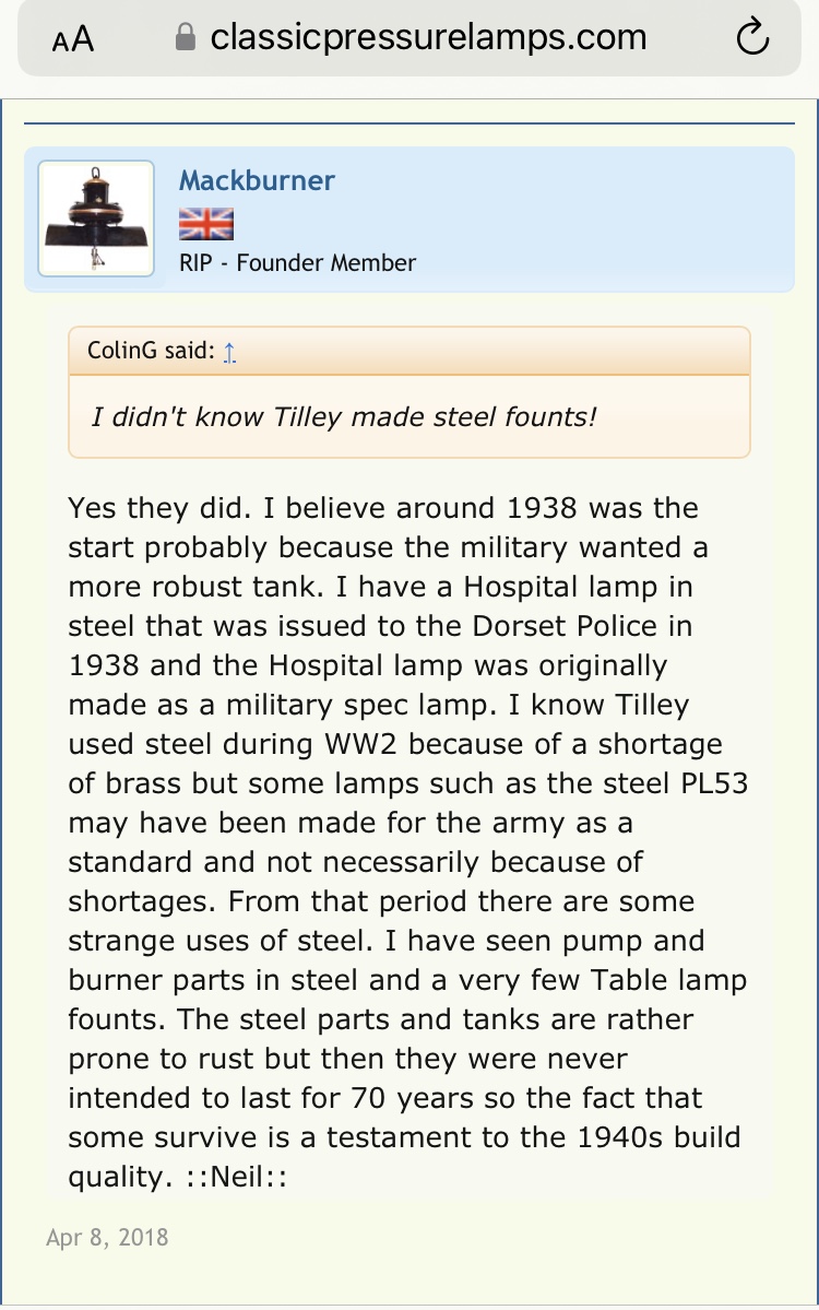

  5. podbros
    3,985
    i found this after some searching.. from 2018

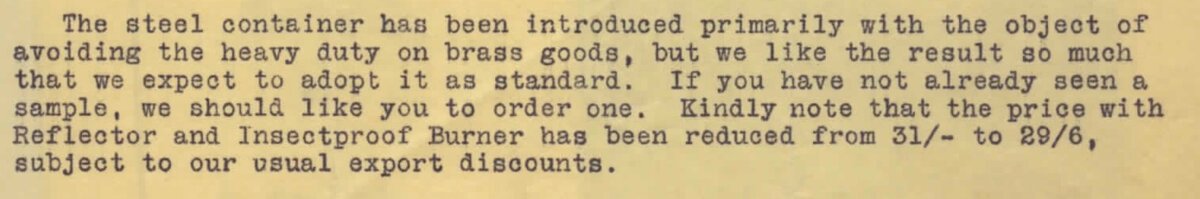

  6. Anthony
    Anthony Australia Subscriber
    May 7, 2013
    1,647
    This is from March 1935.
