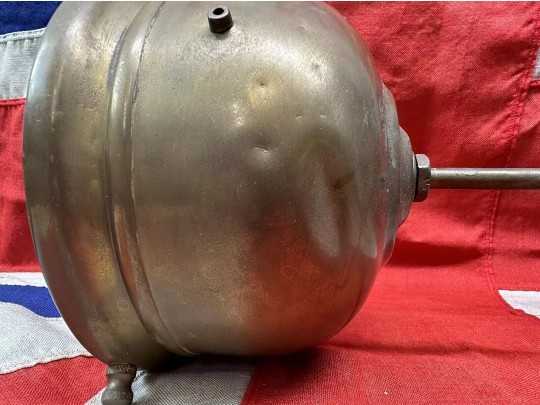

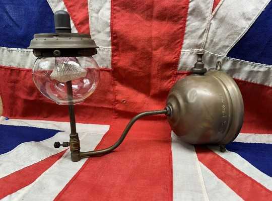

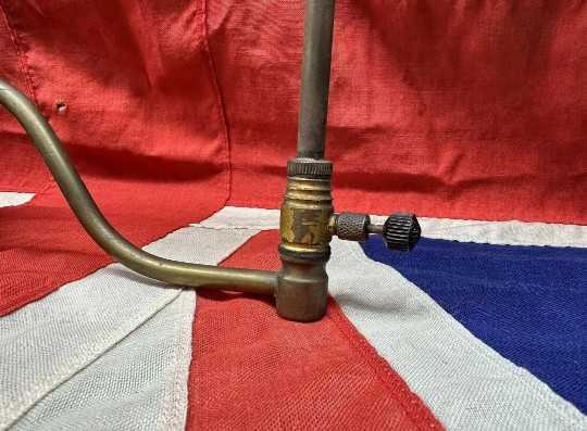

    Just bought this Tilley bracket lamp yesterday !! I will hopefully have it in a few weeks and then looking forward to getting it going !! Doing a Google search it looks like there are three possible models it could be as well, can anyone positively identify the model for me?
    IMG_COM_202503091557034700.jpg IMG_COM_202503091557035341.jpg IMG_COM_202503091557035922.jpg IMG_COM_202503091557036483.jpg IMG_COM_202503091557036974.jpg IMG_COM_202503091557037615.jpg IMG_COM_202503091557038306.jpg IMG_COM_202503091557038717.jpg IMG_COM_202503091557039188.jpg
    16,114

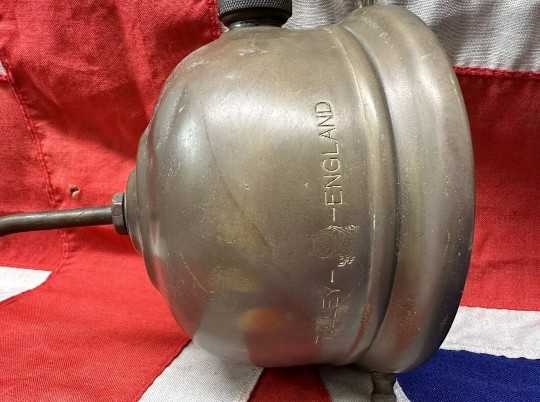

    The earliest that design can be is 1940, but in my opinion, your lamp is from 1953 to 1955, unless there is a date code stamped on the base plate of the tank.
  3. William G United States
    Jan 26, 2025
    41
    Norwich Connecticut USA
    Thank you Jeff I will have a look at the bottom of the tank when it gets here.
    Tony Press Finland Subscriber
    10,706
    It’s a WL25.
    Edit: Crossed with @JEFF JOHNSON.
    The gallery is post 1945; the tank stamping would make me agree with Jeff.

    Arrived today along with a Handi.
    Assembled her and did a little bit of checking. It pumps up, holds pressure, and passes air through the vaporizer and the tip cleaner works. Over the weekend I will clean it up a little bit and get it running. Should there be a washer of some sort in between the tank and the swan neck?
  8. podbros
    3,796
    Nice :thumbup::thumbup:
    with the swan neck off have a look in the tank where it fits.. there should be a lead washer (or the remains of one) you could check carefully with a small screwdriver
    you could make one out of some lead sheet or flashing with some wad punches
    Base camp stoves over here do have them but it’s a long way for a single washer
    edit ; you might be ok with a viton washer.. worth a go

    I will have a look this evening or Sunday. I do have some lead washers in my parts so if I do need one I'll see what I have to make something work

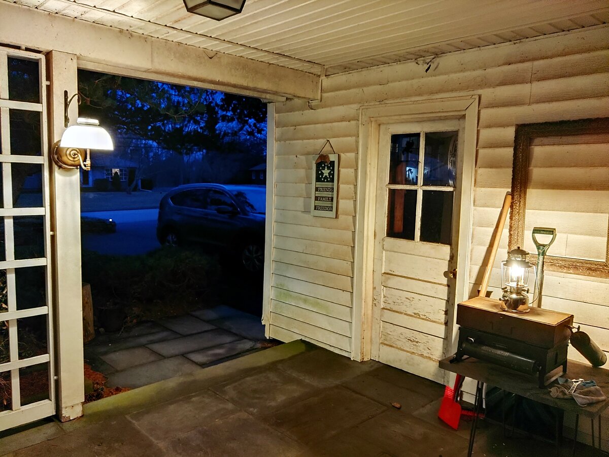

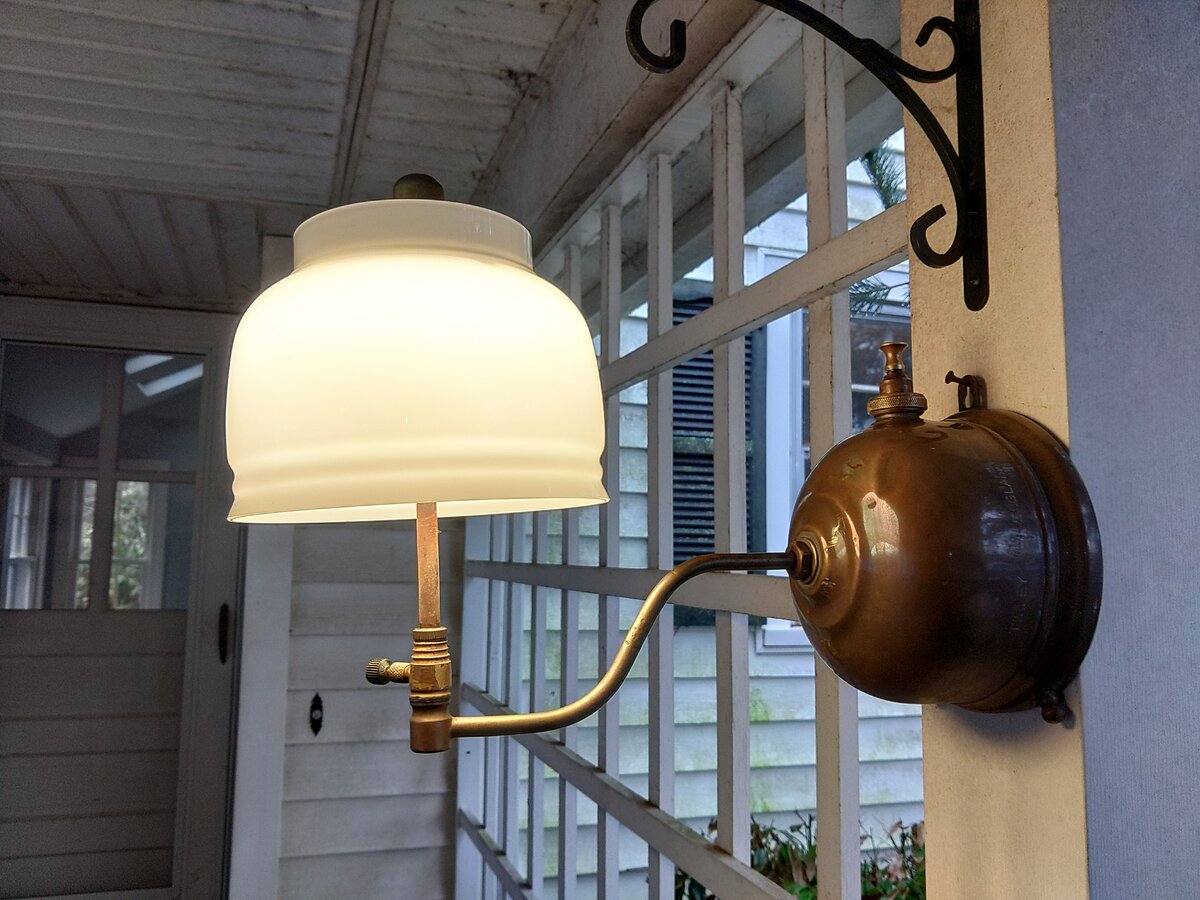

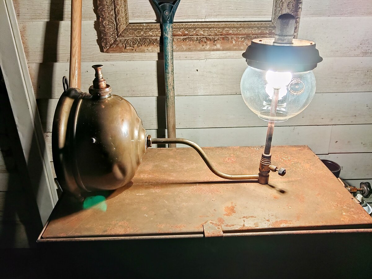

    She came to life this evening!

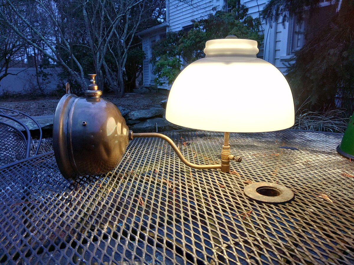

    Changed the rubber seals, I came up with a lead washer for in between the tank and gooseneck, also oiled the pump and replaced the pip in the NRV. I put the Coleman 306 shade on just for fun. I'll work on getting a couple of reproduction or original outer shades for it at a later date.

    Tony I was able to figure out what you said to me lol! I ended up ordering a proper shade for it last night as well from eBay from the UK. I also ended up ordering some more double tie mantles as I'm very low on stock also ordered some more Tilley washers.

    It's working well and did you check for a date code?
    William G
  22. William G United States
    Jan 26, 2025
    41
    Jeff I did but could not find one on the bottom of the tank.
  23. JEFF JOHNSON
    16,114
    Hello William, if I recall correctly Tilley started to use date codes sometime in 1956.

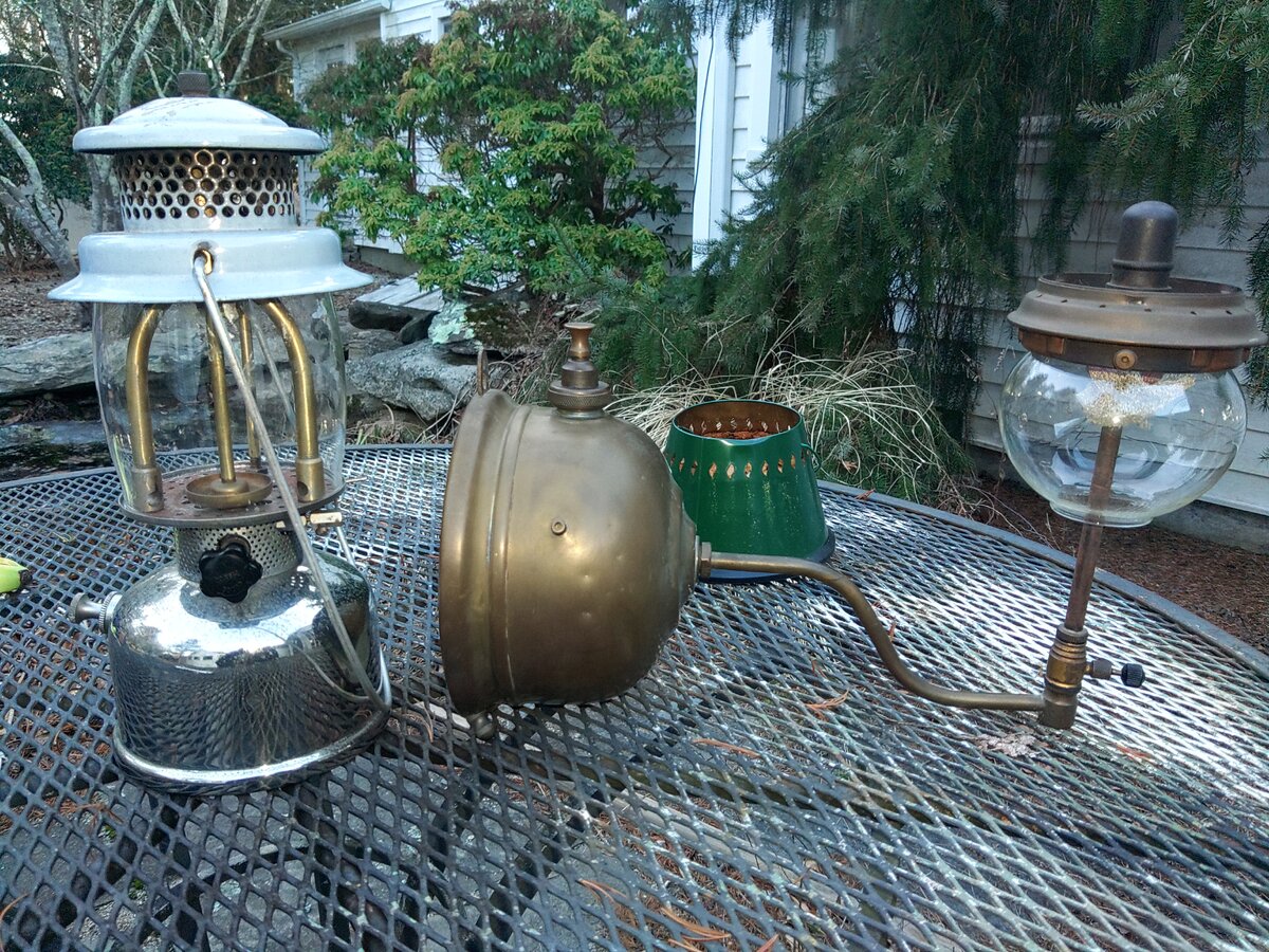

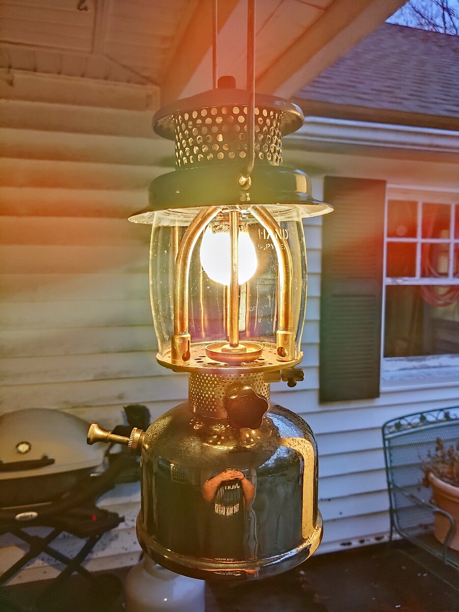

    Thanks Jeff. I'm giving it another good run now. I also this afternoon was able to put in a new fuel cap/pump washer and a new washer for the control cock shaft. I also took and fired up the Handi from Andrew!

    Thank you everybody! I bought a shade for it and I picked it up from the post office today!
