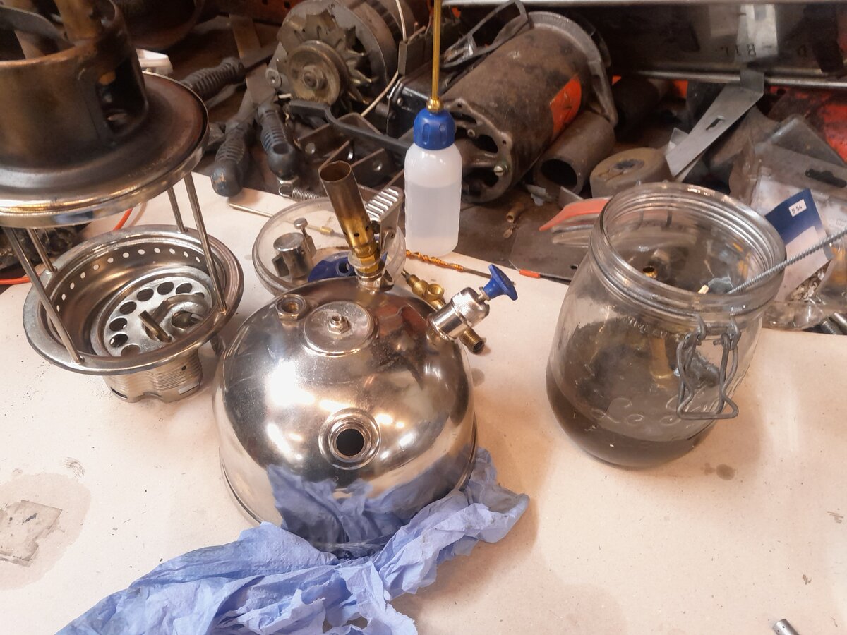

    Petromax 829.. in parts, cleaning time... Primus, waiting for cleaning...
    And just a little question, what size mantles should fit "the little Primus" -it looks like it is probably a bit smaller CP wise ?

    Hello Henrik, The Primus is a 300 cp.,(candle power) lantern so it does need an equivalent sized mantle and it best to use a bulbous style of mantle rather than the sock style of mantle, a bulbous mantle will form closer to the vapouriser / generator and therefor keep the vapouriser hotter, which means that the fuel will vapourise properly, the mantle which is shown in the photo has formed to far away from the vapouriser.

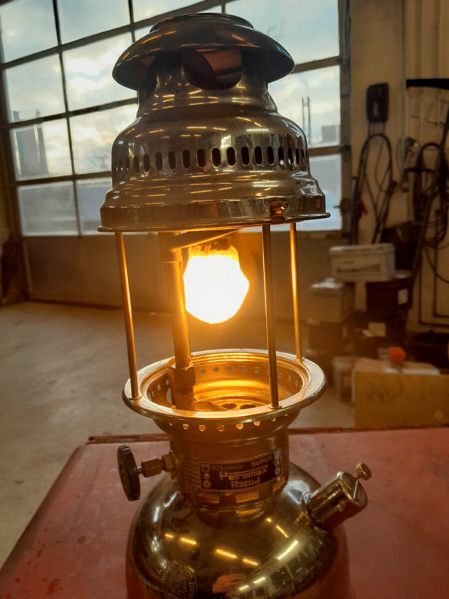

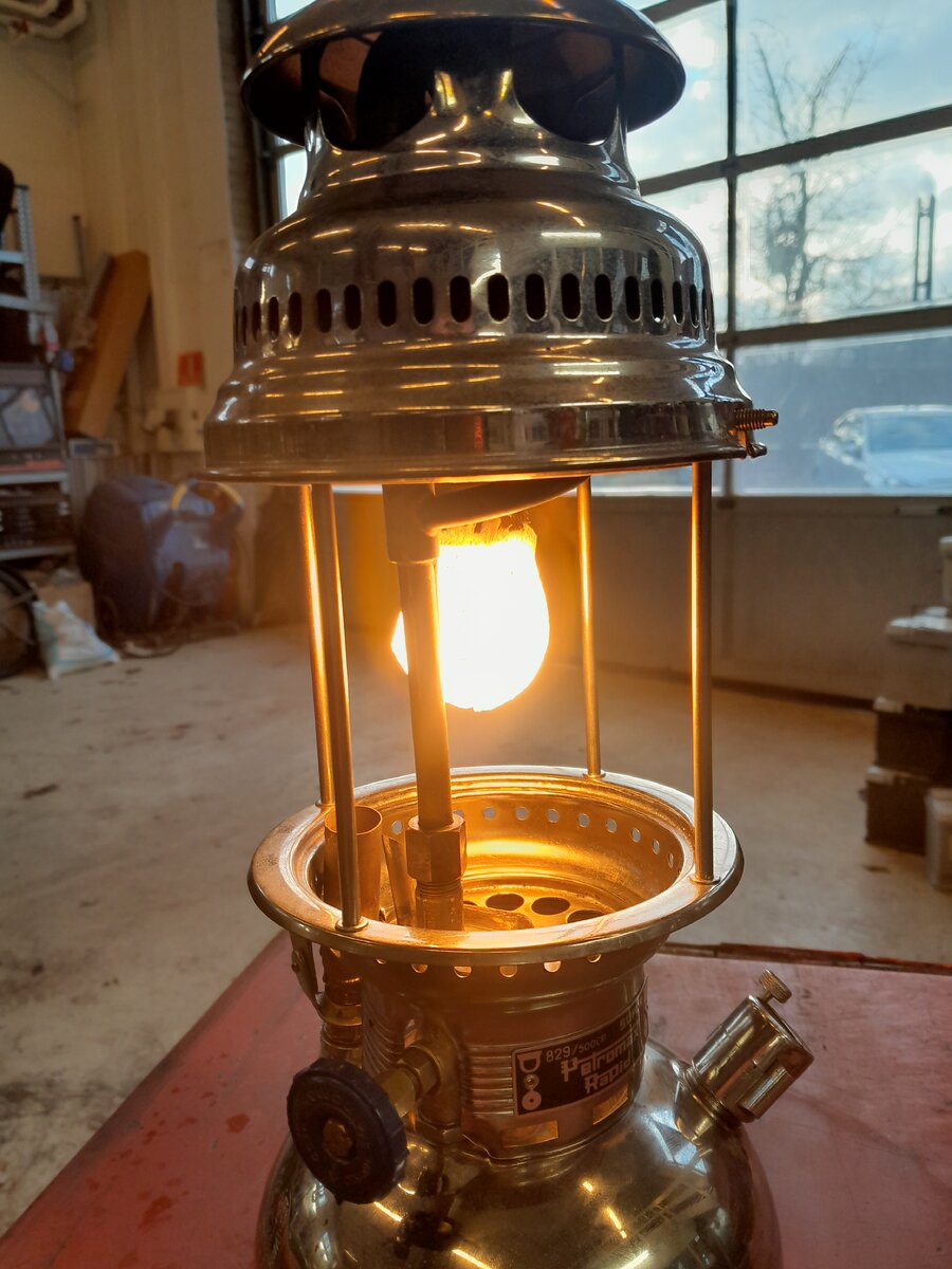

    Today's picture, "The china-max on fire".... Well, more like, with a light in it, after cleaning, burning a lot better, i think... mantle is From Fogas bulbstyle.......
    It look's like there is a bit of burn outside on pictures, but in live action, it is almost not visible, perhaps even less after a while of lighting, a bit hard to tell, it is blinding me ...... - is that normal? the way it burns... - I do know that it should blind me ;o)

    It is quite normal for a new mantle to take some time (~30 min) to settle in. If the light is blinding, then it is working correctly. :)

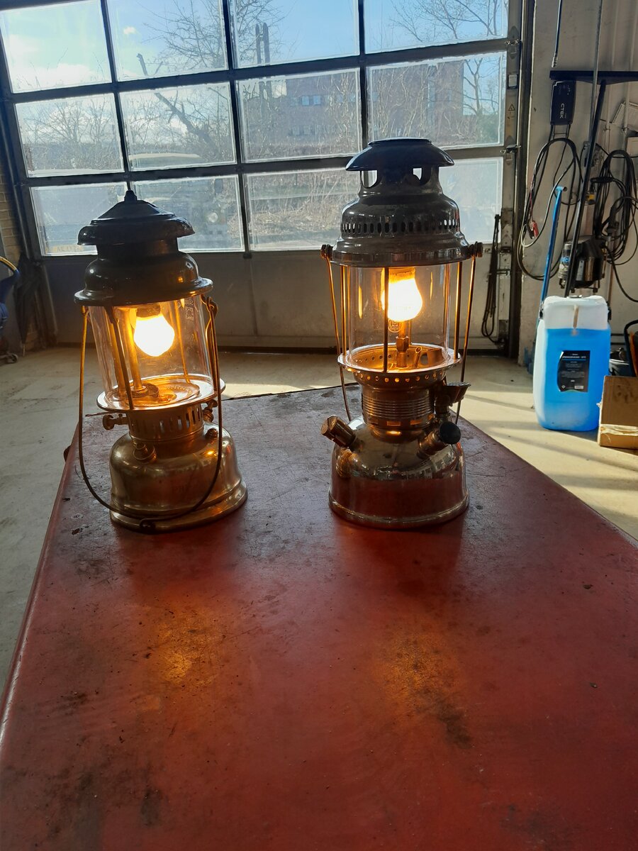

    So... Now it seams like they both are back to life, Thanks for all help given :thumbup:
    Best regards, Henrik
