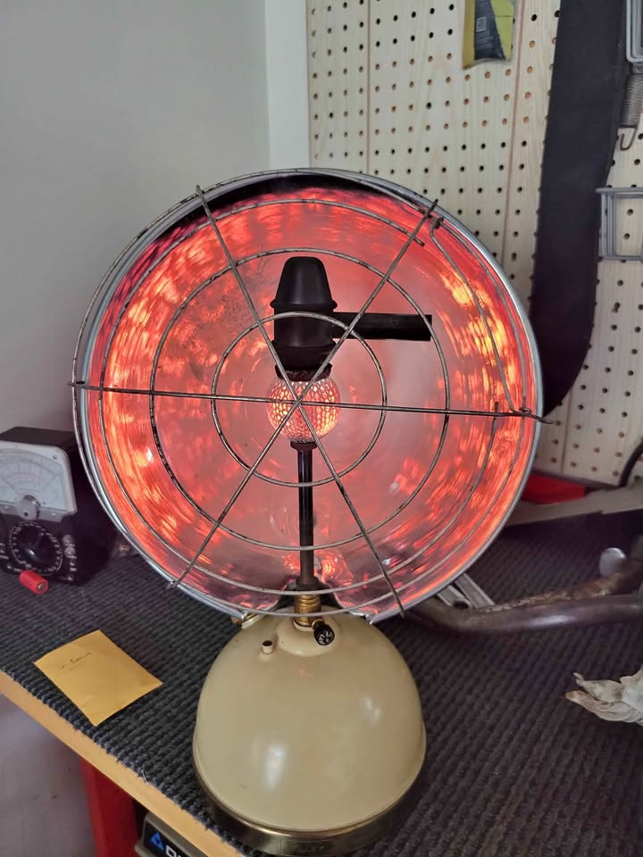

    I bought an old Tilley kerosene radiator heater. I was thinking of putting it in the cockpit and cabin of my sailboat as an additional heat source.
    My thinking is it should probably be gimbaled like an old Sea Swing Stove; I can weld or fabricate something.
    Does anyone have experience with using this type of heater on a boat?
    Your thoughts.

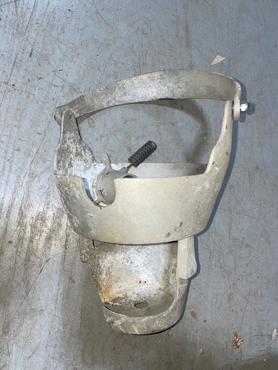

    Crikey, there’s always something new to learn about Tilleys, that’s certainly a new one on me. Does anyone have this gimbal?
  4. esarratt
    Mar 3, 2015
    56
    North Carolina, USA
    Yep. I learn something every time I post.
    I'm going to start hunting for a gimbal. Thanks!
  5. Anthony
    Anthony Australia Subscriber
    May 7, 2013
    1,618
    They did a gimbal well before the CS56.
    This has the SY.
    There is another one in an ad on page 79 of the Tilley book.
