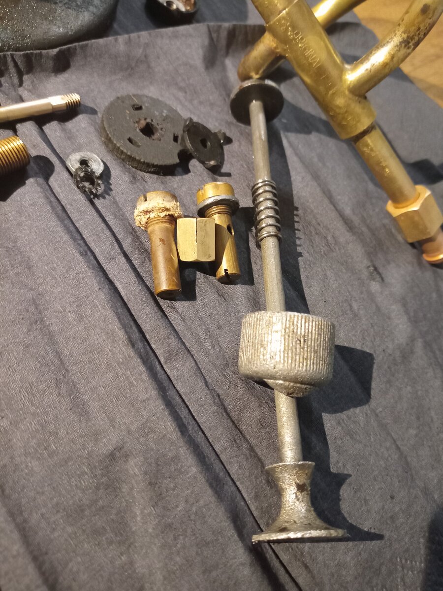

    Dears,

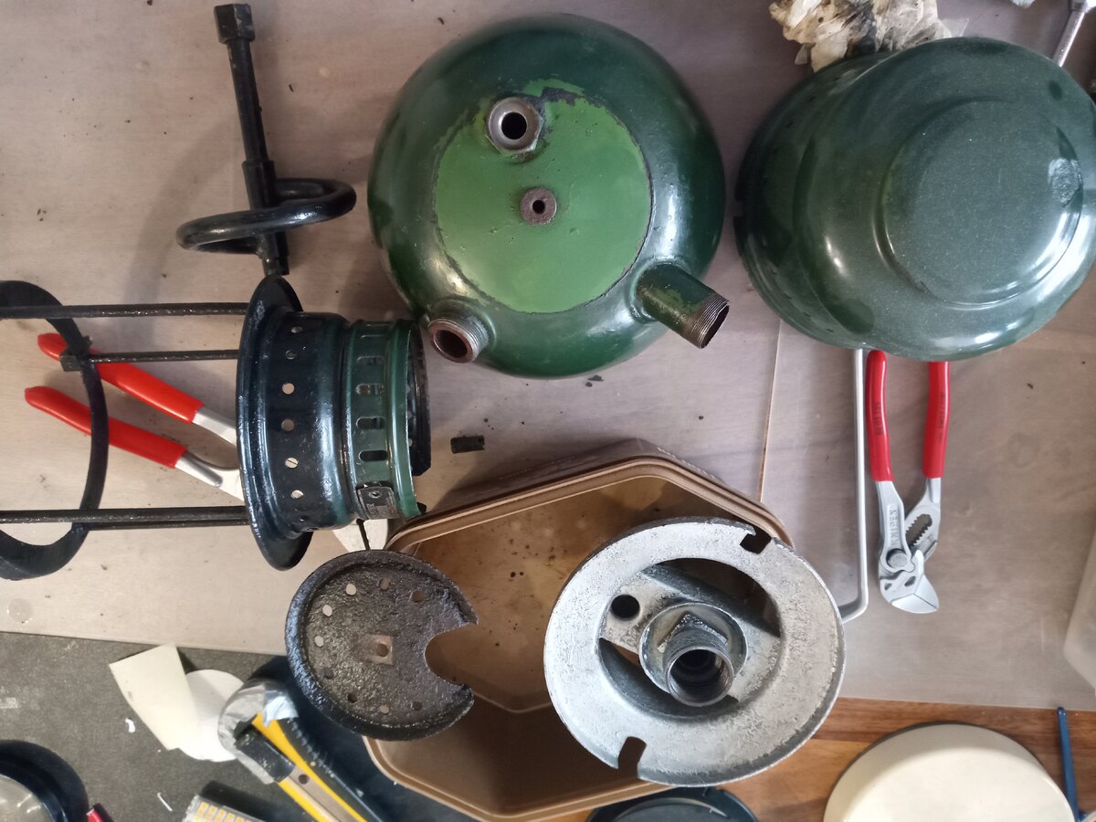

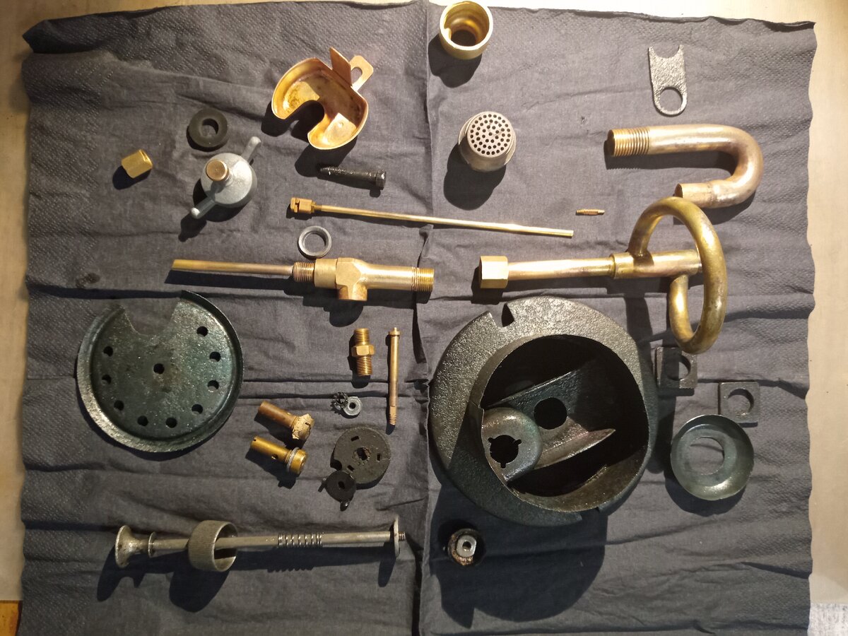

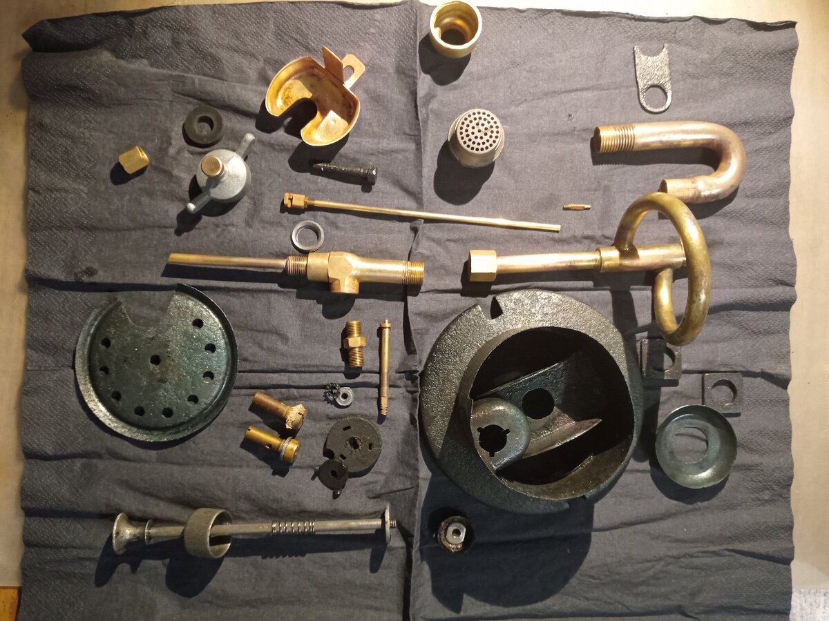

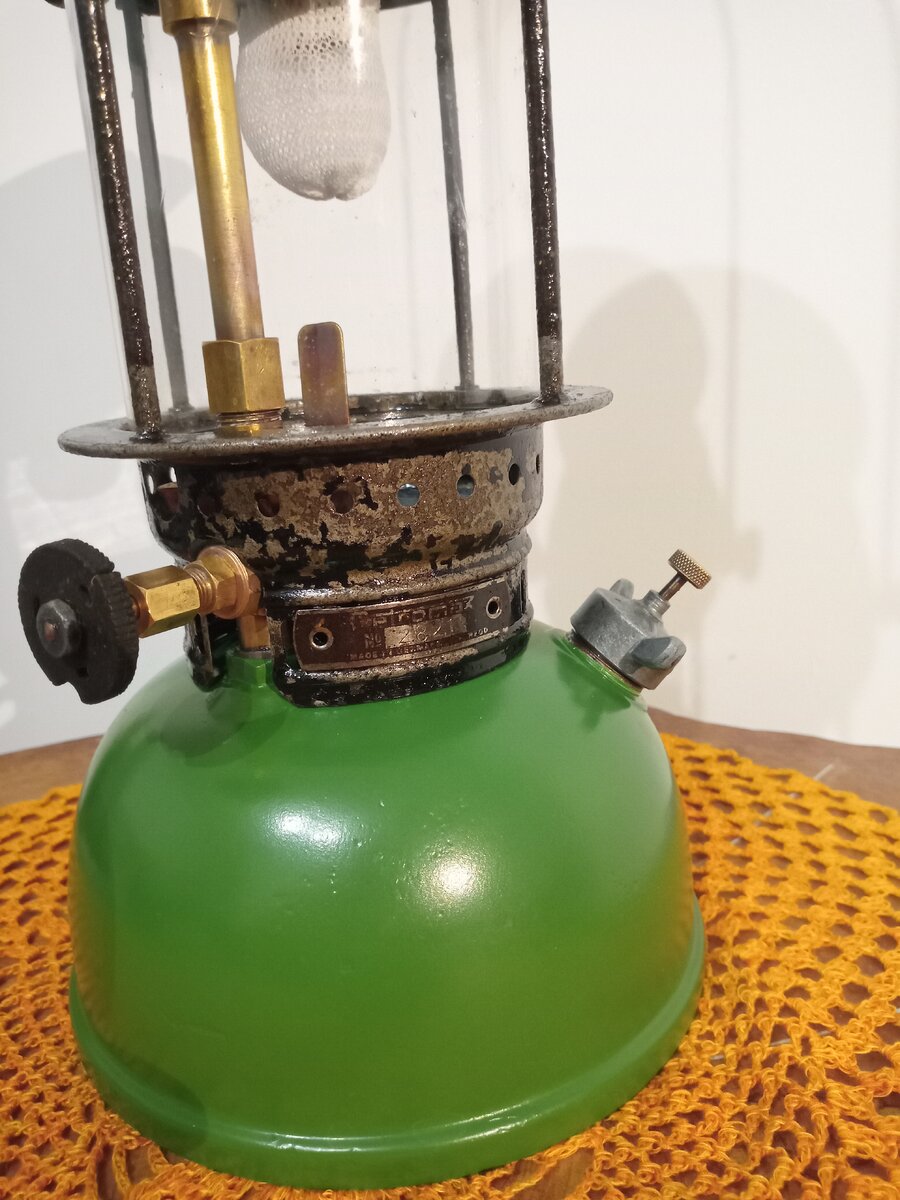

    I am pretty glad to finish fettling and be able to post that Petromax 2821. Someone “prepared” that lamp for sell by spray painting it all over including all dirt, rubbish and all sort of crap painted/glued to the lamp. But 2821 is not a common lamp, made during WWII when brass was limited and all most part are steel, so it was worth the effort.
    Fettling story:
    1. It was easy to get rid of new paint using Acetone.

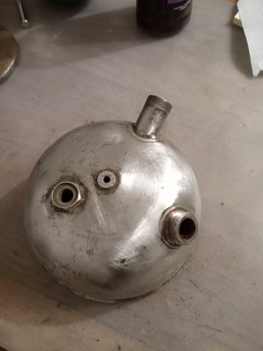

    2. Old WWII paint was practically immune to Acetone, so I had to use some steel brush and drill to clean the tank.
    3. Tank was almost free of rust inside, but I derusted it inside and outside nonetheless. I made a rust protection using APP “R STOP” and additionally dedicated epoxy resign from inside.
    4. I painted the tank but I left the frame just derusted (Evaporust was used instead od citric acid to protect the label with model number), cleaned and covered with “R STOP” for rust protection. Frame looks old and I like it.
    5. Steel parts other than tank, frame and pump were derusted in citric acid solution and heat&quenched several times in boiled linseed oil. Pump parts were derusted and treated with “R STOP”.
    6. NRV pip (made of natural cork) and gasket (made of leather) were replaced with my homemade Viton and lead seals.
    7. Glass is very thin Jena Suprax so it has to be old.
    8. I noted that characteristic for some WWII Petromax lamps slot cut in the nut with graphite packing.

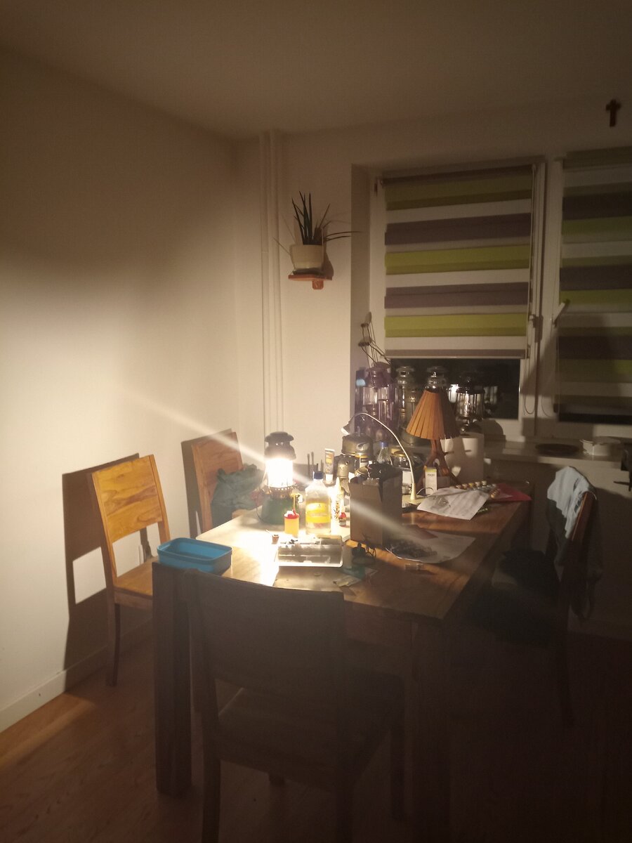

    Lamp has new set of 150CP jet and needle. 200-300CP Luxor mantle. Somehow with that set of parts this is surprisingly bright lamp.
    Enjoy and all the best,
    Piotrek

  2. Camp numao Japan
    Jan 13, 2024
    223
    Japan
    A perfect restoration.
    Congratulations on the completion!
    Was this lantern used by the military or for home use?

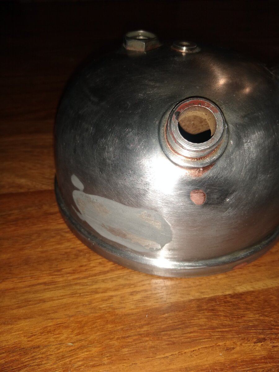

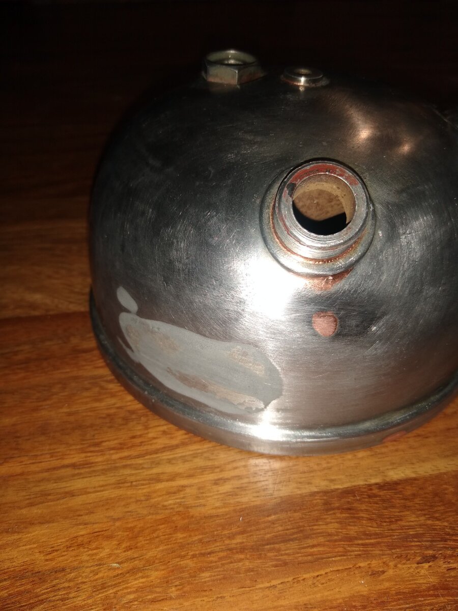

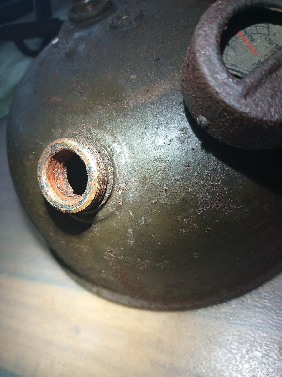

    OK @MYN so I made some effort :lol:

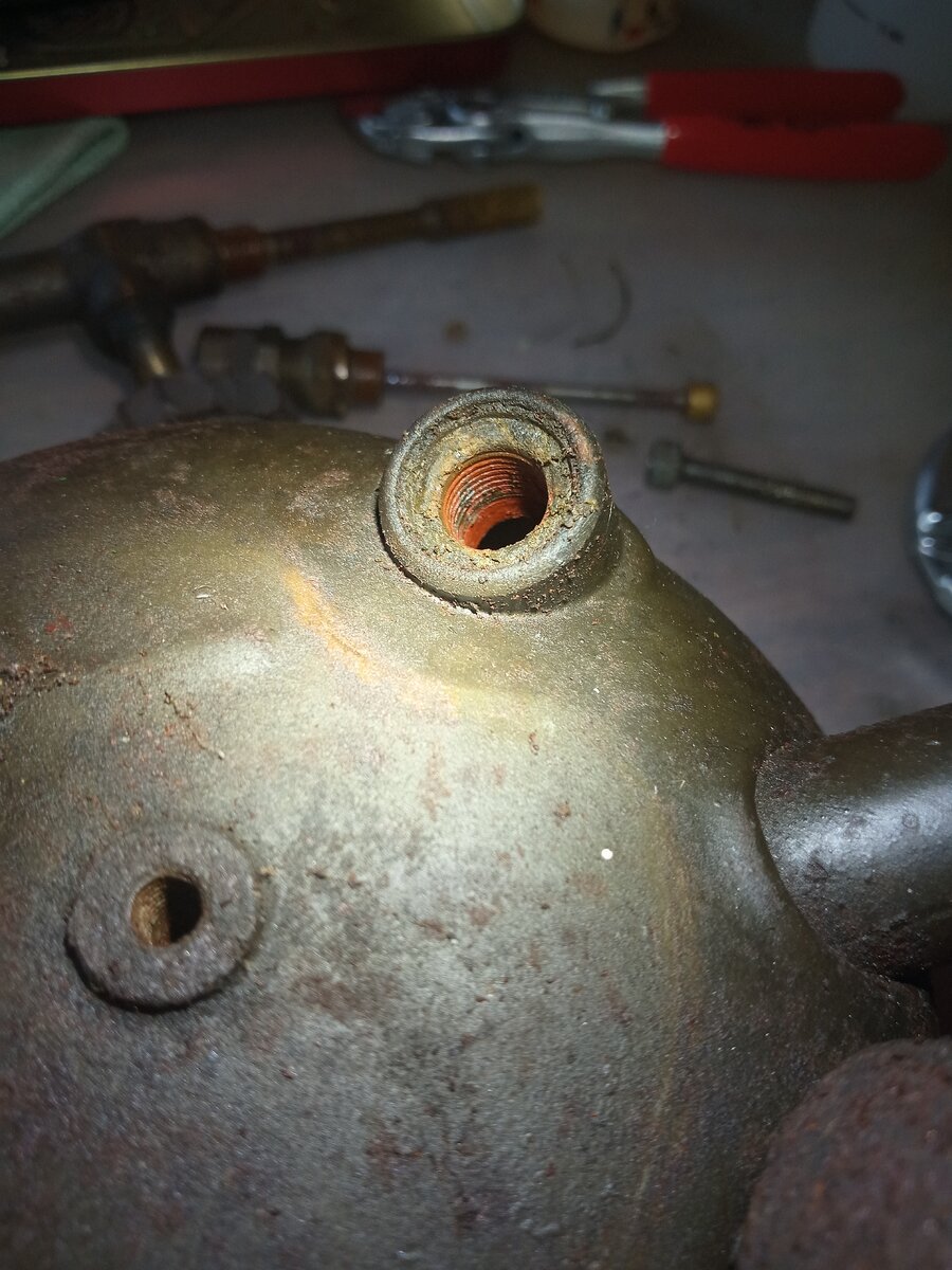

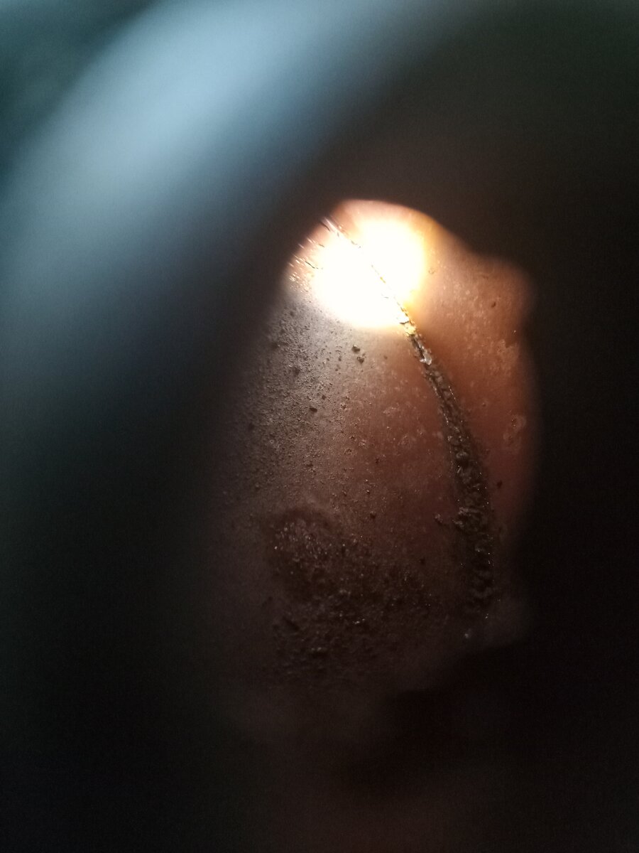

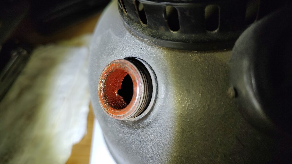

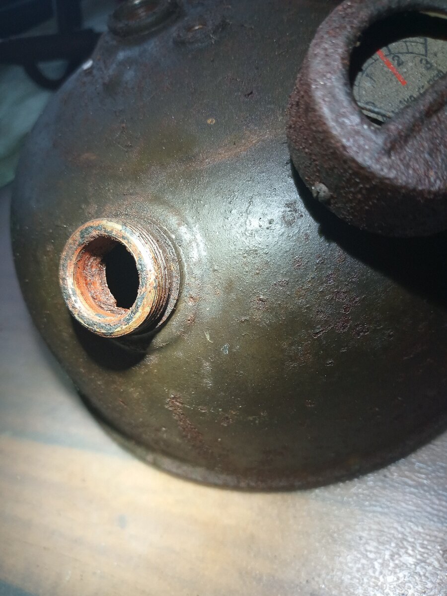

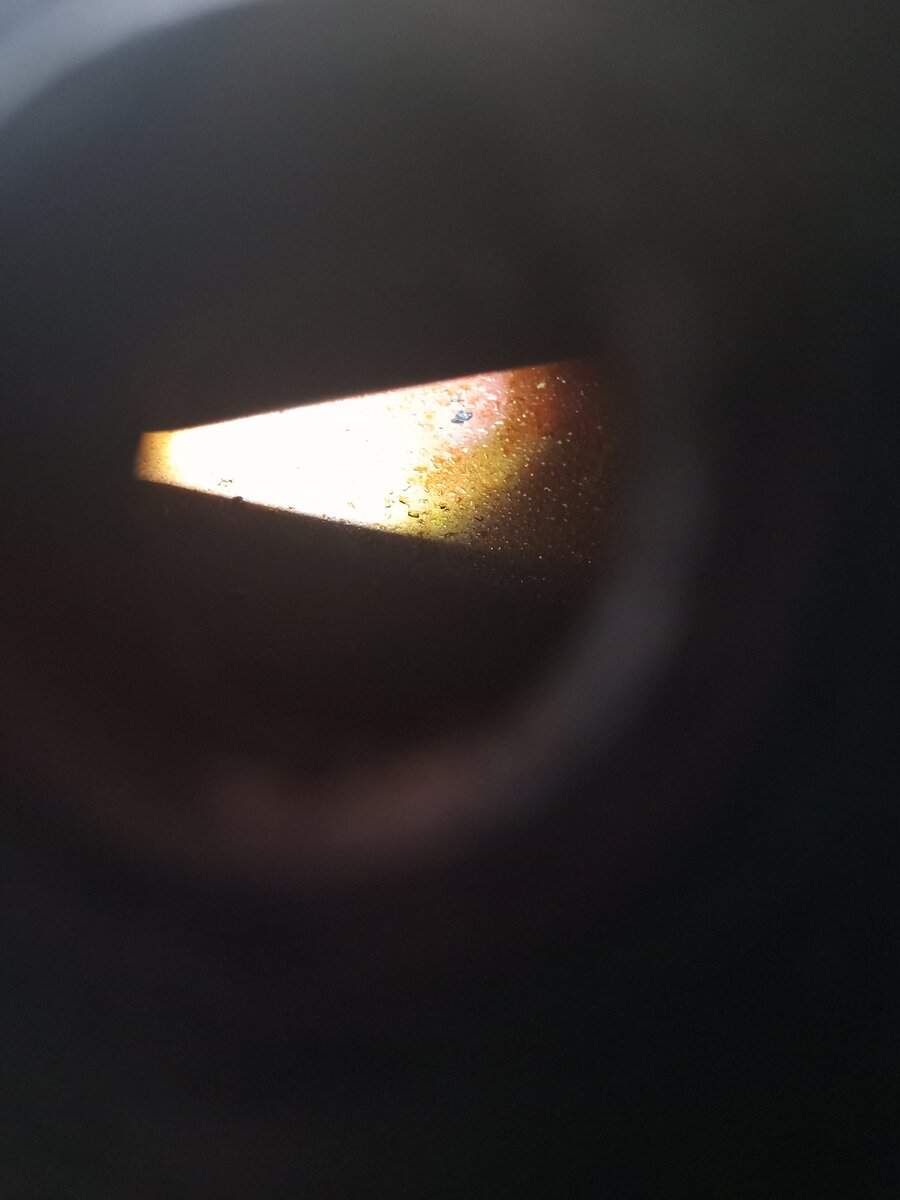

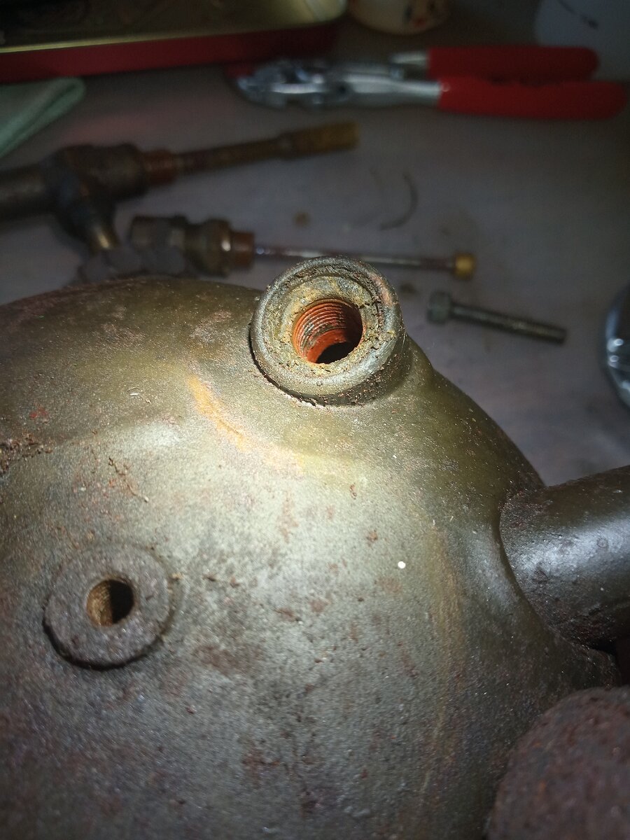

    Look at the fuel inlet in pics below. There are clear remains of some reddish paint visible:
    Full lamp posted here:
    Petromax 2821
    and
    from the post
    WW2 PETROMAX 2827B
    This is not rust, this is old reddish paint.
    Now you will notice that inside of that 2827B does not look like painted. I belive that this is due to poor quality pictures (colors) made inside. It is really hard to get a true color on pictures made inside.
    Then I just dismantled some rusty 2827 that I keep for parts and made more pictures of inlets and inside:
    Pictures were made using my mobile and are poor quality, but you notice reddish color. I reality, with bare eye the color is much more intense.
    A friend of mine who has >50 of PX 2827 has the same opinion.
    Additionally I do not belive that Petromax would not take care about rust protection inside their steel tanks. They still did a quality lamps with all parts painted, enamelled, nickel plated etc. Quality - Made in Germany :content:
    But I may be wrong and this is just my personal point of view and I can change my mind in the future ;)

    I can confirm that there is effective rust protection in the steel Petromax tanks, I guess something like red lead, certainly not the healthiest option from today's perspective.

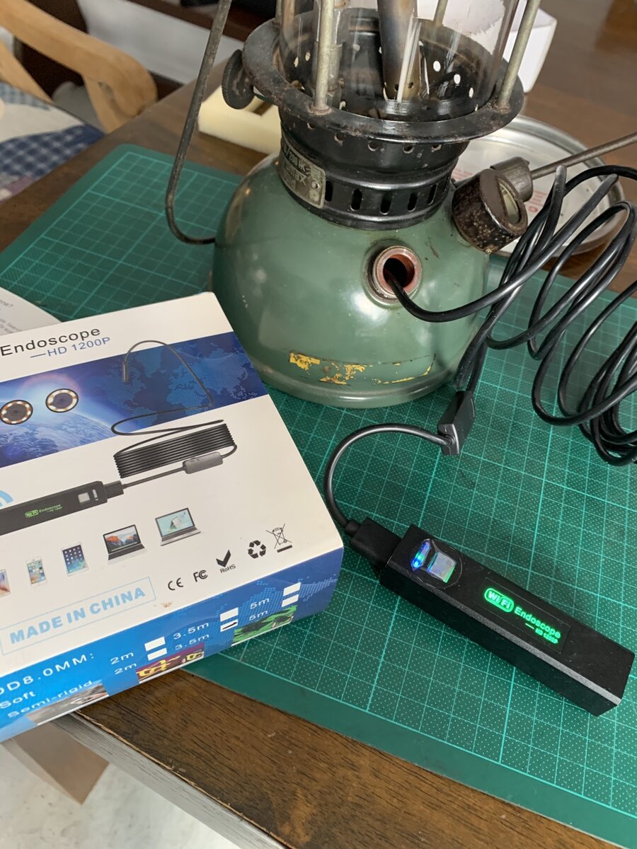

  16. Reinhard
    Reinhard Germany Subscriber
    Oct 15, 2018
    987
    @Piotrek
    Thank you for the nice presentation and discussion stimulus :thumbup::thumbup:
    I also have a Petromax 2821
    It has exactly the same components as Piotrek's lamp .
    The green color is also the same as the rest of Piotrek's lamp on the top of the tank.
    The tank is coated inside with red anti-rust paint.
    The glass is labeled Baby Petromax.Unfortunately , it broke during cleaning.
    The material of the carburetor loop is made of brass and has a diameter 1mm larger than was usual for Petromax lanterns before and after the Second World War.
    My Petromax 2821 is stamped 143 on the bottom of the tank in almost faded blue ink , which clearly indicates January 1943 to me.
    I bought the Petromax 2821 in Austria in 2014.
