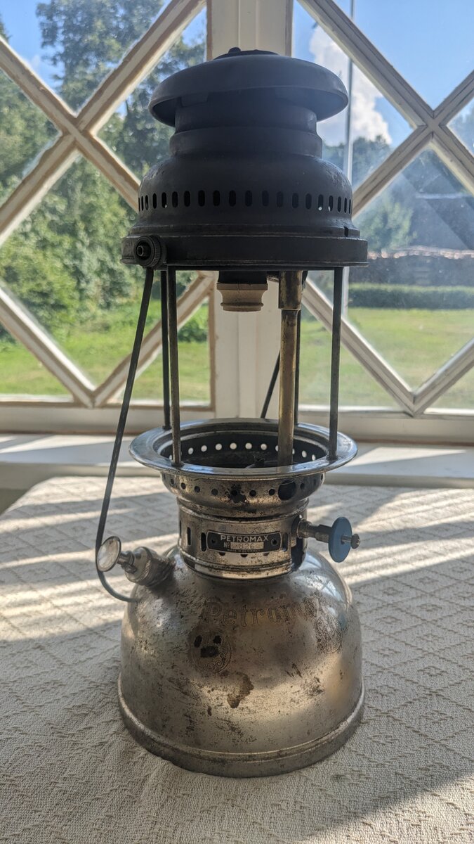

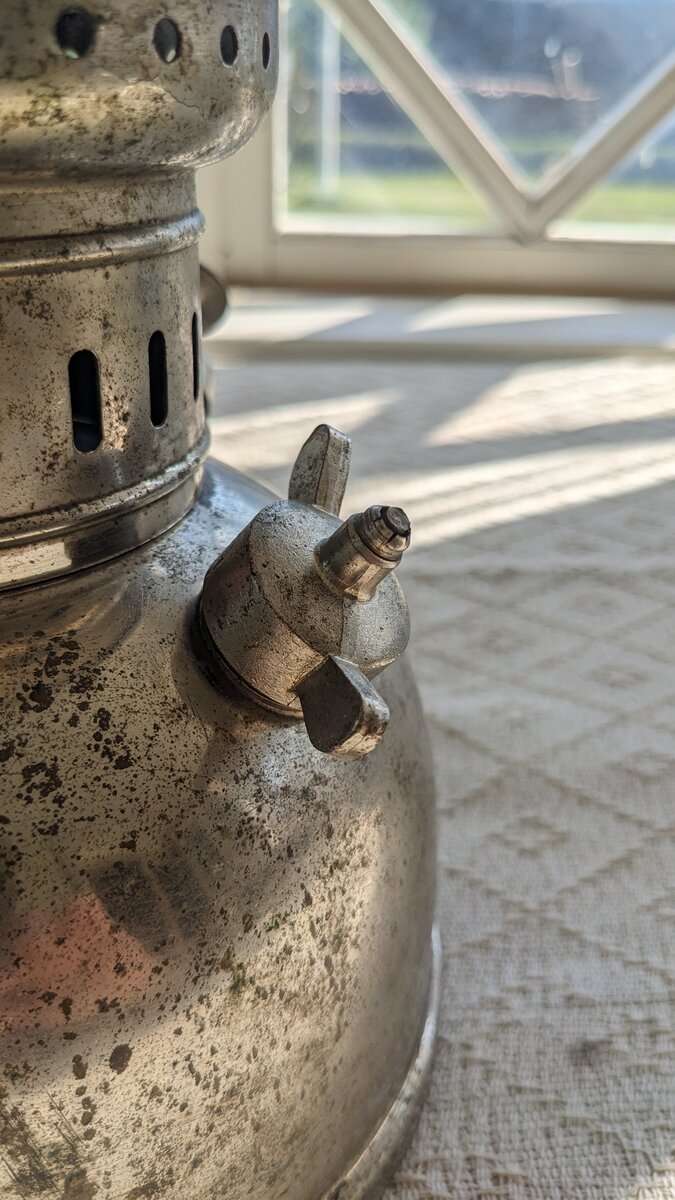

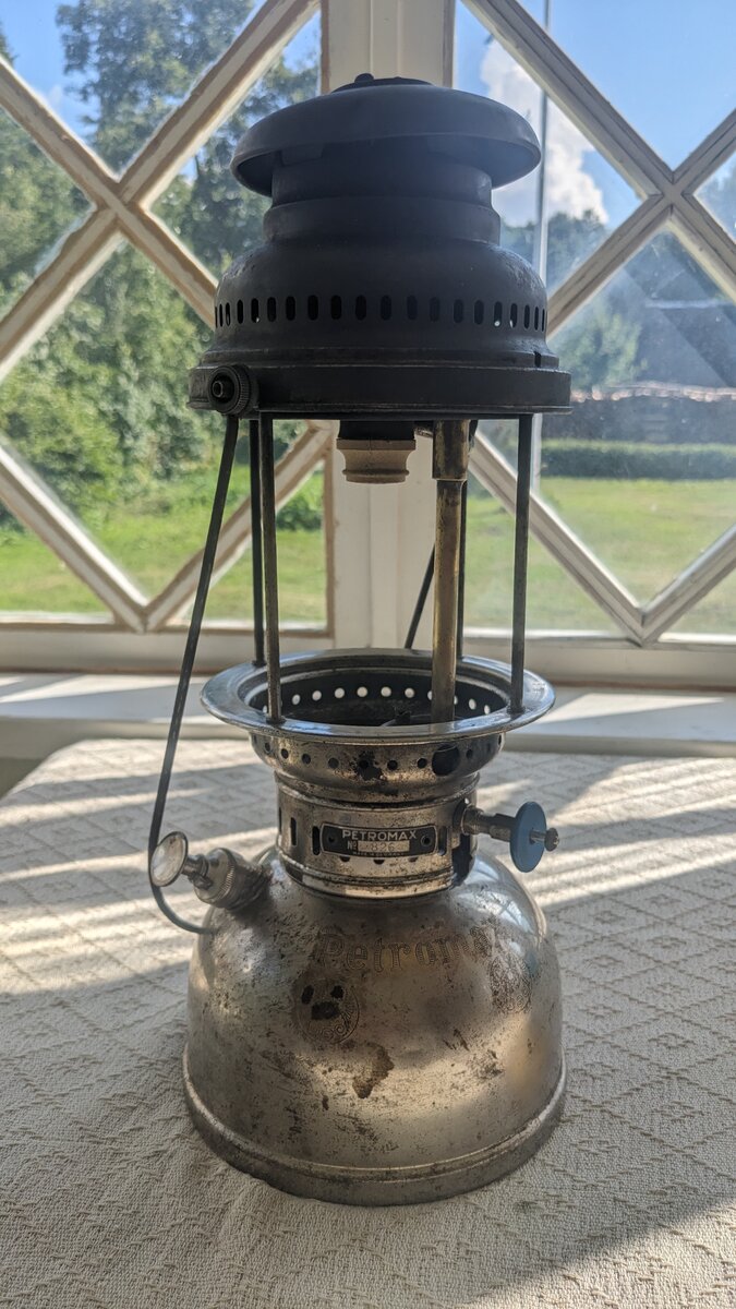

    I'm looking for some help with a Petromax 826.
    I looked through the reference gallery but did not find a similar one like we have. Please see the pictures of the on- off knob.
    I am interested to get the lamp running since it is a heirloom piece for my wife. Also it would be handy for the occasional power outages on our homestead. :)
    Background:

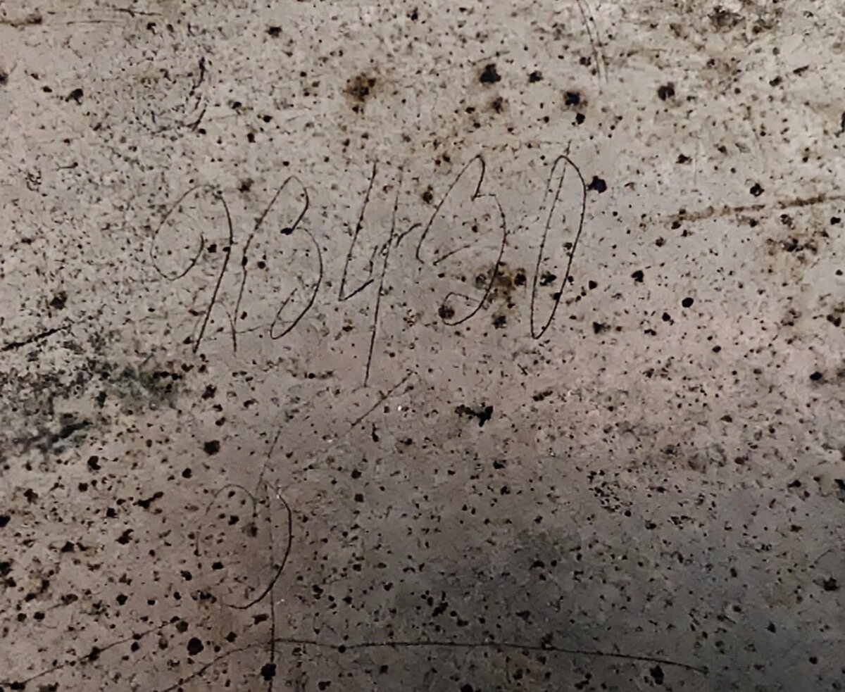

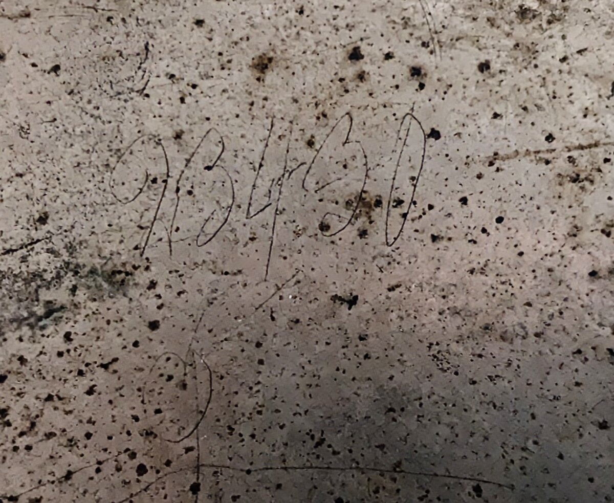

    My wife found her great grandfather's Petromax 826 lamp from the attic. We dated it to 1930 according to the numbers which were scribed under the pressure tank.

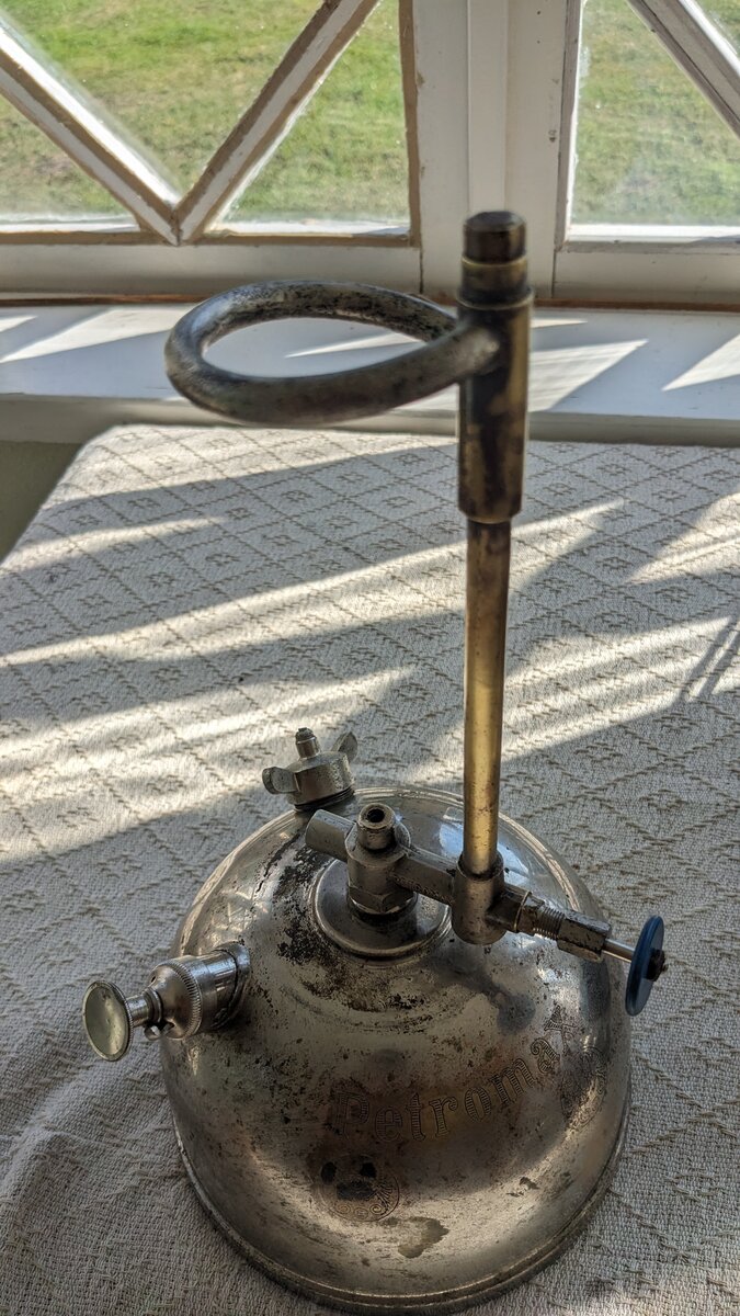

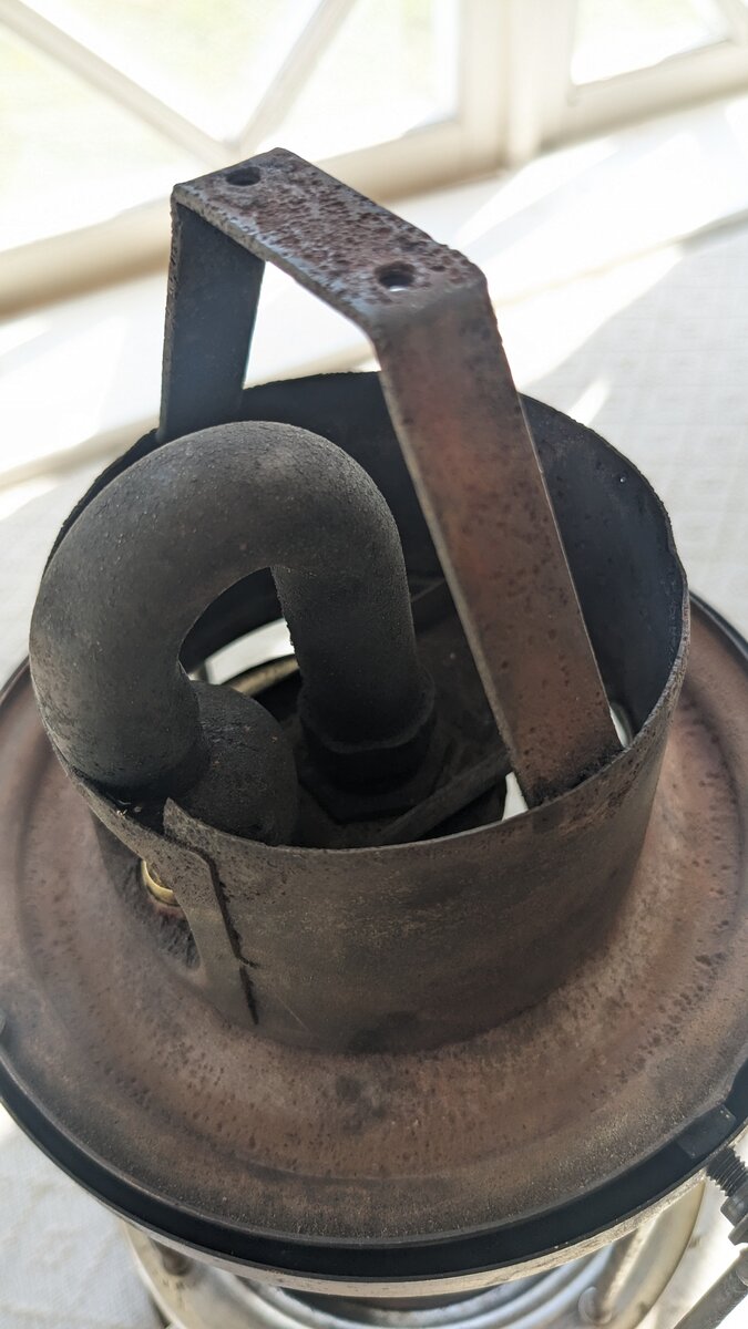

    This is my first contact with a pressurized lamp but I tried to learn a little bit about them and researched Petromax's models. What I could point out is that the lamp's hood and cover piece do not have any markings and the mixing tube is not removable. Also the whole carburetor/ generator is basically one- piece. Everything is soldered together and the upper part with the Preston loop can not be removed.

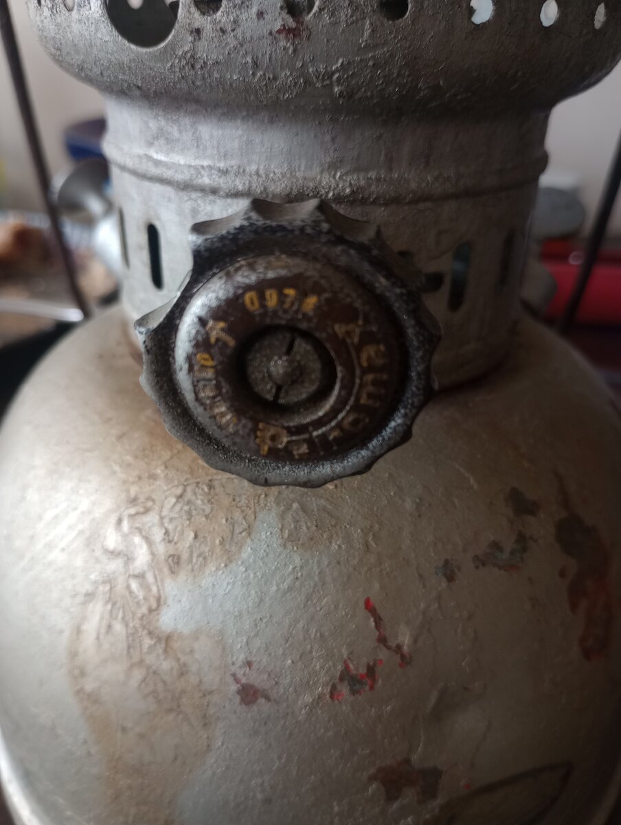

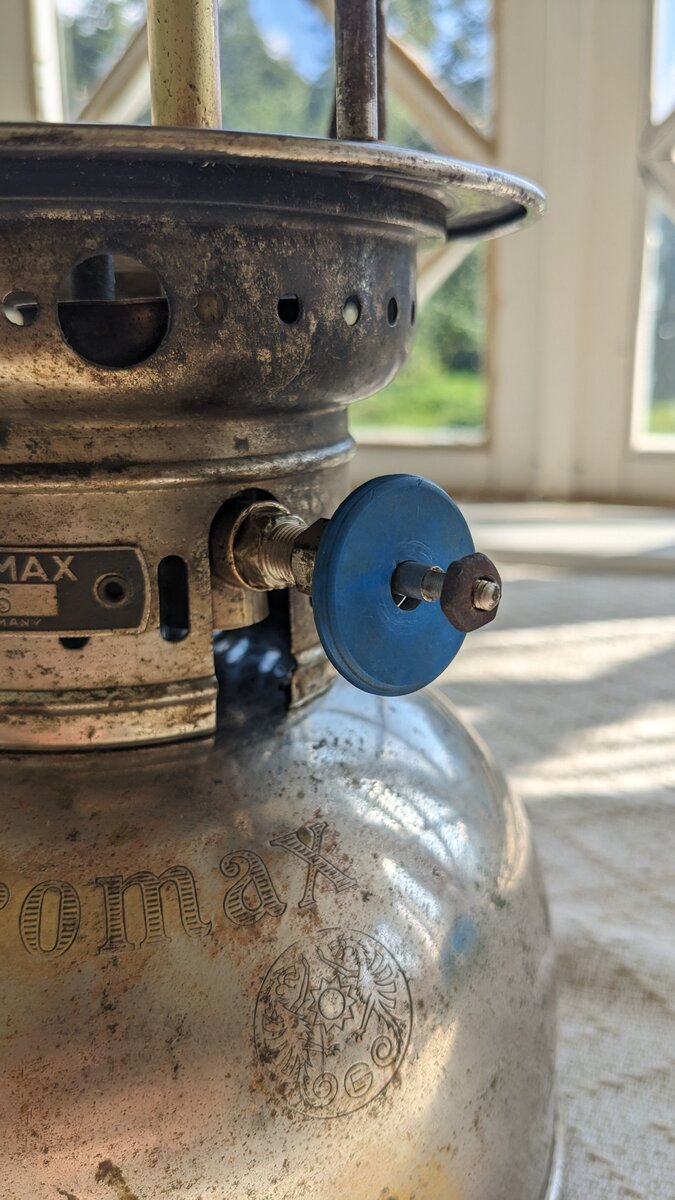

    What is really puzzling us is the on- off knob. Is it original or has someone simply replaced it with a random button? If it is original then I would be very interested in trying to reproduce the center part for it. I would needs some measurements for it in this case.
    Unfortunately the pressure release knob was sheared off from the filler cap.

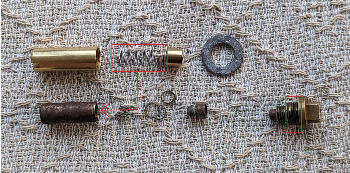

    I made a special too to remove the pump valve. The spring inside the valve was corroded and broke. The cork gasket was dead.

  3. MYN
    3,859
    Welcome @Homesteader
    Congratulations for finding the nice lantern. The original cleaning needle control knob/wheel of those early Petromax would likely be made of phenolic resin-fibre material.
    The classic bakelite blue knobs were introduce after WWII.
    The original from the 1930s might look like this:-
    or this:-
    The classic blue or brown knobs from post WWII look like this:-
    16,412
  5. Homesteader Estonia
    Aug 5, 2024
    4
    Estonia
    Hello,
    Thank you all for the kind welcoming!
    @podbros Yes, they offered the post- war filler cap with a knurled knob. I think I can start with it at first and see if I can even get the lamp running again. Perhaps in the future I am able to source the original part.
    @MYN I managed to find the same examples with the help of the reference gallery. The lamp can be considered quite rare in my location. This would make it quite difficult to source the pre- war parts. Perhaps I should start off by ordering the classic dark blue knob.
    I am still a bit confused regarding the pump valves.
    Am I right that the thread on my lamp's pump valve cap which connects the assembly to the pressure tank does not match with the newer one which is offered by base-camp.co.uk? I highlighted the thread it with red in the picture.
    So this means that I can not fit the newer pump valve to the pressure tank which only leaves me the option to try and use the newer spring on the older valve body and make a new cork gasket?
  6. Reinhard
    Reinhard Germany Subscriber
    Oct 15, 2018
    1,053
    The upper part is a carburettor foot valve #196 and the lower part is a pump valve #10.
    Please do not mix them up.

    3,859
    For the pump non-return valve(NRV), you might want to re-check if those from the newer Petromax or clones would fit into the 1930 Petromax pump.
    Many parts from the genuine Petromax 826 and clones are interchangeable but not all. I can't be sure on the 1930 Px826 NRV but it is highly likely that you can use the newer NRVs.

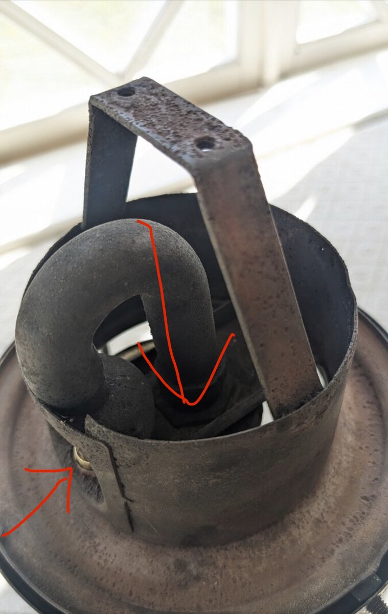

    It has been a while from the last update. The lamp is complete and now even has a sister.
    I obtained another pre-war Petromax 826. It is a newer model with a removable vaporizer. However, the J- tube is attached the same way as my 1930's model.
    This brings me to my next question. How do you adjust the gap between J- tube and nozzle with these old lamps? I have not dared to brake anything loose yet but seems like I need to adjust the air gap.
  11. Matti Kucer
    Matti Kucer Sweden Subscriber
    Mar 4, 2018
    415
    Sweden
    Hi!
    How does it look here at the marked areas in the picture?
    Regards Matti
